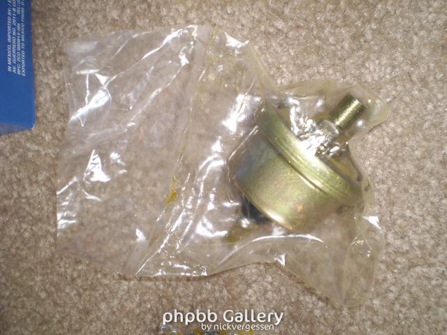

Postby RusTy Max » Wed Apr 22, 2009 5:14 pm
I finally got one from Carquest... Since it was so hard to find one (Everyone is on backorder)
Part Number: MD 092660

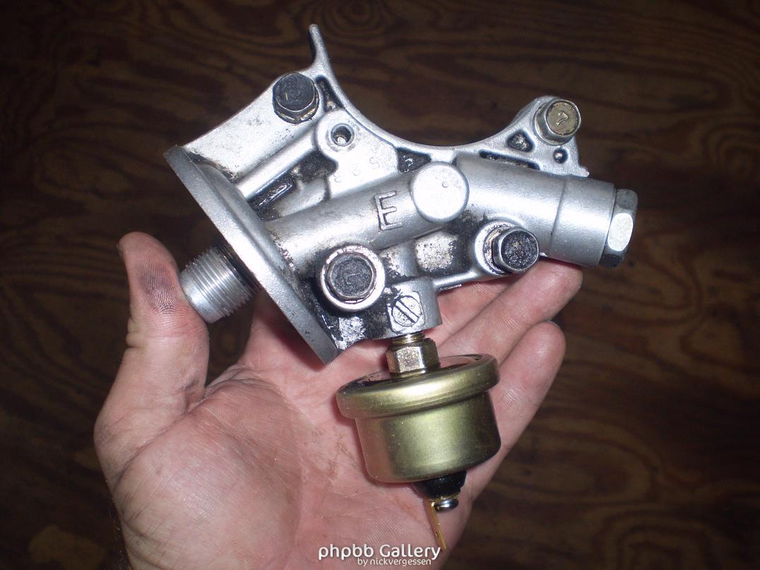

Postby GotToGo » Mon Jan 03, 2011 4:42 pm
Can someone tell me where this unit is located on a 1988 2.0?

Postby 4doorciv » Mon Jan 03, 2011 5:03 pm
That particular unit is actually your oil filter housing. The sending unit rusty is talking about is on the bottom of the oil filter housing. The housing is directly under your alternator. Your welcome. :)

Postby 4doorciv » Mon Jan 03, 2011 5:06 pm
Also for reference, some of our trucks had sending units and the others had the switch. Didn't have both. Some people switch out their cluster with one with the oil pressure gauge instead of the idiot light.
