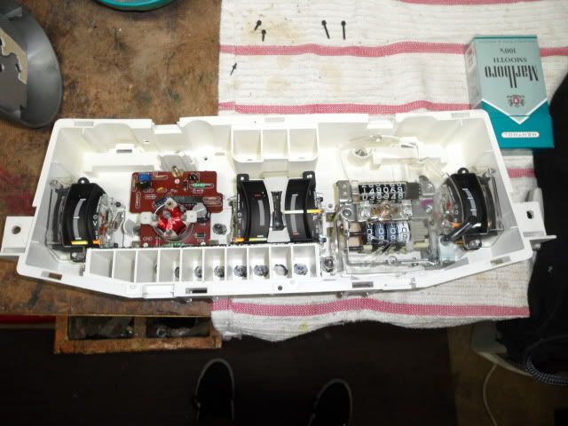

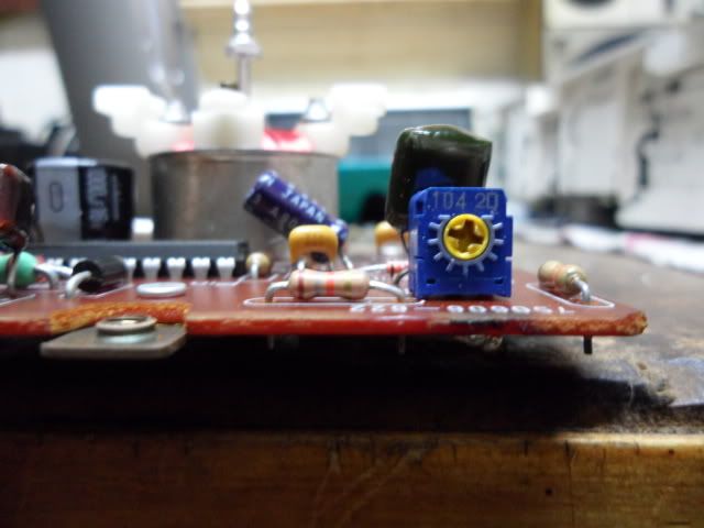

your looking for something like this, the little blue box with yellow screw
I'll try to get a better pic later

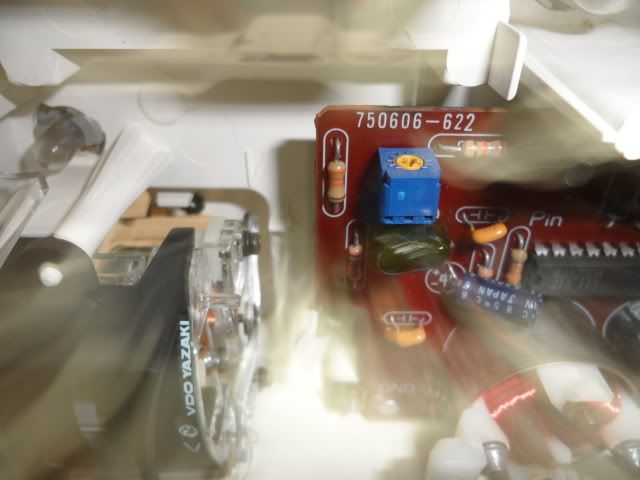

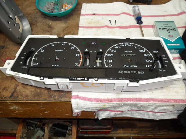

Postby LethalEthan » Sun Mar 06, 2011 9:22 am
ok here we go

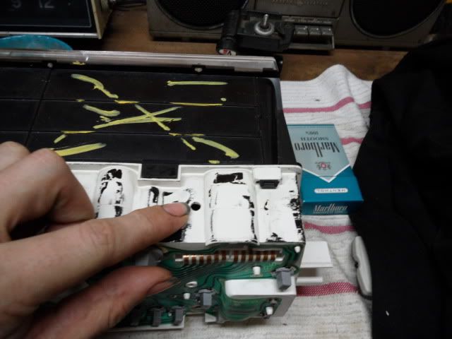

here you can see i've drilled a small hole in the top of the cluster case so I can adjust it with it almost completely installed in the truck, If you plan on doing it this way, I suggest you remove the board before drilling the hole or you could chip the board and have to solder it back together like I did. :doh:
Remove the lens and the gauge faces
It'll look something like this
Locate the potentiometer on the tach board and mark your spot on the case to drill the hole (the little blue box with screw.)
The screws that hold the tach in go through the back of the cluster where my three fingers are
Remove them and lift the board out

Postby Ram50man » Thu Mar 10, 2011 4:13 pm
Is that cluster from your Isuzu?
89 Ram 50, 2.0L, 2WD, 5 SPD Man., Reg Cab.
User avatar
Ram50man
Member
Member
Posts: 32
Joined: Sat Jan 15, 2011 7:06 pm
Engine Size: 2.0L
Re: tach clusters
Postby LethalEthan » Thu Mar 10, 2011 4:30 pm
yes the cluster in the pictures is from my isuzu
