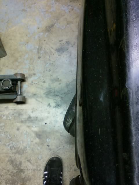

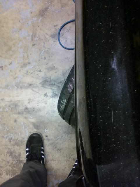

Well I adjusted them out. Gained a half turn on the steering wheel from center to lock. Haven't driven it yet but i'll see how that goes tomorrow
Before
After
