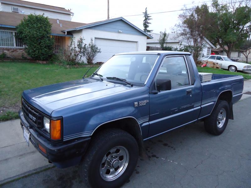

Postby ace of shades » Fri Nov 05, 2010 10:07 pm
I got the pictures. *thumbnails*
Top is the space between frame and rubber. second is the offset and the last speaks for itself Tires are 275/65/15 and the truck is sitting on a 3 inch body lift
