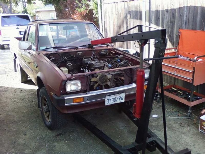

Here's pics of my D50, so named the Froot Truck.
Album with everything so far: http://s8.photobucket.com/albums/a47/ni ... t%20truck/
As it was driving:
Pulling the engine and tranny:
