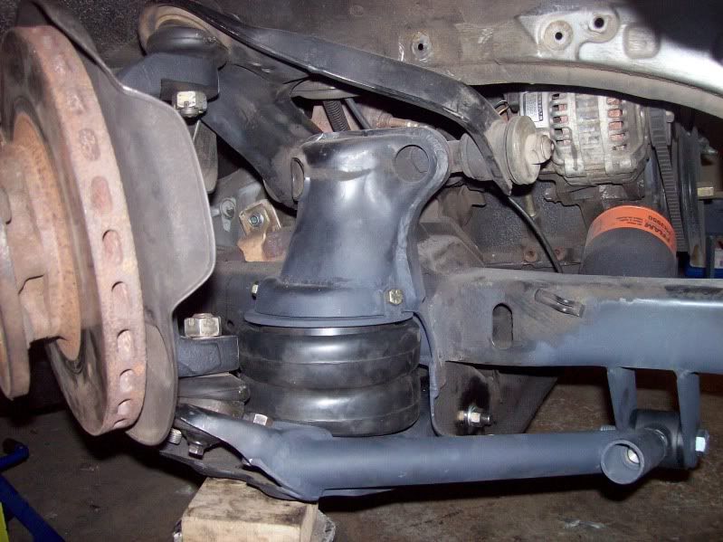

Hey Johnboy, what size bag did you use?? Looks huge!

It's AIM's bags. About a 2600 I believe. Don't remember...been away from home for a bit.

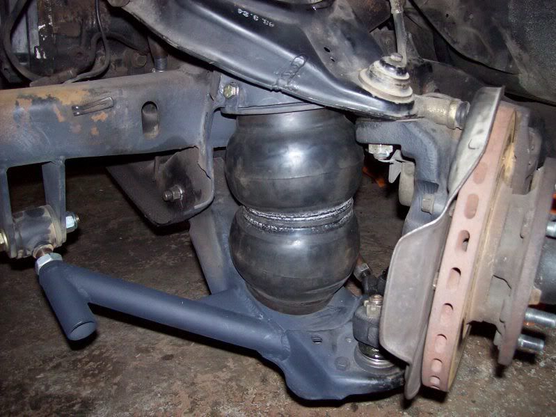

heres some of mine i got a build thread on the other d50 site.

I like the job you did to remove the strut rod. Also, I wish my upper bag plate was bigger!

Are those stock ball joints or uniballs? The angles seem kinda steep at both ends for stock ball joints.

He's got some pie cut upper control arms. That helps!!!

I saw that; but still seems that those bjs won't last long that way - and get your mind out of the gutter... :naughty: :nana: :o :roll: :wiggle:

ya there stock ball joints. theyll be fine theres still and inch of travel when its layed out. and when its aired up the angles are like stock. a ton of people use stock ball joints.
