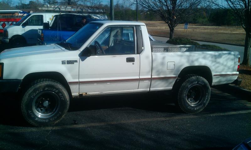

91 4g64 2wd reg. cab... to be rally/desert truck... eventually
