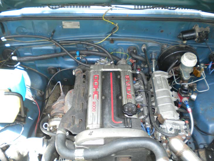

Also, can the guys that performed the 4g63 swap post up some pics of their engine bays? I believe I'll move up the engine 3" as I don't want to lose my A/C and cut the firewall.

I found that jay racing makes front thermostat housing for our motors. The ecu may still be usable although I am not too familure with the cyclone version. My manifold was modified by cutting off a section of the manifold and having it welded to the opposite side so it exits on the right side. Clears everything but replacing starters is going to be troublesome because I am still using the intake manifold brace. I hot pics on my photobucket and try to post but might take me a
while cause I'm at work.

As far as the ECU goes.... I know that DSM guys don't use JDM ECU's, though I am not sure of why. I would guess that it has extra crap for the cyclone manifold nonsense. If I were you, I would swap a modified 1G or EVO intake manifold on there and get a 1G (manual trans) EPROM ECU. Then in the future you can easily swap to DSMLINK (ECMLINK) when you are more familiar with the 4G63 engines and such. You also won't need to reinvent the wheel with your JDM stuff. I am sure you could sell that stuff on eBay and come close to breaking even for the US spec stuff. 1G intake manifolds are given away on DSM forums, but EPROM ECU's aren't. I would guess that the JDM wiring harness would come close to working with a US ECU if the 3 yellow connectors plug in and you are clever. If not, I happen to have a wiring harness exchange program that may peak your interest ;) I am also in the process of designing some motor mounts that move the engine forward a few inches. My first design works great, as long as you don't have a starter on your engine. :) Oops! Round two will be done this weekend most likely, and should be a lot better than round 1.

What about that water neck on the rear? I was thinking of cutting that and turning it at 90 degrees. That and swapping TB to front. Will I still need to move it a full 3" forward? I'm gonna hopefully get to drop motor in next weekend just to see what I'm working with.

1st generation 1.8 eclipse na. I ordered mine from the dealer for like 70. Told them 1990. It corrects the angle to point at a 90 already. Only thing is that it eliminates the fan switch.

4doorciv wrote:1st generation 1.8 eclipse na. I ordered mine from the dealer for like 70. Told them 1990. It corrects the angle to point at a 90 already. Only thing is that it eliminates the fan switch.
Exactly, and if you hit up the local junkyards, these 1.8L thermostat housings can be had for $5 ish. I really really recommend moving the engine forward. I think it makes a way cleaner swap when all is said and done.

Ok got the Tstat housing and see what y'all were saying about that sensor. Guess we'll cross that road in the future.

Im using the old coil resistor to turn on my fan for now. Im too broke and trying to get mines to run right at idle to be concerned about picking up a thermal switch. If anything I can tee a coolant line and add the oem switch later. Fan on when the key is on. Moving the engine forward is a much cleaner method as Jeremy said. I have no access to a welder or the fabricator knowledge to do any needed modification.
