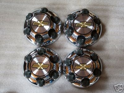

    Chevy/GM Rallye Rims
    I had a set of 15"x8" Cheyenne rims, found a set of bow-tie centre caps, already had a set of 2 1/4" Chrysler 300 centre caps.....peeled the bow-tie off of the Chevy caps, drilled a 2" hole in the centre and popped my 300 caps in. I had my rim centre hole machined to eliminate the centre lip and voila....instant 15" rims that look awesome on the truck. The offset allows me to put 275 60's on them with lots of clearance.

    With these caps, I also picked up 24 Chevy lugnuts with the threaded tops....the caps black plastic lugnuts screw onto the metal ones securing the cap to your rims
