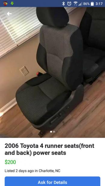

			Looking to replace my bench possibly!??? 4 runner seats? Just afraid they will sit up to high or two far up/in?has Anyone done some 4 runner bucket seats??
