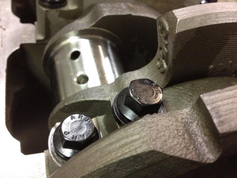

Bottom End-
Block- Bored .060
-New pistons
-Reconditioned rods
Crank- 10-10 grind
-ARP Main bolts

545706_418512901510281_802566602_n.jpg 538524_418513044843600_173083646_n.jpg
