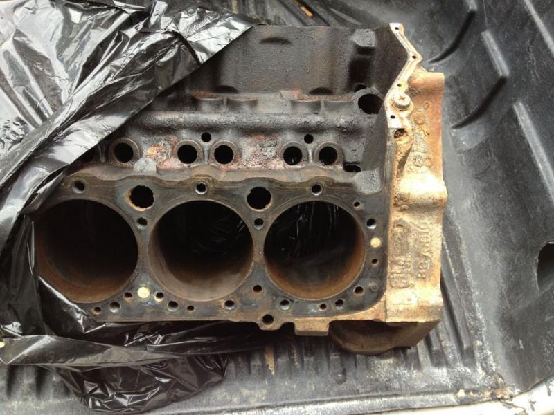

    '75 Chevy 350 -4 bolt
    WCT5 transmission
    Bottom End-
    Block- Bored .060
    -New pistons
    -Reconditioned rods
    Crank- 10-10 grind

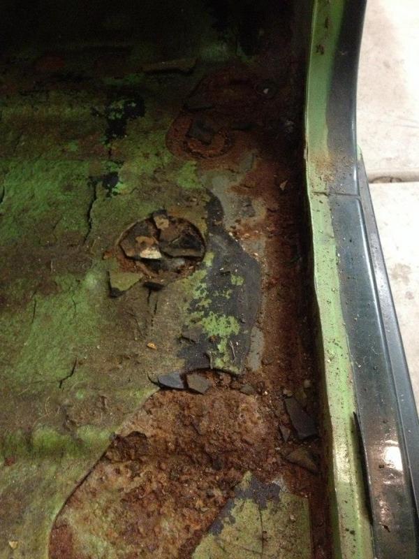

    Had to rebuild the carb and do some spring cleaning
    Started to do a little body work while it was still running.
    536801_433879693306935_1566446580_n.jpg 562204_433879879973583_165979311_n.jpg
    205240_458306950864209_82065080_n.jpg 295274_487014181326819_1242419519_n.jpg
    welded all the trim holes
    uncovered the old mirror holes and welded them

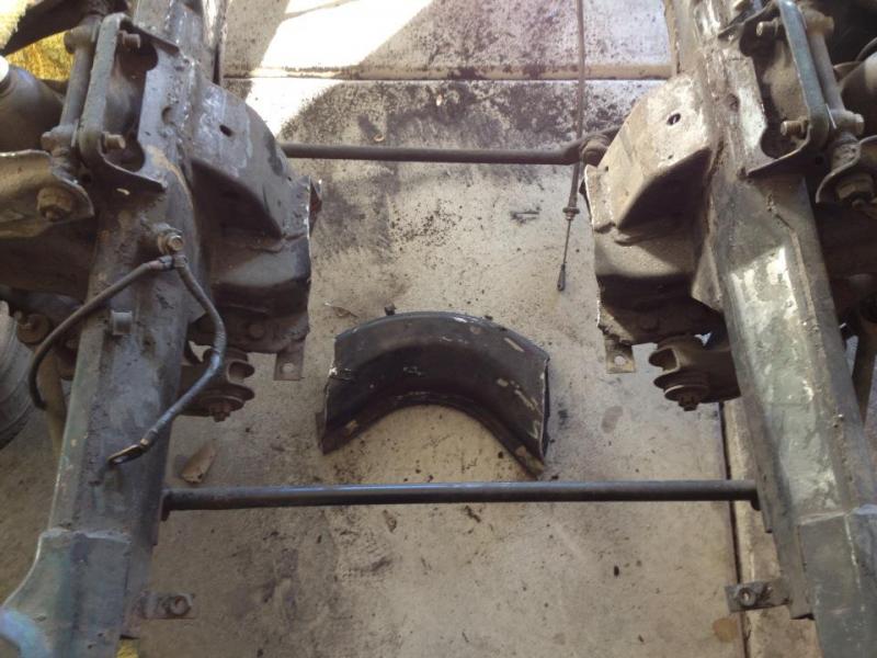

    Cut the center of the cross member out.
    524866_542589779102592_840599018_n.jpg 481439_542589812435922_1770970196_n.jpg
    Set the engine back in. Now I have to cut the frame around the bell housing. It's too wide to drop down in there. The starter hump and the slave bracket rest against the sides and won't let it go down.
    I'll also have to get different engine mounts. These are sitting on the frame right now, and I still want the engine to set about 4 inches lower than it is.
    It's going to be fun come time to do the exhaust. The frame rails are directly under where the exhaust would turn down.

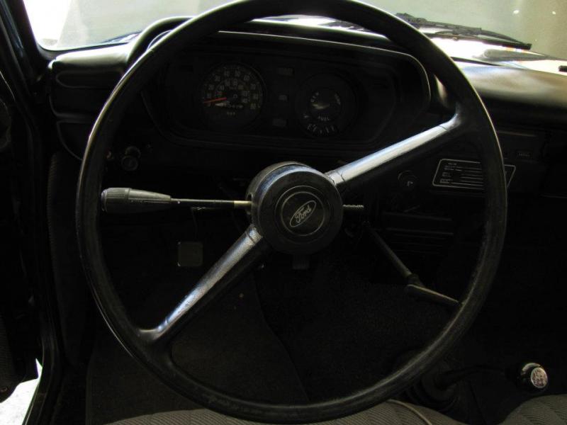

    You got some pics of the inside of the cab? Ie dash. Lol.

    My Christmas presents came in today. Now I can finish putting the valve train together and close up the front of the engine.
    These are the only shots of the interior I have

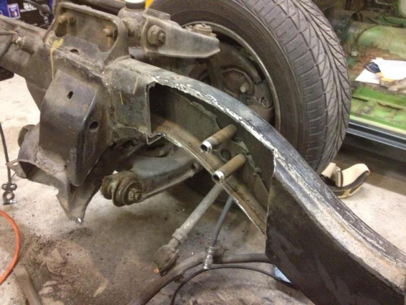

    For Christmas, I did some more work. Cut the sections out of the frame to fit the bell housing and got the engine mounted.
    Had to cut the mounts nearly all the way down to get them between the frame with enough room to mount the brackets.
    I'm going to start on the trans cross member/mount this weekend.
    They look crooked in the picture, but they're lined up. Don't worry.
