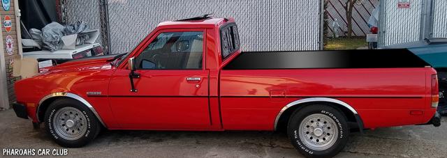

    1986 Mitsubishi Mighty Max Pick Up
    1986 Mitsubishi Mighty Max ("Mitsy") Repair-Renew-Rebuild-Replace Thread Build

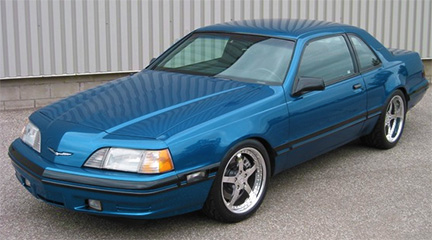

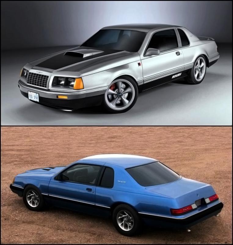

    I located this Roush version of the T-Bird that really catches the eye. I don't really like the scoop on the hood much and I'm going to go with the Turbo Coupe Naca style instead. The color scheme on the Roush is what I am going to aim for, with maybe a darker upper silver that is shown or also maybe a dark Gold upper body with all the chrome trims changed to black.

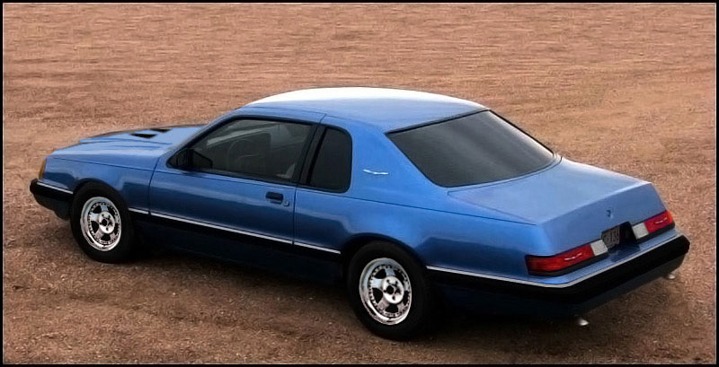

    The blue one above looks like the one I have, same color and parts. Mine has chrome different style rims though, with wider tires.

    The wifey spotted this image and she wants this TBird to be just like the one here. Must have 40 coats of clearcoat on this thing, Oh great.
    Actually I kind of like it too, but I keep hearing this ringing in my head....cha-ching cha-ching. If she wants this paint, she'll have to sell her Olds Achieva to pay for it. Probably.
    That lower color looks like the 90's rasberry pearl from dodge shadows or other mopar front drivers, the top looks black - look on ebay at tcp global or autobodydepot for deals on gallons of PPG paint deltron basecoat. Then use some high solids clear, there are several on ebay for 100 to 150 for everything that give a good gloss with good prep.
    Thanks Pennyman, going to check that out. Hope she doesn't want those rims and tires also, lol.

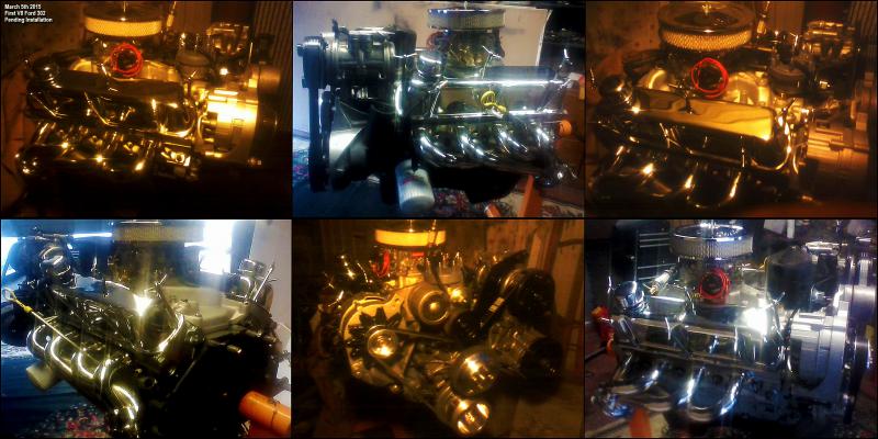

    Restoration Build for 1985 Thunderbird, purchased $500.
    Completed List
    Pull '85 302 Engine, Install 1988 302 V8
    Rebuilt AOD 4 Speed Automatic Transmission
    All New Seals & Hoses
    Ford Racing Roller HO E303 1.6 Cam 1,3,7,2,6,5,4,8
    Ford Racing Hydraulic lifters, Rockers & Push Rods
    Comp Cams Magnum Double Roller Timing Gear Set
    Edelbrock 1406 600cfm 4bbl Carburetor
    Edelbrock 2121K Performer Intake & kit
    Edelbrock Top Flow Air Cleaner
    Carb Throttle Linkage
    MSD Digital 6A Multispark Ignition
    MSD 8282 Blaster ll Coil
    MSD Pro-Billet Full Race Distributor / New Steel Gear / No Vaccum Advance
    Chrome Valve Covers/T-handles
    Chrome Shorty Style Hugger Headers
    K&N crank case breather
    Duel Stainless Pypes Mufflers & Chrome Tips
    BBK Aluminiumized Duel Exhaust "X" Pipe
    Ford Distributor Rubber Cover Protector
    March Performance Serpentine Underdrive Engine Pulley Kit w/Oversized Alt Pulley.
    FelPro Full Gasket Kit w/One piece Blue Oil Pan Metal Inlaid Rubber Gasket
    Lokar TV kick-down cable
    Lokar Throttle cable
    Lokar Throttle, TV, Cruise control carb Bracket
    B&M AOD Shift Improver / Street Set Installation
    Wix Trany Filter
    Wix Fuel Filter
    Ported heads - exhaust and gasket matched head to header
    Trick Flow Double Valve Spring Complete Set
    Remove and Relap Exhaust & Intake Valves, New guide seals
    Repaint engine bay to black
    Holley Fuel Pressure regulator
    Holley Red Fuel Pump
    Replace all 5/16 vinyl fuel lines to 3/8 aluminum / Removed in tank EFI fuel pump & insert pickup pipe in place
    Goody's Fuel Regulator Pressure Gauge
    Turbo Coupe Naca Hood Scoops
    New Aluminum Heater Core
    Remove Fuel Tank, Flush, Paint, Replace Sock Filter, Remove Tank Pump
    Replaced Dash Speedo Display & Repaired the transmission gear indicator.
    Starter & Solenoid
    KYB Shocks
    Column to Console Shifter Upgrade
    Completed Interior
    Switched column shift to a Mustang HO console shifter
    Wink 5 panel rear view mirror
    Dye Entire interior to Black
    New electrical column engine start switch & New Key starter switch
    New Pioneer stereo in dash w/new quad speakers
    New Cougar 3rd Tail Light
    Dash Cover
    New Windshield
    Replace headliner
    Rebuilt both window regulator motors & door lock motors, lubed mechanism.
    Redo upholstery under back window

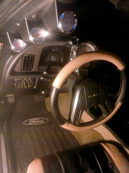

    Install 3 gauge pillar
    Install 9 New Gauges & Sensors
    *Sun Tachometer w/rev light Gauge
    *Voltmeter Gauge
    *Engine Temperature Gauge
    *Oil pressure Gauge
    *Trany Pressure Gauge
    *Trany Temp Gauge
    *Vacuum Gauge
    *Goody's Fuel Regulator Pressure Gauge
    *AEM Rich/Lean fuel mixture gauge w/ wideband Bosch exhaust sensor
    ToDo
    New Paint - Car
    Lowering Kit
    Tint Windows
    AC Recharge
    Hood shocks
    Brakes
    ORDERED Shipped/or in Transit

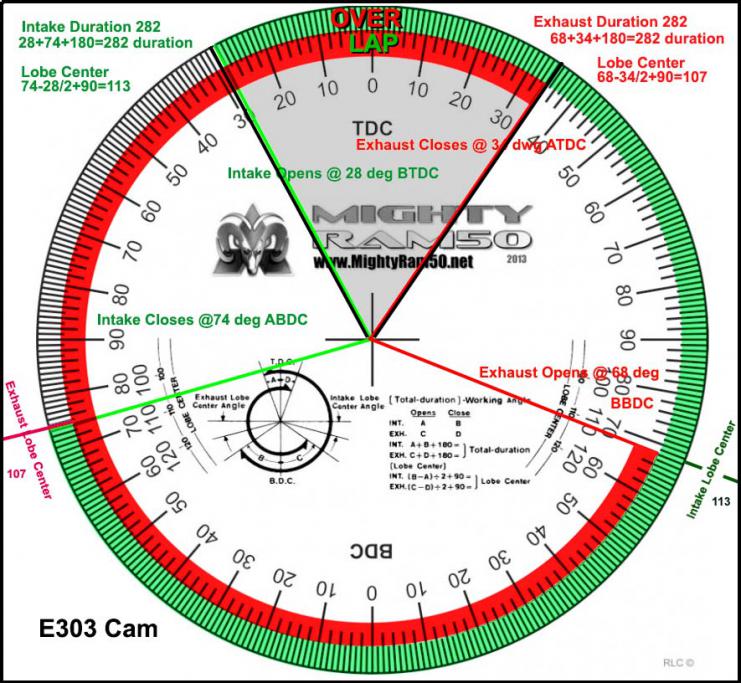

    Calculations & Cam card for the Ford Performance Racing Cam - preparing for degree & install in Tbird.

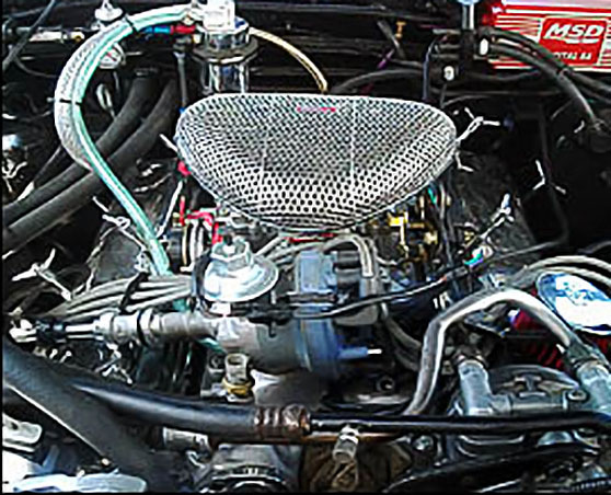

    The engine when I first brought it home.

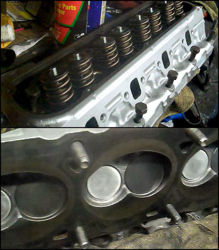

    Little update on my Ford Thunderbird build. Block is done, pistons and all are cleaned, timing gear set, race cam, seals are in, Heads are done porting with new springs set, valves are all re-lapped and heads are painted. They should be installed soon with new racing push-rods. The timing cover and water pump are on.
    Updated post:
    Completed heads & pistons - Before/After
    Now starting to look like an engine again, its nice not to have that caked on grease packing that was on the motor before the build. Hard work when you have to take a wire brush drill to every friggin thing that there is. Thank god for brake cleaner too.

    Right now I am in a holding pattern with the engine sitting in the garage all finished and the car is now on the driveway getting the rework. Have the engine bay all painted black and pulling wire and smog vacuum lines out. I hope to start the trany in a few days, the instructions say a few hours to finish, probably take me a day, lol.
    Also the trany holds a shitload of trany fluid. I think it said almost 7 quarts which is expensive, lol. I'll try to post up about the trany Kit as long as I don't mess it up.
    looks so much better then when I started. Finally having room to work around an engine when it gets reinstalled.
    UPDATE:
    Here is a short video as I attempted to install the 302 into the car the other night. It was real late and I was exhausted. I managed to get the picker off the engine, but the engine is not buckled in yet. Today might finish the bolt up, we'll see.

    This was video'd on the end of July 2015 when I fired the engine up.
    There is so much more work to do and seems when I finish one thing,
    3 more things need to be done. It's exhausting.
    "Winter is Over, Time to Get Things Closer to Completion"
    I have had the motor placed for sometime now and I am moving through all the other things a swap like this involves. I do this in spare time so it can have some gaps in progress. Anyway, I am back on the TBird and we are getting close to another start up. Since the last time started I have rewired all the gauges and additional items I have installed onto a separate wiring system with 2 new fuse panels. I found that the original fuse panel was just becoming ridiculously crowded and look like shit with wires coming and going. It now is clean again and sits next to the 2 new panels.
    This image is the engine installed, but it needs to be updated again since the distributor laying on top there has a new version installed now. I have been working on wiring and interior and that is pretty much finished now except for connecting the main wires, 1 for constant 12v and the other Key On 12v under the hood. Picked up a new battery and it goes in today so those 12v wires should be connected then as well.
    I have changed the column shifter to a console shifter and I am presently under the car doing the requirements to have this update working just like factory. I have the cable almost installed then I have to drop the trany pan to reverse the shifter lever to change from a pull to a push for the new console shift.
    Anyway, here are some blurry cell phone images of interior with new seat covers and dash area. This car came with a light tan interior and is being changed to black with the tan being accent color. I still have some more changes to complete this transformation. I just am getting eager to have it running now and this is the goal now.
