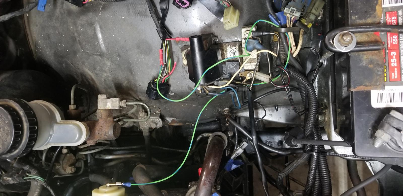

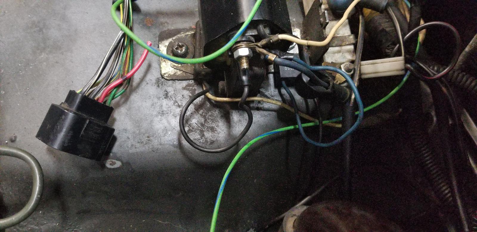

    So I tried the starter fluid and the timing. Still the same. I was doing some other testing and noticed the spark seems weak. Could that be a problem and if so, what could cause it? Also, I know the vacuum system is obsolete but from looking at wiring diagrams the gray control box on the drivers side has like 2 ignition wires that hook into it. Do I need to have that hooked up?
    Weak spark could be due to poor ground or harness connections. Check the battery-to-frame-to-block and the head-to-firewall cables for continuity and clean their contact surfaces. Then check that the coil, resistor block and distributor wiring connections are clean and secure. The coil or ignition igniter in the distributor could be failing, but if it ran fine before the Weber install, I doubt these are causing the starting problem.
    I‘m not sure about the ignition wires to the gray device box. My schematic shows only one, a black and white wire from the resistor block to a choke relay in the box. Like the vacuum lines with the Weber, the harness connections to the box no longer have a purpose. I don’t think it needs to be connected.
    What is the power source for the Weber’s choke? Maybe it’s competing with and killing power to the starting ignition? Look at this thread which describes a loss of spark after a Weber install: http://www.mightyram50.net/vbulletin...spark-to-plugs . See if yours starts after disconnecting the choke wire like rranger found. If it starts, find another power source for the choke. It needs to be energized only when the key is in the "On" position.
  2. #277
    12-05-2015
    7
    Tacoma, WA
    Still nothing, all grounds are good, all connections are clean and secure. My weber choke is connected to a wire that use to plug into the old carb. I attached pictures of the wiring. I hooked everything back up the same exact way it came of but something seems off.
  3. #278
    07-23-2018
    435
    Seattle, WA
    1988 Dodge Power Ram 50
    Hmmm. I'm running out of possibilities. Nothing in the pictures looked wrong. Just to be clear, when you tested for spark, was it at the plugs?

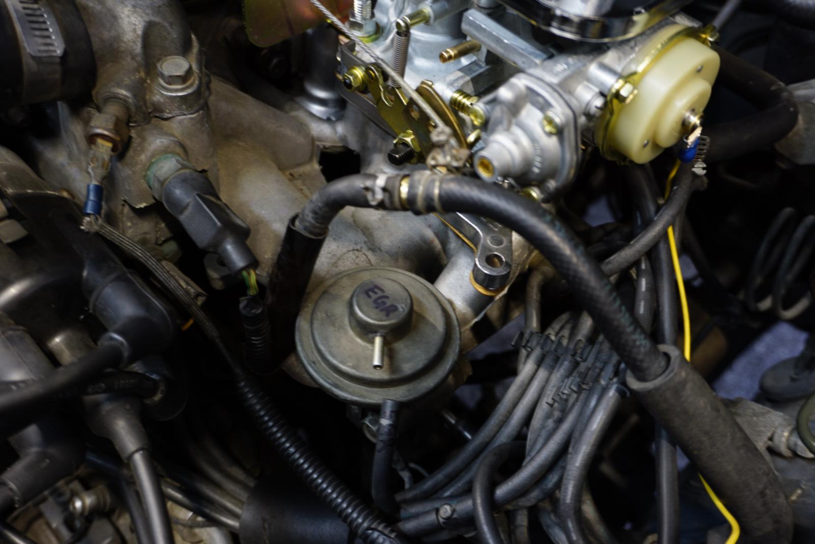

    Hey guys,
    So i decided to tackle the weber project yesterday. I got the genuine weber 32/36 DGEV installed and the truck is starting and running fine. I have the idle and mixture screws tuned according the installation instructions. Fast idle screw is set to 2,000 RPM, idle speed screw is 1 1/2 turns in, and mixture screw is 1 1/2 turns out. The installation of the carb was straight forward, but there are a few things that I'm unsure about though so maybe someone here can shed some light for me. Mostly what to do with all my old vacuum lines. I have 1989 G63B manual with A/C.
    1. I'd like to keep the vacuum lines in the engine bay for the emissions look, does anything need to be capped off not and just tucked away?
    2. #8 in the installation instructions say to "Disconnect the evaporative emissions lines from the carb and air filter at the charcoal canister". does this mean to completely remove or cap off the lines coming off the charcoal canister labeled "to carb" and "to A?C"?
    3. #9 in the instructions says "disconnect EGR valve and thermal switch next to it, they will disconnected and not be used". I disconnected the large vacuum line on the bottom oft he EGR as well as the small line going into the top, but which switch needs to be unplugged? There are three all in the same area just to the left of the EGR going into the thermostat housing.
    4. #11 in the instructions says "Remove the two exhaust tubes from the exhaust manifold and use 1 1/4 plugs supplied to plug the holes". There was only one hole tp be plugged coming out of the manifold. It was the one that had the large metal pipe coming out of it going to the air control valve. I did remove the metal tube coming off the manifold and the entire secondary air valve assembly and used the supplied plug to the the hole in the manifold.
    5. #12 in the instructions says "plug all open vacuum lines and thermal switch fittings on the intake manifold. make ABSOLUTELY SURE there are no connections to the EGR, the only vacuum used if the the power brakes". I'm unsure of exactly what I need to plug off here. Both lines going to the EGR have been disconnected and the factory vacuum line going from the brake booster to the intake manifold was untouched and still in place.
    6. How does my electric choke connection look? Acceptable? it is a keyed power source, but just want to make sure with you guys its OK and if there isnt a better place to hook it up.
    7. The vacuum line going from the carb to the distributor. There are 2 vacuum lines on my distributor: one coming off the side and one coming out of the bottom, which is the correct one to use and does the other need to be plugged or left open?
    8. Fuel return line. Right now I have the return line coming off the fuel pump connected via a wire barb to the line going back to the tank. Is this correct?
    *I have a Carbole electric fuel pump P/N 42S that I plan on installing in the next few days that will eliminate the stock mechanical pump. Once i install this electric fuel pump what will I do with the return line?
    9. The trhottle return spring. is there a right and wrong way to install this is or is it just a make it work as best as possible kind of thing?
    Thank you for any and all input!
  6. #281
    3,812
    So far everything looks fine.
  7. #282
    526
    If you've got a box on the driver's side inner fender with a bunch of vac lines running to it, that's a control box for the stock Mikuni carb, so you may as well pull that along with all vac lines connected to it, which will simplify things enormously.
    That should leave a "tree" of open vac hose barbs screwed into the manifold, so you just need to cap those off, or IMO better yet run a short length of vac hose between pairs of those barbs and then just cap any odd man out (as caps tend to deteriorate more readily than hose does). Some ppl even unscrew that tree and plug the hole, but it's a weird 1/8"-28 BSPT thread (not the US-typical NPT) that you'd prolly need to special-order a plug for off eBay.
    You don't have to cap any barbs attached to sensors/senders, as those aren't open to manifold vacuum.
