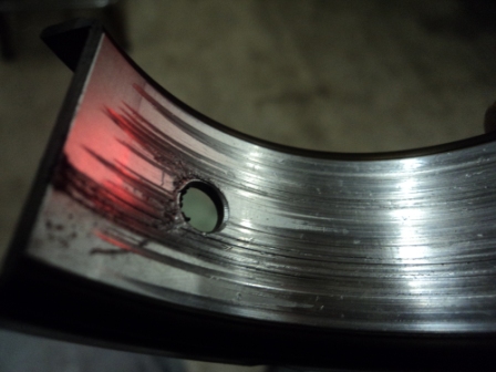

    here is what all the main bearings look like
    next week the block, new rods and pistons, crank, flywheel, clutch, and front pulley go in to the machine shop to have the bore pushed 0.020 over and a full engine balance. i am going to have two pounds of metal removed from the flywheel as well as eliminating the balance shafts, hence having the motor balanced. i am also going ditributorless so you will get to see how i progress with that.

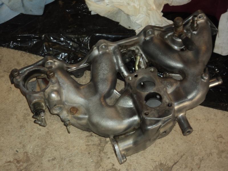

    clean and shiny intake. its going in to the machine shop to have the face trued up (on the off chance its not straight. it does have 200,000 miles on it) and the inside polished.
