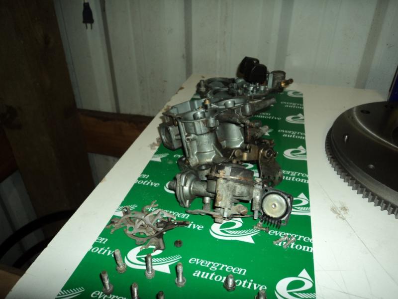

i didn't realize that the weber carb i wanted to use is not a weber at all. i found out that the EPC 32/36 is not a weber but a knock-off of the weber
so i had to rummage through my parts shelf and i came up with this actual weber DGAV 32/36
now i have to rebuild this one so i can put it on the motor
rebuild kit for the carb will be here tomorrow. can't wait for that

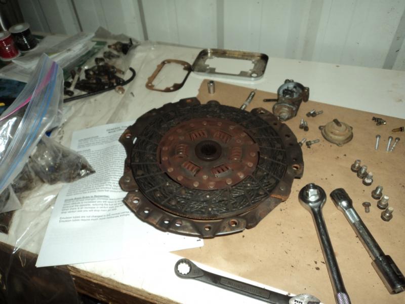

here's the transmission and clutch

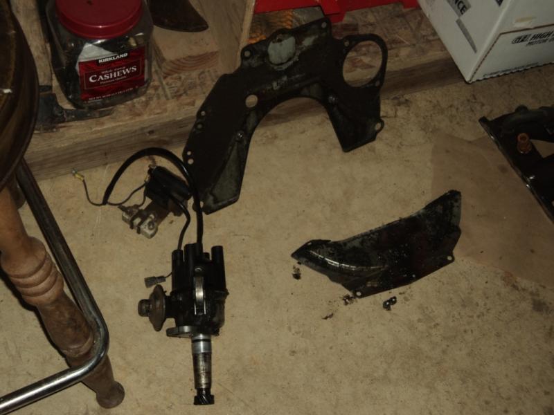

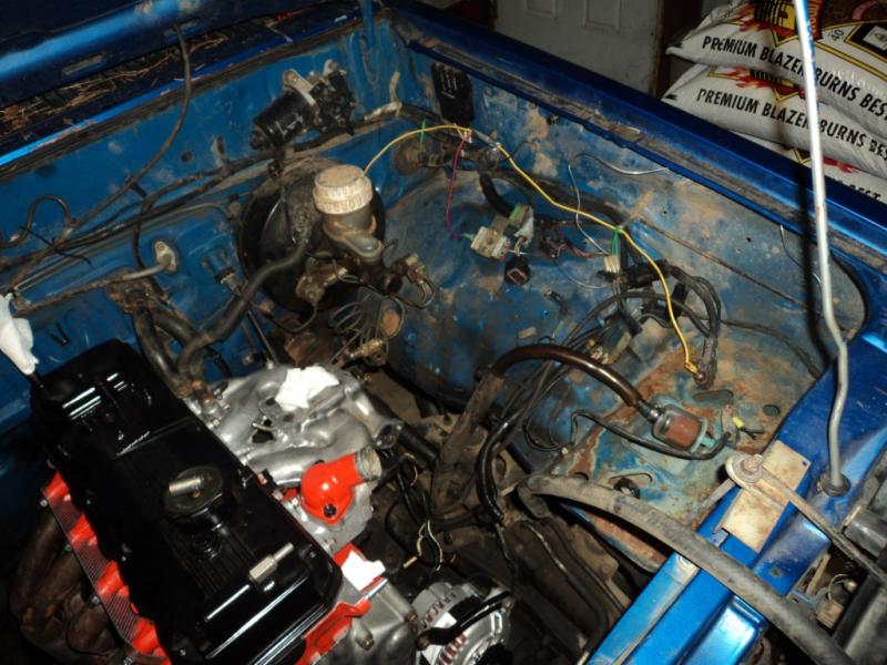

here's the engine bay all dirty. i'll pressure wash it in the morning then the new motor will go in. i still have to eliminate the distributor and coil.

cleaner engine bay

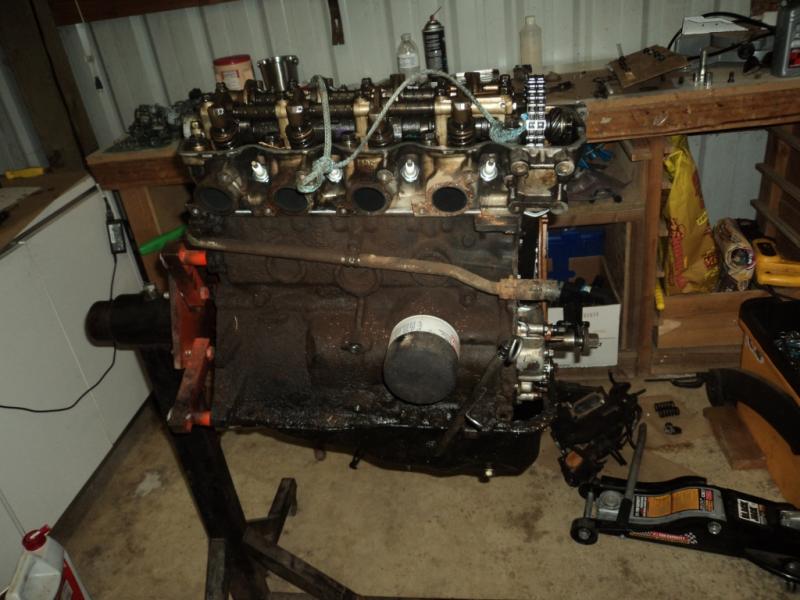

the old motor

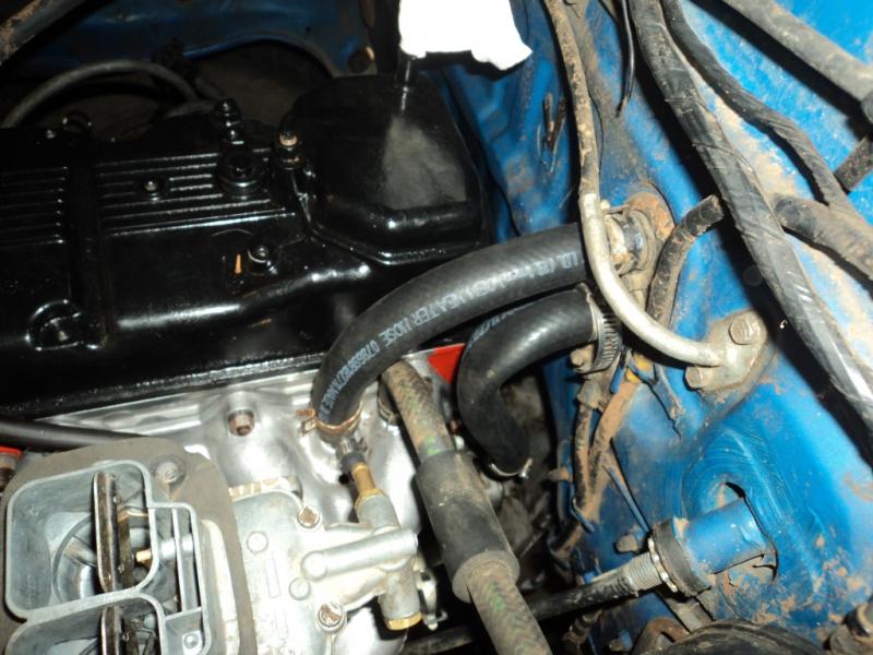

since the truck has a 3 inch lift i had to go custom with the heater core hoses
