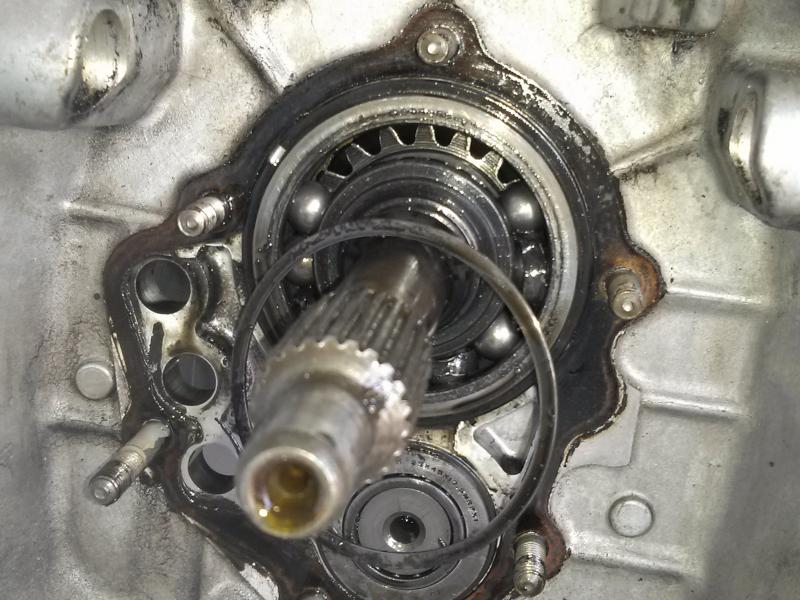

    I want to seperate the aft portion of the 145 trans but can,t info how to do that as well as the dississembly of the gearbox???
    512
    what about the 2.6 bolted to a 132 going onto a 145 that had a 2.6 on it?
    512
    Quote Originally Posted by Salteen View Post
    its a 1982 with a 2.6 i dont want to change transmissions the 145 has higher 1st and second. its going in a 1987
    01-19-2019
    24
    Lake Isabella Ca.
    1984 Dodge Ram 50
    4D56-T
