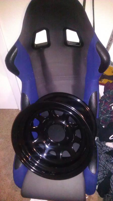

    Finally got the front and rear suspension work done other then the tie rods because summit sent me the wrong ends. Plus the inners wouldnt go on because the threads werent even finished. Finally got my rims, im going to wait until i get my new tie rods before i get them mounted.
