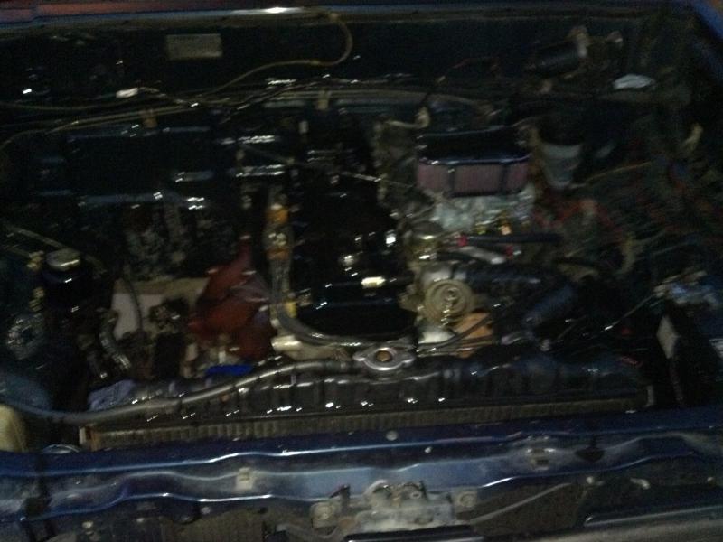

    1. Cleaned and sanded the entire engine bay and painted with VHT Roll Bar and Chassis 250F paint and clear coat

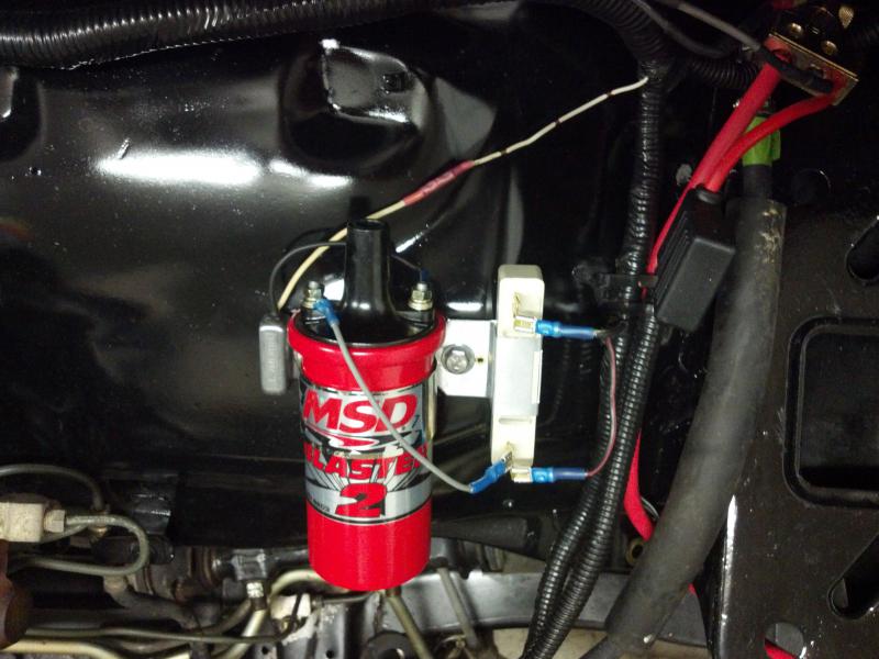

    4. Got rid of the old ignition coil and put in a msd blaster coil with resistor

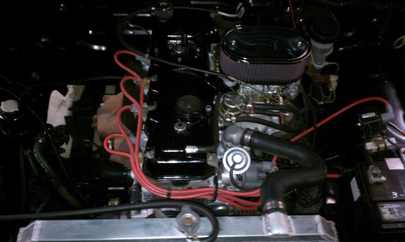

    Sorry for the delay but here are some more pictures of the finished motor in the truck!!!

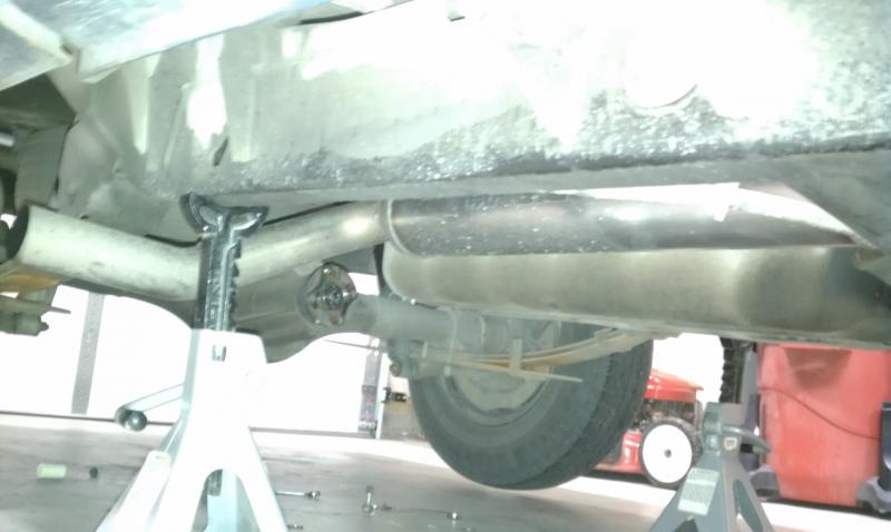

    Below is the Stainless Steel Exhaust!!!!
    original restrictive header downpipe vs. header w/ 2.5" elbow fitted to maximize flow. Then 2.5" - 2.25" smooth transistion with reinforcment ring.
    1st picture-above is the complete assembly as it is hung under the truck.
    2nd picture-High flow Magnaflow cat(part# 50005) attached to Magnaflow 4" x 22" ( part# 10345 ).
    3rd picture- factory exhaust hanger modified with removable ubolt instead of being welded.
    1st picture- assembly with bracket installed to go over frame
    2nd picure - muffler with mandrel bend 90deg elbow into a 45deg to exit in front of the rear tires.
    **** for this to work where the flanges are the factory heat sheild needs to be trimmed out just a little bit to get rid of really bad vibration.****
