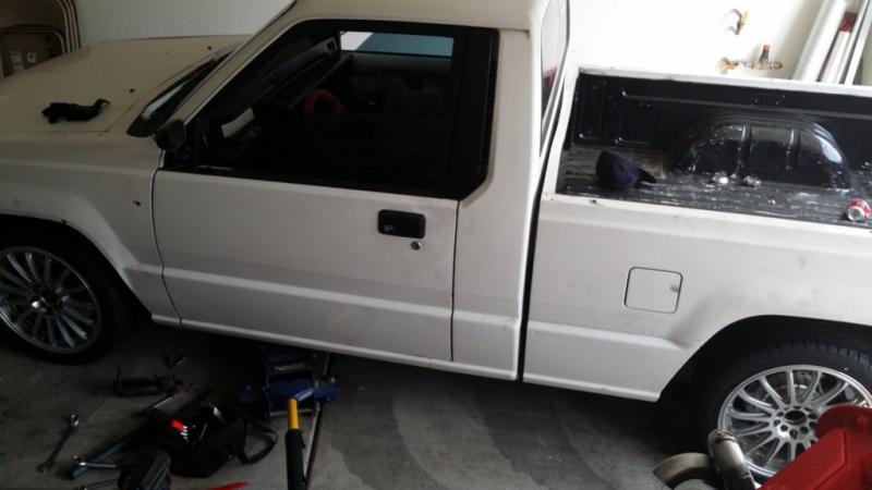

    Snagged the last couple pieces needed for the 8.8 to bolt in. Phase 1 of the chassis is almost complete! Just a little bit longer and this truck will be rollin with a Ford 8.8 with 4 disc big brakes all the way around and a fresh set of wheels.
    I'm actually getting excited.

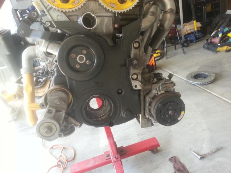

    Virtually every other 4G6X engine will allow use of 4G6X parts. They have many of the same holes, castings, and components - but this one remains the odd ball. Aside from missing some castings, I must also figure out how to make Evo bits mingle with Momtero Sport bits.
    He is one example - the water pump. Since this is a RWD block, the thermostat is on the side of the block with its own housing. It works with the Montero Sport water pump, but the Evo pump is clocked differently. Here is what I have to solve.
    The inlet of the Evo pump is now right where the thermostat housing bracket is
    and.....
    They are now offset.
    It is an easy fix for any custom fabricator - simply modify the pump to work. In my opinion, that is crossing the line. There is a difference between fabrication (to build, fix, or solve anything), and engineering (devising a solution rather than a fix).
    I need to cut a section of the bracket off and build a new water pipe so I can replace the water pump with any other if it ever goes bad. There is no point in custom building something that I will have to do repeatedly in the event of a failure.

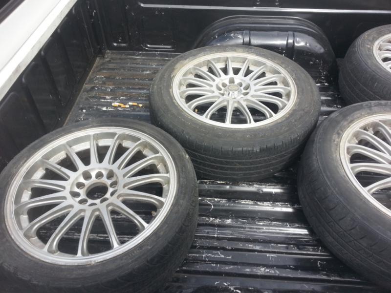

    Finally, I had a problem with the IS300 wheels I scored. They do not fit over the Toyota hubs, and they definitely do not fit over the Ford hubs. I went out of my way to come up with solutions since I already have money invested into the wheels and lug nuts that fit Lexus mags to 1/2" studs (not cheap). At the end of the day, I can't put my name on any half assed solution I could think of or find. I had to scratch the wheels off the list. No matter how temporary the wheels might be intended for, I will not let even my own vehicle out the door with anything less than a well engineered design.
    So I went hunting for more wheels. This is more difficult than it seems. I have 2 very different offsets to deal with, and 2 dufferent hub sizes. I was at the yard again today pulling little bits and pieces when I saw a set of Enkei wheels for sale. I test fit them to both hubs - and they cleared! I wasted no time buying them.
    They are in very decent shape. I do have to put a little work into them, but not as much as most yard wheels.

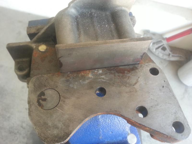

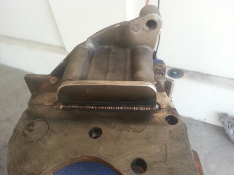

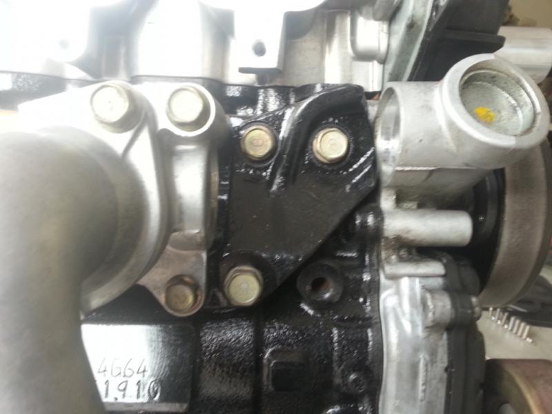

    Started off with the idler bracket on the engine. As I stated before, this engine is a 4G64, but it doesn't have the same castings as the other 4G6X engines. It's an odd ball. So here is the solution
    First off I measured the bracket to find out how much needs to come off and marked it, followed by cutting it down, and cutting a new bolt plate to fasten it to
    Next up was a quick weld and a trim to clean it up
    Since this piece was added, the back plate needed to be modified as well. A simple slit did the job.
    While the coating was drying, I shaved down the existing bolt hole on the block and the serial number casting to clear the plate I welded to the bracket. Once it was all dried, I fitted it and marked the holes for the hardware.

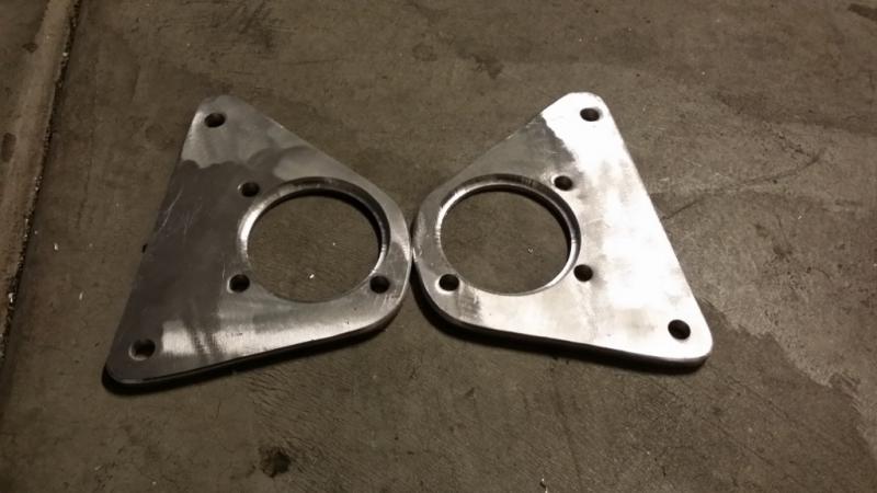

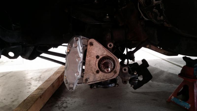

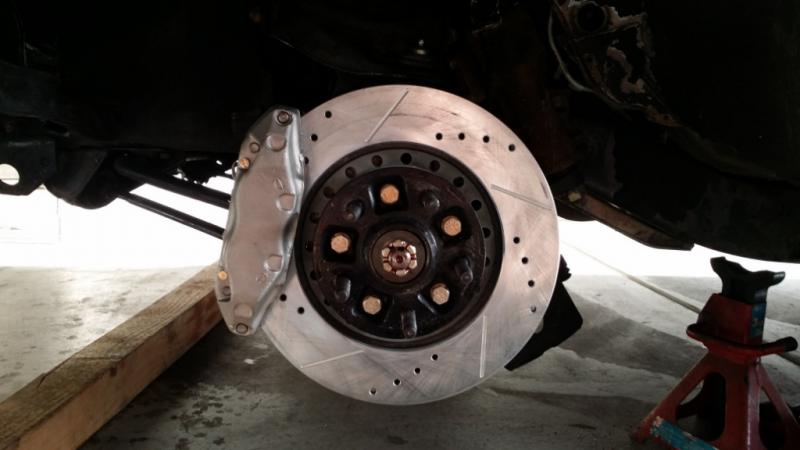

    Now on to the cool stuff..... stopping power! This is the mounting solution for the rotor to hub mounting. Basically nothing more than some square nuts welded to the rotor. I used larger grade 8 hardware for fasteners. Here is the final assembly of rotors to hubs

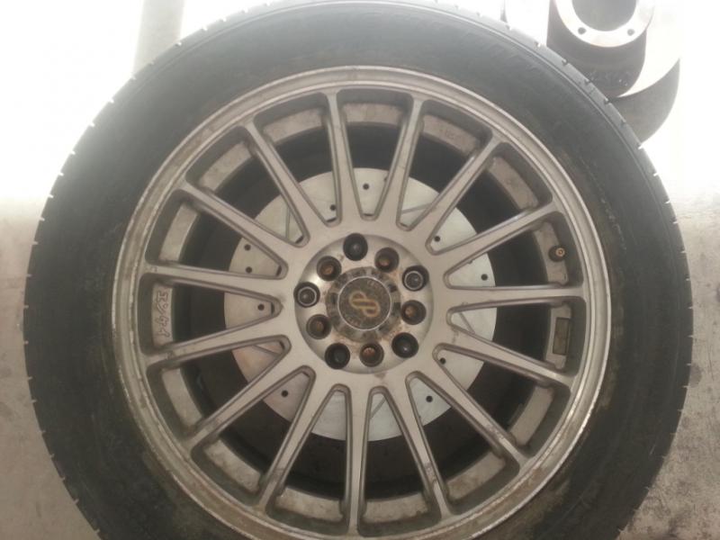

    And finally - a wheel shot

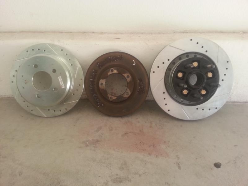

    Sadly, without the caliper, a 17" wheel makes a 12.5" rotor look not as big
    The total badassery of this next pic is: the front rotors (right) are 20% larger than my stock ones (middle). The rears (left) are even bigger than my stock rotors. There is nothing cooler than saying you have gigantotasticcrazy big brakes so big that the rears are bigger than your old fronts.
    Speaking of calipers.... I was making the 2 pot Montero Sport calipers work with the 314mm rotors. The only problem with it is I don't like it. In order to get the clearance I needed, I had to remove about 1/4" of metal from the bracket. That really isn't much, but it did make the bracket look pretty wimpy. Instead of rolling with it, I shelled out a lot of money for a new front set of VR-4 4 pots for the front. They should be in next week sometime...
    It was only when buying the VR-4 calipers that I thought I should have run the smaller brakes the big calipers are almost twice as much, and harder to find unused.

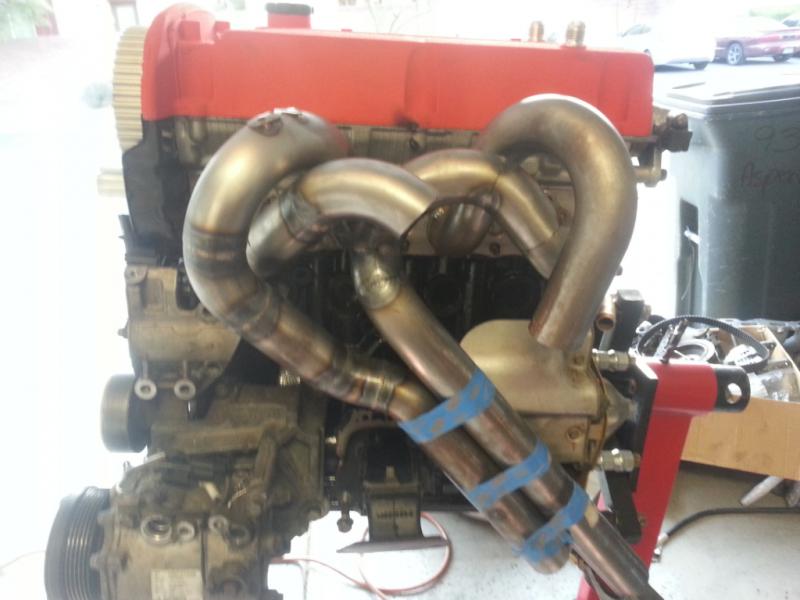

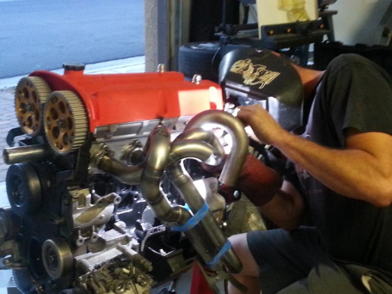

    On that note, I did some more welding to my headers. I had to correct one of the primary tubes, then another.... then I ran out of tubes
    More are on the way now along with lug nuts, front pads for the VR-4 calipers, and new lug nuts (for the third time) to fit my third set of wheels.
    Here is a shot of the header as it stands now

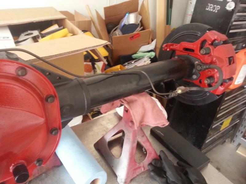

    On the plus side - the Ford 8.8 is now completely ready to drop in. I had to remake the brake line since I narrowed the axle. Just waiting on the calipers to show so I can swap the whole chassis at once. At the moment I have no shop, so its a mess trying to work in here, but whatever... this is how it looks (sadly - this isn't all my stuff - some is still in SoCal). Either way, here is a crappy pic ..

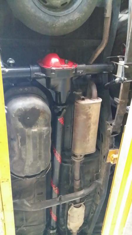

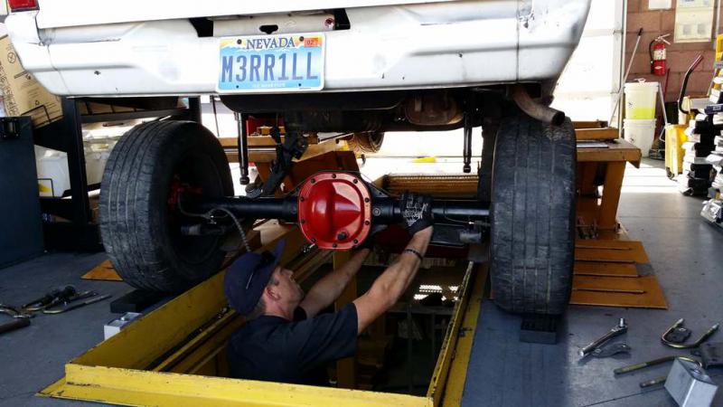

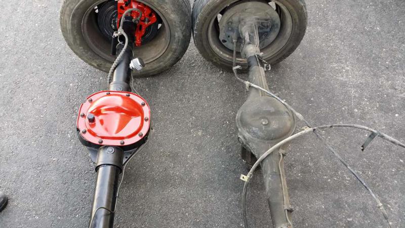

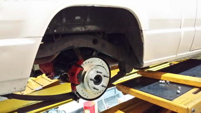

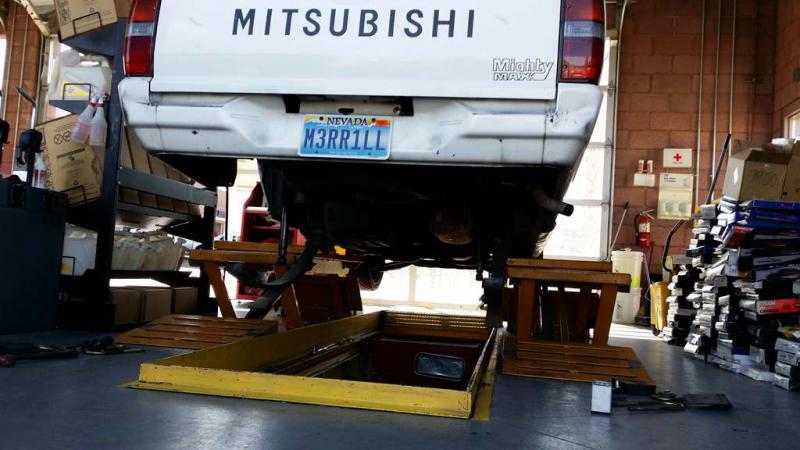

    THE 8.8 IS IN!!
    Here are some pics of the install. It's pretty straight forward as far as the job goes...
    I will make a 2 "How To" on narrowing and swapping since it is all done now, but here are some quick pics and notes for now.

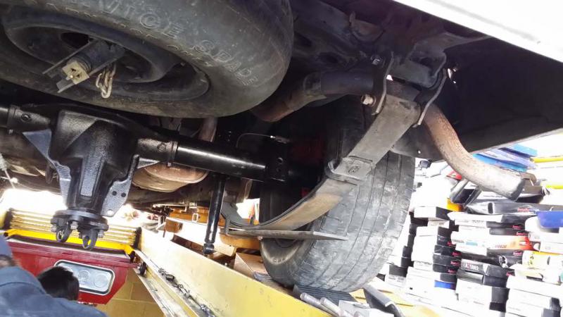

    First - get the old one out. The size difference between these two is very VERY clear The 8.8 just barely fits..
    Merrill Performance Ford Explorer 8.8 swap in a Mitsubishi Mighty Max (3).jpgMerrill Performance Ford Explorer 8.8 swap in a Mitsubishi Mighty Max (11).jpgMerrill Performance Ford Explorer 8.8 swap in a Mitsubishi Mighty Max (12).jpg
    Then roll the 8.8 in and mount it all up in place
    Merrill Performance Ford Explorer 8.8 swap in a Mitsubishi Mighty Max (14).jpgMerrill Performance Ford Explorer 8.8 swap in a Mitsubishi Mighty Max (17).jpgMerrill Performance Ford Explorer 8.8 swap in a Mitsubishi Mighty Max (22).jpg

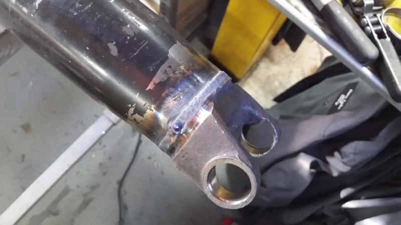

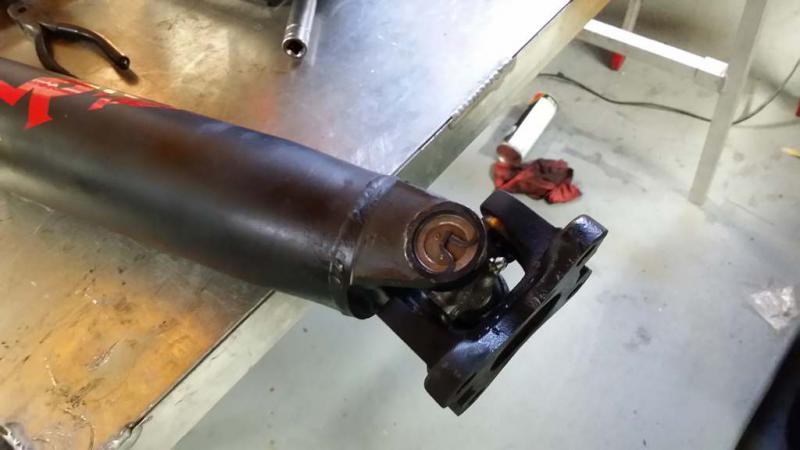

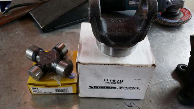

    There are a few yoke options, but these are the new pars I used. I don't see a need for rebuilding an entire rear end, but using used parts for the drive shaft.
    Spicer U1670 weld yoke for a 3" drive shaft tube.
    This a Ford 9" yoke, so you need a hybrid Ujoint to fit to the Ford 8.8 Spicer yoke.
    The Ujoint part number is 348. I used Precision for the brand, but there are many brands to use.
    Merrill Performance Ford Explorer 8.8 swap in a Mitsubishi Mighty Max (23).jpg

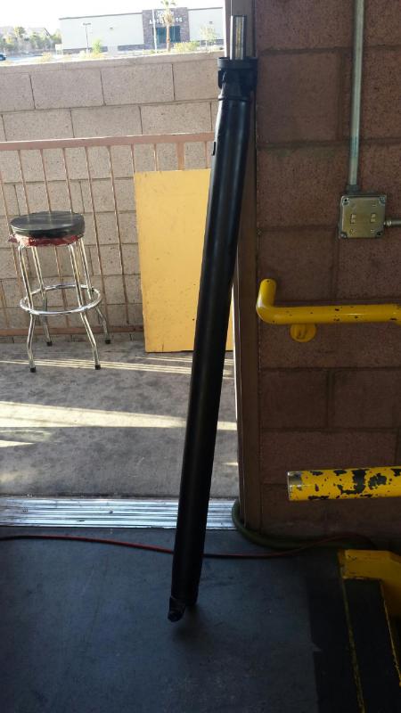

    Drive shaft mods are very simple. You can either send it out to a drive line specialist, or use a series of specialty tools to correctly measure the yoke for welding in straight. Cut the old yoke off, weld the new one on, paint it. If you need to send it out to get balanced (recommended), do it.
    Merrill Performance Ford Explorer 8.8 swap in a Mitsubishi Mighty Max (47).jpgMerrill Performance Ford Explorer 8.8 swap in a Mitsubishi Mighty Max (24).jpgMerrill Performance Ford Explorer 8.8 swap in a Mitsubishi Mighty Max (30).jpgMerrill Performance Ford Explorer 8.8 swap in a Mitsubishi Mighty Max (48).jpgMerrill Performance Ford Explorer 8.8 swap in a Mitsubishi Mighty Max (49).jpg
    Even though it will pretty much never be seen, my friends decided a "Merrill Performance Custom Drive Shaft" needed to be announced. Personally, I think it looks awesome! I'm glad they talked me into it.
    Merrill Performance Ford Explorer 8.8 swap in a Mitsubishi Mighty Max (31).jpgMerrill Performance Ford Explorer 8.8 swap in a Mitsubishi Mighty Max (38).jpg

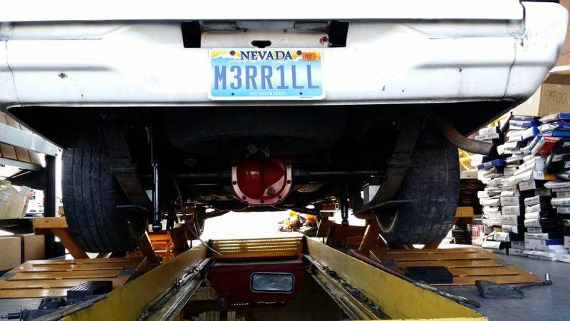

    This is the final - all fitted and adapted to the Mighty Max
    Merrill Performance Ford Explorer 8.8 swap in a Mitsubishi Mighty Max (39).jpgMerrill Performance Ford Explorer 8.8 swap in a Mitsubishi Mighty Max (43).jpgMerrill Performance Ford Explorer 8.8 swap in a Mitsubishi Mighty Max (44).jpgMerrill Performance Ford Explorer 8.8 swap in a Mitsubishi Mighty Max (45).jpg
    For lack of a better word - this truck just got stupid. I can't even begin to describe how insane it is. Equal power, breaks loose with the tap of this little 8 valve (no bullshit), solid pulls.... The list goes on.
    I went from 3:9 gears to 3:73's and it takes so little to get these wheels cooking. I was in such a toss up about the gears I have or going with 4:10's, but I think I wouldn't be able to accelerate
    In all honesty, I would seriously recommend this swap for the Mighty Max. The fact that it is ridiculously simple to do, parts are cheap and plentiful, both new and used. It is so easy to do, it would be foolish to pass it up.
    With any luck, I'll have the big brakes on next Sunday.
    This last pic shillin at the bottom is one I want to be seen. This is the one piece that allows the 8.8 3/16 flare brake line bolt up to the 10mm Mighty Max line. Just cut one end off and re-flare the line with a 3/16 male fitting. One side fits the Mitsu, the other side fits the Ford.
    Questions or comments welcome.

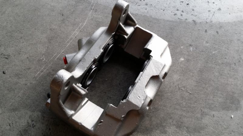

    I'm enjoying it so far. I do have a brake issue, but I will solve that once I swap the 314mm fronts. I don't want to keep bleeding the system out. I'm going to ditch that rear proportioning valve and hook up the hand brake. I swapped to the 1 1/16" master cylinder already, but I have a brake line that has a tiny leak, so I can't maintain pressure.
    One of my calipers arrived today. The other will be in tomorrow, and the brakes Thursday. That leaves me Friday and Saturday to buy tires for my wheels and get the front brackets fabricated. Should be a breeze.

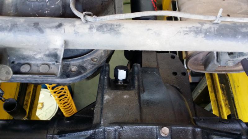

    I also have to notch the rear cross member above the axle. Since the 8.8 has a ABS sensor in it, they casted a guard to surround it. I tossed the sensor and added a -10 return for the diff cooler. The casting smacks the cross member on a big bump. It's a quick fix at least...

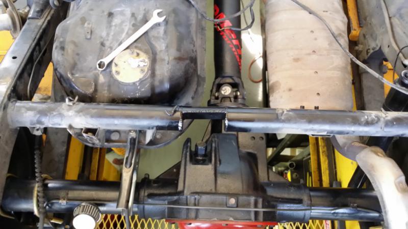

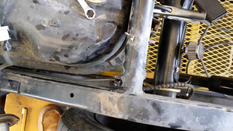

    Today I made the notch in my rear crossmember to clear the housing. I'll get pics up soon...

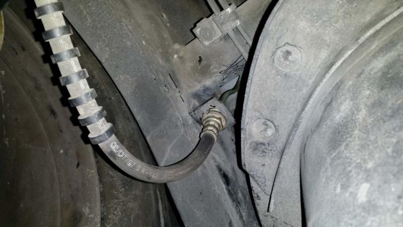

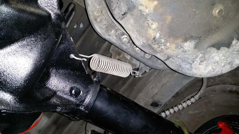

    I also finally hooked up the hand brake and tossed the rear proportioning valve as well as made some additional plumbing changes. Only problem I have now is my pedal takes 2 pumps to stop me. Even with the biggest Mitsubishi BMC I can find, it still doesn't push enough volume to keep this system up. I ordered a residual check valve today, so that should fix it. With these big ass rear calipers, and additional plumbing (hand brake and such), there just isn't enough volume to fill it all up in one pump

    Here we go!
    This is the quick fix notch I made to the rear crossmember until I build the rest of the chassis (this crossmember wont even be there). If you are dropped in the rear with this same rear end, you'll need to do this too.
    Not my best work by any means - just a quick and easy... My G.A.F. factor is low on it since it wont stay this way for ever. All it has to do is hold (which it will).

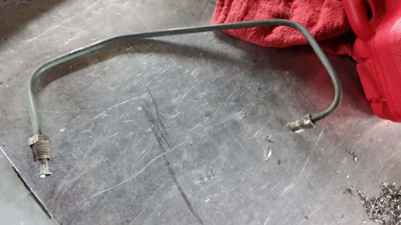

    Since I added an adjustable proportioning valve, I tossed the Mitsu one that was on the back. Now its all clean and simple with a single line
    Speaking of brakes - they are SO CLOSE to being installed. Today I managed to find time enough to fab brackets for the calipers.
    Here are some shots...

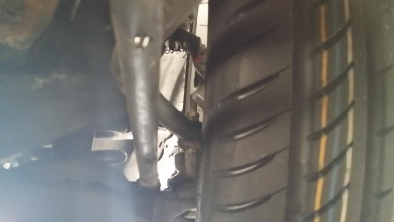

    As most of us that have ever done our own brakes, or had our wheels off, the factory Mighty Max calipers are rear mounted. There is no room what so ever to make a bracket for these calipers to fit in the same place, so they had to be relocated to the front (just like the VR-4). Only trouble is the suspension and steering is very different between the two vehicles lol. This truck has twice the control arms, 4 times the steering components, and even a few additional parts that don't exist on the VR-4. That being said - there is little room for error. Truth be told, I had to make a bracket twice because I "missed" on the first measurement.
    The first bracket would allow the caliper to contact the sway bar before lock. There is no way in hell I will tolerate that, so I had to remake the brackets but clocked them to rotate the caliper clock-wise. Now the calipers are free and clear of everything and sit perfectly above the sway bar.

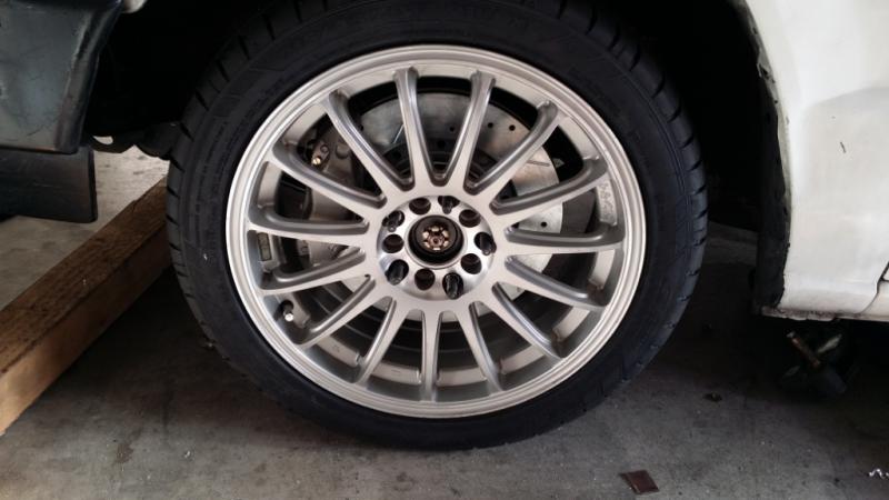

    I did have to recess the center bore for hub clearance, but I decided to make them nice with a fillet edge.
    I'll do the finish work on these tomorrow. This was just "mowing it down" to get it shaped. It was a long day.

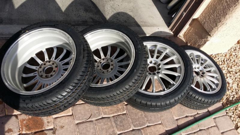

    Amazingly, those junk yard wheels I recently purchased, cleaned up very nicely! I was truly surprised after I gave them a wash down. Also wrapped them up in some cheap new rubbers (for the summer).
    Pretty good fitment.... I was going to paint them (still will at some point) - but a buddy of mine talked me into rolling like this for a minute before painting them.

    The wheels look GREAT oh and the real size of that rotor upgrade is finally seen through the wheel..."IT"S HUGE"

    The front rotors are from a VR-4. The center has been bored to 86.1mm to slide over the Tacoma hub. They are now front mounted just like the VR-4 is. Brackets take about 20 minutes to make if you have the tools. I used my band saw and drill press to do these. The machine work took a few extra minutes, but not every design needs machining.
