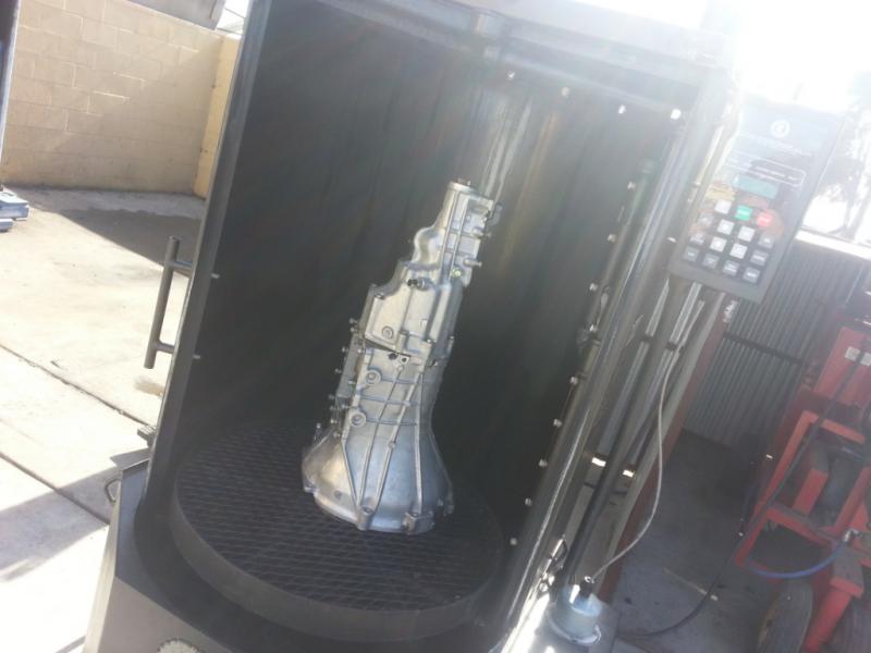

    After getting them back to the shop, I tossed them in the washer for tear down and inspection
    Now, for the life of me, I couldn't figure out why an extremely clean looking (internally) engine ended up in the yard. I didn't see a any holes in the block, no signs of a collision, and everything was straight and normal. I figured I just scored. After tearing down the transmission, I found out that the first gear synchro grenaded the shaft collar in addition to cracking off about half of first gear. That's why it was in the yard. Oh well.... I'll rebuild it eventually. The interesting thing is the Model number has the same coding as some of the DSM transaxles =, so maybe I can put together a custom gear set for it. I'll mess with it later.

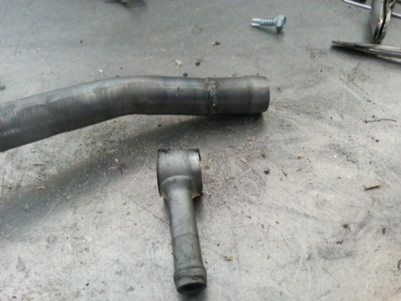

    If you look at the mock-up pic on the left, you'll notice the 2 tubes leading around the back for the heater. Notice the top tube runs right up to the outlet of the head. This will have to be modified to fit better (for me). The tube wrapping around the back pops out on the other side and has a port for the throttle body thermal valve. I don't need a functioning thermal valve for cold idle, so it will be deleted.
    This is how I did it:
    Here is what they look like for fitting to the Montero Sport
    All I did was rotate the right side 90 degrees, and cut out the left side
    Here it is complete and ready for a fit check
    That's one problem solved.

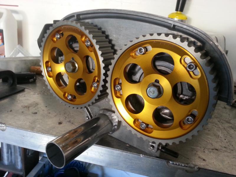

    Next up is the issue of this being a FWD engine, and I am mounting it to a RWD block. The Montero Sport has its thermostat located on the lower radiator hose/inlet tube, and the Hyundai's thermostat is located on the back side of the head. I don't need 2 thermostats, and I really don't want to run a water pipe to the back of the engine, so I decided to delete the rear housing.
    This engine still needs an outlet for coolant and a place to install an upper radiator hose. The fine folks at Mitsubishi conveniently located a freeze plug right at the front of the head so there will be my exit. Very simple - pop the freeze plug out, and add a 1.5" aluminum tube.
    Once I get it in the truck, I will trim it down and build some stainless hard hoses for the cooling system.

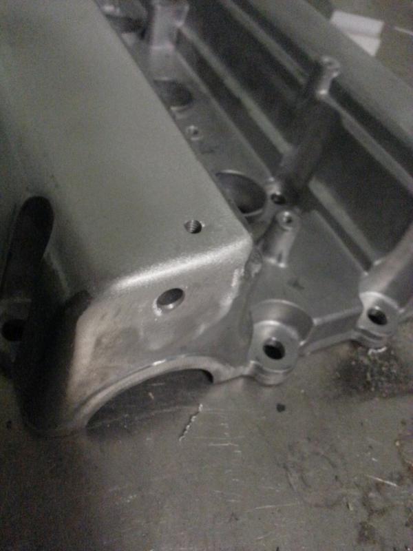

    Next up is the valve cover. I personally love the look of exposed gears and belt. The timing covers are not the same, so I won't be using it. I also need to modify the ventilation system to accept one of our catch cans. Seeing "DOHC 16 Valve" on the valve cover is cool, but pointless. If you pop the hood and see 2 bright gold cam gears, it's obviously a DOHC lol. First I had to weld the factory PCV and Vent holes shut. I also got rid of a screw hole I don't need while I was at it.
    After a soak in the hot tank to remove the factory coating, I took a grinder to the lettering
    Next is the mounting tabs for the upper timing cover
    Then a couple welds followed by smoothing
    Then a quick sand blast to clean it all up
    I shot it with a coat of primer after that. Once I get the engine assembled I will add the new fittings for the ventilation system and give it the final coating. That pretty much wraps up the head Mock-up.
