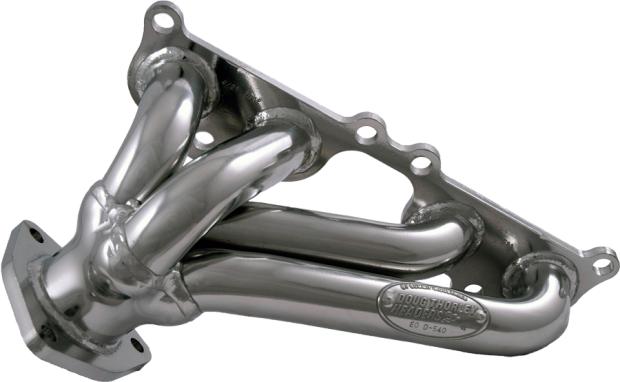

Here are a couple examples of Tri-Header designs for those wondering what a Tri-Y header might look like.
Out here in Cali you can't use after market parts without a CARB number. To get one would cost around $500,000 so that's not going to happen. I can't afford that.
This thing is based off the Doug Throughley header. It's a direct copy.

are the pipes equal length, I hoped for something prettier I guess, but they look workable.
Wondering about pulse collisions with unequal lengths/
Ragragtime that looks amazing.... I will be ordering one of these soon for the g63b.
RRTT's headers are old school. They are some beautifully made and finished headers but I doubt you'll be finding a set of those gems in a hurry...I share Brads observations on the new design headers. I would think having #1 exhaust runner being that much longer will force the engine to pull more torque from that cylinder (might make it sound like a WRX - could be a good or bad thing depending on your allegiances)
wow, just wow,
looks to me like the chrome purdy header does not have equal length
tubes either (look close now)but hey its chrome !!!... & long tube v/s short tube--- apples and oranges ---.
This is not for our trucks but it sure looks the same. This is a brand new DT shorty.
