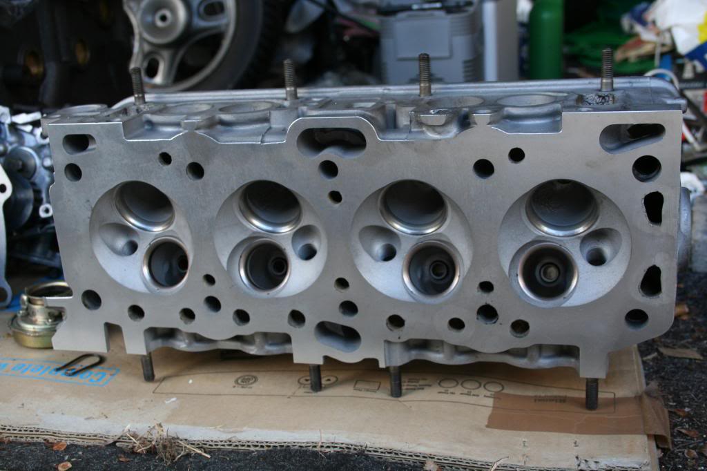

    Ouch Royster, those spiders need somewhere nice to live I've been doing all the background stuff that nobody sees unless they have been checking my other posts. My block is ready for hot tanking round 2 from grinding out and polishing the crank case walls, buttresses and oil return journals. My inlet manifold is now a bathtub as a result of mods needed to accommodate the obscure 34DATA 4/100 C8 Weber I salvaged from a twin cam Lancia Beta 2000 and I'm hunting down a few parts to reconfigure the air con, upgrade the front brakes and find a decent oil pump (that won't cost me $280-660 AUD). I'm going to have a shot at balancing my own rod and piston assemblies over the Christmas break too.

    ~insert super facepalm here~ Yeah, I know. This is one long winded process that has endured roadblock after roadblock, changes in direction and cash flow issues. If I could just 'throw cash at it' then this would be a done deal and I'd be motoring along by now nicely (but I ain't got no cash!). My head was trash and I wanted another mechanical head - couldn't get one. So I extensively reworked what I had (fingers crossed it pays off). Making it work required some serious port finishing that I couldn't afford so I used what I'd learned on previous engines and raised the level (plus the cam journal caps were shredded so I used one very dubious method to repair them ) .
    I could've left the EGR crap alone but I knew this would hinder getting it to run as smoothly as I wanted so I went the whole 9 and completely deleted it from the inlet manifold and sealed the EGR gallery in the head (I did a similar job on my G32B powered Celeste and it ran sooo much smoother) And then the carb. Previous idiot cleaned the base gasket it off it with the garage floor - yep, it's junk. This idiot buys a good clean Mikuni from a wrecker, then finds a Weber a few months later...
