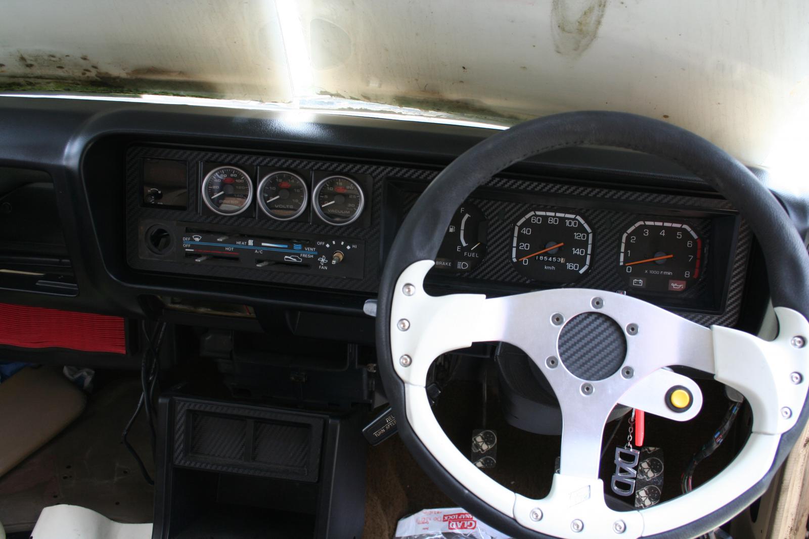

    Haven't really updated this thread of late so I thought I'd add a pic...(it's probably in a link from my PB account but I'm done with photobucket holding my property to ransom)
    I've been getting my bargain hound on and hitting ebay for replacement harness sockets, headlight wiring harness upgrades, gas hood struts, a 5" monitor with dual cameras and a 6 switch induction panel. So far the main focus of my work has been on the truck wiring. It had a dealership A/C fitted but all of the harness sockets had perished and the relays themselves were originally anchored to the engine bay frame channel and had broken apart. I've bundled them into an aftermarket relay block with an accessory headlight harness and the engine cooling thermofan so all of the systems are protected in one case.
