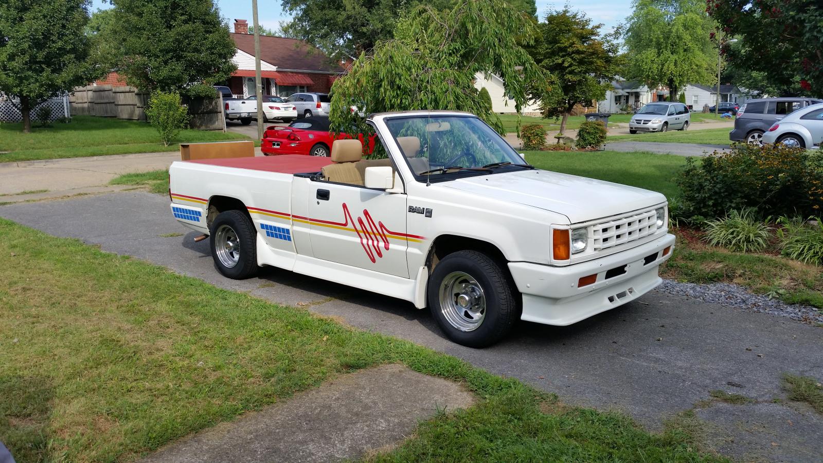

    Hello all, I just inherited from my late uncle his 89 Ram 50 Convertible. It's a 2.0L G63B 5 speed. He's had it for a long time but only put 78k miles on it. He had stopped driving it sometime around 2006 and it has just sat first in his driveway then garage (thank god he finally got it sheltered). It's time outside lead the vinyl top to fall apart so I'll have to find somewhere to get that remade. He was also rear-ended sometime in the late 90's so the back is dented in a bit and I have no clue what he did with the ground effects that was on it. Otherwise its in pretty good shape with only a bit of wear and tear to clean up. The engine still cranks but won't fire so it seems the fuel system is clogged so that will be my first big fix. Fires right up with some ether in the carb though. This is my first time restoring a car/truck so I look forward to the adventure of it. I'll try and post pictures along the way.
    Not many convertible trucks around so I can't wait to get it up and cruising around town!

    Is that an old picture? I have a full set of ground effects that will fit your truck if yours are missing.

    Wow, time flies, can't believe its been 2 years since I posted this up. I've not worked on the truck as much as I should have in that time but it is not finally back on the road! Not a lot visually has been done but it's running better than I imagined it would. Work so far as been:
    • New plugs/wires
    • New oil/filter
    • New belts
    • New battery
    • New fuel pump/filter
    • New carb (replaced with factory Mikuni 32-25)
    • Cleared fuel line and drained bad fuel
    • New tires
    • New brake pads
    • 8-ball on the shifter
    I could have just reused the old carb but after cleaning it out and trying to rebuild it I still needed a new diaphram spring that apprently NO ONE can provide. All the kits come with everything but this spring. Ended up spending $280 because no one could supply me with a $3 spring...
    Still to be done:
    • New top
    • New cover on bed to match the top
    • Repair damage on rear
    • New taillight
    • New paint (thinking black with tan top and bed cover or Smokey Gray with Orange top and cover as I'm a TN Vols fan)
    • If I can find a matching skirt for the rear then I'll replace that
    • New stereo and speakers (The deck in it currently has a loose connection and goes in and out. Also only have 1 working speaker)
    Not sure what else I'll do but that's what I've got on my mind so far. It's been a real head turner already in its current state so I'm having a blast with it. Below is the link to the pic album of my progress so far.
    Do you still have the ground effects?

    Hey, agreed, glad to see it make it back on the boards as well. I hate that I was not able to complete the restore but time and means got away from me. I only sold this about a month ago so I guess he wasn't as interested in restoring it as I thought. I'm glad it at least made it to someone who is excited to finish it out. I look forward to seeing your progress.
