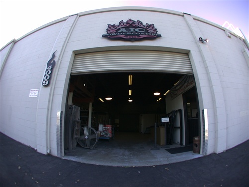

    Ceramic & Powder Coating
    Today we are going to cover Ceramic coatings on an exhaust system.
    As the majority of you mechanics know that the exhaust is one of the worst things to work on. It is rusted and will not come apart no matter what you use. It’s just something we all hate. But there is a way to make it last for years. Ceramic Coating can do just that.
    I used a place called AIC.
    And yes that is me in the video on the front page. You can read more about Ceramic Coating and Powder Coating on their site. http://www.amerikotecoatings.com I had them Ceramic Coat my exhaust system. Since I was going to wrap the exhaust, I wanted to protect the headers and pipes as best as I could. AIC coats everything, from the fence to sprint car frames.
    The first step is to sand blast your parts.
    Next they will bake all the moisture out of the part. After the first bake they coat the part. Ceramic is a liquid that is sprayed on using a HVLP gun.
    Then the parts are baked one more time. They can even make the finish have a gloss look to it. Powder Coating is a dry coat that is electro static and uses a special gun to charge the powder. It is also a thicker coating then Ceramic.
    If you get something coated do your self a favor, look at the colors they have available. The guys that work with your parts are board of the color Black. They see it all the time and will tell you the same thing. There is more then one color in the world, and we are sick of black.

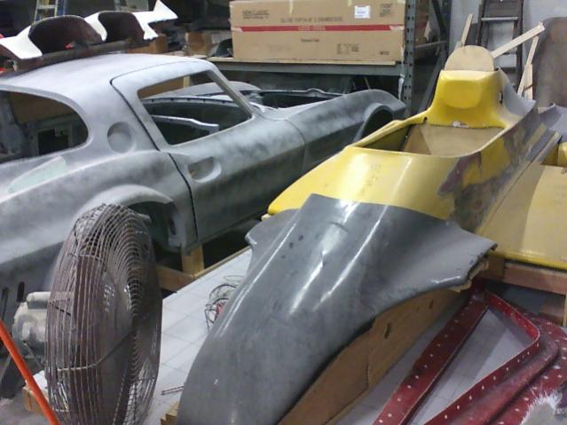

    The Fiberglass shop.
    I found a fiberglass guy that was willing to work with me. This guy has a crap load of body molds. Corvette, GT, Formula 1, Pro Stock, you name it. He has Formula 1 McClaren molds from McClaren them selves, from there first car, to the car of tomorrow (Shhhh). They are sending him the plywood shapes. Once I get a picture of it then you will see how to do a mold the right way. All I could say was Holey crap. It's nothing like you think..
    A Formula 1 wing,,, just the wing, not the mounting or anything will run you around $12000.00 just for 1 part. The process will be detailed later on in the build. It involves a Auto Clave type thing, and some large press type equipment.

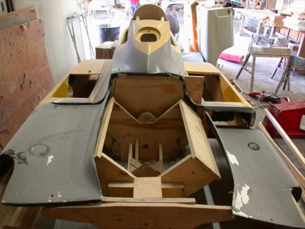

    One of a kind, Composite Bodies
    Lets dive into the world of composite bodies. The man I found to build the body has been building composite bodies for years.
    Jeff currently has all but 3 F1 McClaren molds from the McClaren factory. He is expecting a prototype mold to arrive soon. I’ll get some pictures when it comes in. His main focus is in racing from the F1 to the GT car bodies.
    The first thing was to shorten the rear bedsides by 12 inches off the back end and build an under structure. Next was to cut the wheel opening to match the front.
    The front fenders and hood was welded together and a full under structure was built to hold the form of the stock shape. Next was to cover the whole thing with 10Lb foam. Then rough cut and sand to shape.
    When building the plug, it is important to avoid sharp edges. If the plug has sharp edges then you may have problems with the first covering of fiberglass when making the hard shell. If the edges are to sharp then the glass can bunch up and not lay flat where you want it.
    Next is to fill the large air pockets on the foam with some bondo. This will reduce the possibility of the mold generating air pockets from heat.
    I plan on having louvers in the hood. They will be cut into the part after it is built. It’s easier to cut them in later because they take so much time. When working with the resin and fabric you need to keep things moving and not stop.
    The louver plugs are from a Chevy Camaro.
    Next up will be the building of the mold and the final body work.

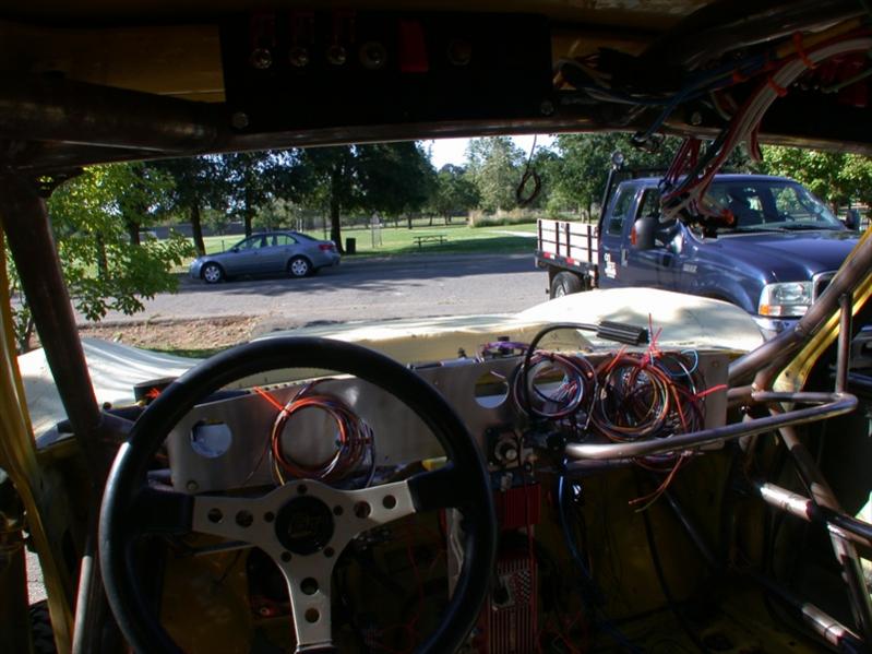

    Electrical System is Done..
    I just finished up the wiring. After 6 months it is finally finished and tested. I would work on it here and there when I received the parts. The final part that was holding me up was the intercom system.
    Before and after pictures. Main board before the clean up.
    Wiring harness before the final clean up, and after. Now it looks like a real harness.

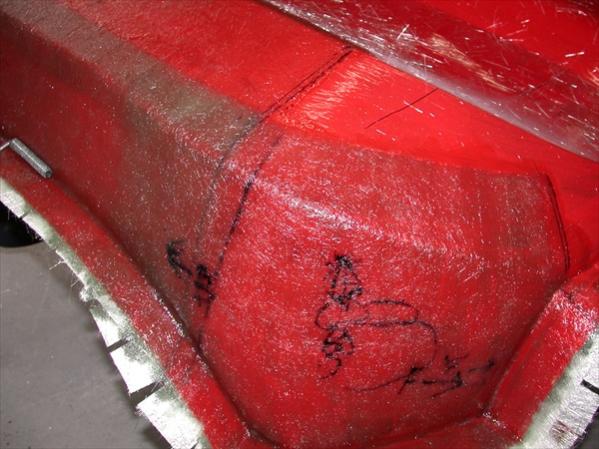

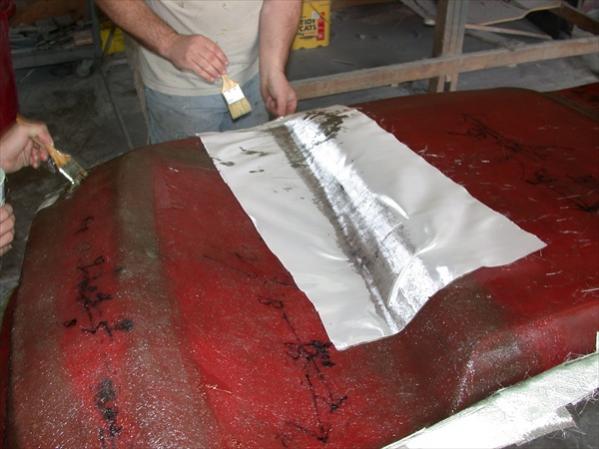

    Building the class A mold part 2
    How to build the mold.
    The very first and most important thing is to wax everything. And I mean everything including the paper you will use for the flang of the mold. Use the correct wax Partall Paste #2 Release Wax is the recommended wax. Then over the top of that you apply a coating Partall #10 Release PVA Film.
    Next is to mark and cut the flange paper. It’s a good quality smooth card stock. You can get it for free if you hit up the local print shops around town. They normally just toss out the scraps, so it’s in your favor to ask them about getting the leftovers. Mark the paper with a marker and cut to fit. Make the fit as tight as you can.
    Things to look for when determining how and where to put a flange. The first thing is to look for is what is called a “Lock Up” This is a place the where the plug turns back on it’s self. Take a look at the front fender of your truck. The lock up area starts near the bottom. If you were to just cover the hole thing with glass and resin the plug would never come out of the mold, so you make a flange near that area out of the card stock. Keep in mind you want the plug to come out of the mold as easy as it can.
    Once you have the plug flanged completely it is now ready for the tooling gel coat. You can spray or brush it on; it’s up to you. Cover only the plug and flanges within the first area you plan to work. This is the area before the lock up. Allow the tooling gel coat to dry over night.
    NOTE; Pre fit everything.
    Now you can start the fiberglass lay out.
    Look out for tight areas where material can bunch up. Make as many relief cuts as necessary to allow the fiberglass to lie down on the plug and go over sharp bends and around corners.
    Use as large of a peace of glass as necessary to cover an area. Don’t try to cover the whole thing in one try. This would cause the material to pull away from the areas you have already covered earlier. The stranded fiberglass mat is not as flexible as the glass cloth you will use later on. The mold will get a total of 4 layers of fiberglass, 2 of the multi directional mat and 2 layers of cloth.
    Now you can apply the first the resin coat over the gel coat. Work in small areas so you can keep the areas wet. If you take too long on one area then you run the risk of the resin drying on you. Work fast you have about 45 minutes if the air tempters under 65 deg. Now you can stick on the first layer of mating.
    Then cover it with more resin pushing the mating down around the corners and edges. It’s best to have 2 people if working large parts. One person applying the resin and matting while the other works the roller removing air bubbles and working the matting into the corners.
    Overlap the matting about 1 inch. It should overlap like shuffling a deck of cards. Once you have worked back to the peace you started with you can start the application of the second layer of matting. Then more resin, and more rolling. Once you have covered and rolled the whole area including the flanges with the 2 layers of matting you can now apply 2 layers of cloth. It will be the same process but you should not need as much resin. Remember be careful when rolling not to pull the material. The cloth should not need as many relief cuts if any. It is more flexible and now the sharp corners are covered the whole thing is thicker and flatter. Work fast keeping things moving forward. The 2 layers of cloth go right down just as soon as you have covered the area with the matting. No stopping, no breaks, just go, go, go.
