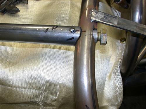

    At the same time I built the removable cross beam that stops the upper shock towers from moving. I used a ¾” bolt. I welded the nut inside of the cross bar. Then used a peace of 1” X ¼” wall DOM tubing. This gives me a tight fit for the bolt and a way to keep from crushing the shock tower tubing.

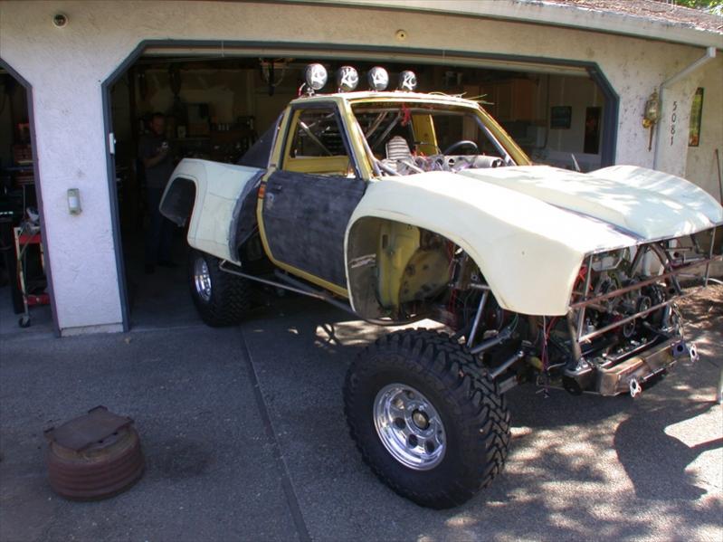

    Body Test Fitting.
    Today I test fit the new body mold. Now you can see the shape of the hole truck. The front end will be cut from the cowling at a 45 degree angle to the fender. Soon it will be time to start the fiberglass. Once the foam is ready it will be covered with a fiberglass twill and resin. Then it will get bondo shaped then a full paint job. The better the finish of the plug the better the finish of the final part, but I'll get into that when the molds are started.
    Here are some pictures for you to look at. I want to keep the square look of the 80s, styling of the truck.
    The rear bed sides have been shortened by 12 inches, flared and cut to match the front end wheel clearance. You can also see the rear protection panel.
    This is the Point Of View from the driver seat.
