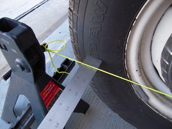

    Next, set up some stands at the front and rear with string parrallel to the rockers, up close, but not touching the tires, level front to rear.
    I measure off the pinch weld with a very good rule to make the string absolutely parallel to the rockers.
    Once the strings are true, you are at a great place to check the rear axle. Mine was 1/8" to the passenger side. Acceptable.
    Now set the toe, measuring off the tire fore and aft of the spindle, just as you did on the rear tires. Setting toe is as much about the method as it is the number. The toe plates are crucial here. Begin by setting the steering wheel straight ahead. Remember that there is slack in the steering. You want equal amounts on either side of center when you do this. Now measure, then adjust. Before measuring again, you need to recenter the steering wheel. My wife came in very handy for this. Double check everything before you tighten the tie-rod sleeves back down. You should be able to reach them without jacking the car up. If not, it can wait until you finish caster and camber work. My measurements when finished had the tire off the string by 9/16" aft & 11/16" forward for 1/4" toe-in. Remember that this is a very dated way to measure toe. Today they speak in degrees. On my wheel diameter, this is less than 1 degree. 12" from the spindle, 1/4" is about 1 degree.

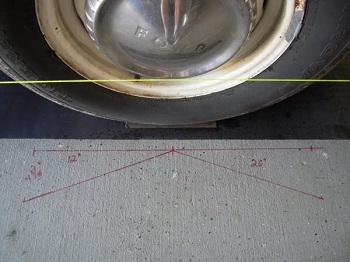

    Now comes the fun part, Caster, and this is why we need a digital level. You can buy fancy Caster/Camber guages that do the math for you, but I'll show you what they don't want you to know. (I got lucky and found one that spelled it out )
    Draw a K on the floor. The back needs to run 12" fore and aft of the spindle centerline and be exactly parallel to the strings set up earlier. You didn't bump them, did you? The legs of the K need to be at 20* off the back. This will be 4 3/8" out at 12" from center.
    Now the fancy guages are particular about the order you measure. My method is not. My method presumes that you have positive Caster where the fancy tool will detect negative Caster by their paticular order of measuring. The math is simple. Turn the wheels 20* to one side, measure Camber (#1), record how far from 90*, turn wheels 20* in the opposite direction and measure Camber again (#2), record how far from 90*, Add #1 to #2 and multiply the sum by 1.5 to get your Caster reading. In this process, the 20* to each side and the 1.5 multiplier are very specific and related. Change these and the math goes into land of the lost. You will have to ask your kids Trigonometry teacher why this works. I get it, but I ain't explaining it!
    So here we go, turn wheels 20* one way (use the K you drew on the floor to eye ball it carefully) and measure Camber, again, the level MUST be truely vertical.
    Turn the other way and measure again...
