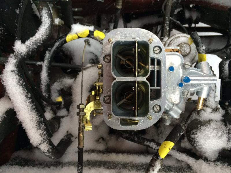

1. Throttle cable hook-up: I'm a little confused here. The instructions show a 'throttle cable bracket' that should hold the throttle cable in place, but I don't see anything in my parts that looks like the picture in the instructions. The only thing close to what I see in the instructions is the lever/arm shown in the image below. I remember reading something on this forum about certain models of these carbs relocating the throttle cable to the front of the carb (closest to the front of the truck rather than the firewall) - is that what I am supposed to do?

2.Adapter plates: This probably goes hand-in-hand with my first question. Does this look like it's backwards? The instructions state, "...Install the universal adaptor noting the position of the carb for the cable operation". I assumed that since the throttle cable was near the back of the carb, the arm for the throttle cable on the adaptor plate should be closest to the firewall, no?
