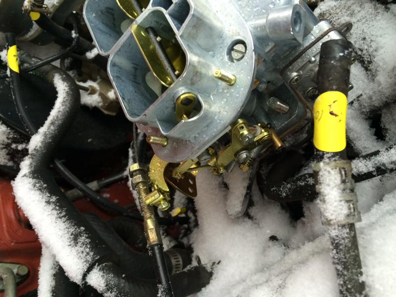

    1. Throttle cable hook-up: I'm a little confused here. The instructions show a 'throttle cable bracket' that should hold the throttle cable in place, but I don't see anything in my parts that looks like the picture in the instructions. The only thing close to what I see in the instructions is the lever/arm shown in the image below. I remember reading something on this forum about certain models of these carbs relocating the throttle cable to the front of the carb (closest to the front of the truck rather than the firewall) - is that what I am supposed to do?
    2.Adapter plates: This probably goes hand-in-hand with my first question. Does this look like it's backwards? The instructions state, "...Install the universal adaptor noting the position of the carb for the cable operation". I assumed that since the throttle cable was near the back of the carb, the arm for the throttle cable on the adaptor plate should be closest to the firewall, no?

    The adaptor plate on the manifold is on backward - leg on the upper plate goes to outside of the manifold, just flip it 180. The bracket in the second pic goes on the valve cover, and the old cable mount that bolted onto the valve cover bolts on that bracket. That means you have to rotate the carb 180 to put the linkage to the front of the carb towards the rad. There should be a piece that has a hole with a nut that the cable goes through - you have to cut the lead end off that went into the old bracket to feed the cable into the fitting. Next time put a tarp over you and the truck so you don't get that snowed in feeling while you work...
    Ahhhh, that seems to make sense! Not seeing any piece that has a hole w/ nut for the cable to go through though - assuming this should be a part from the new kit, right?

    in pic #6 - there is the bracket with the holes in it - that is where the cable adaptor goes, and the return spring hooks to.
    oh my look at the snow, lol. Throw a towel over that thing. When you connect the vacuum to the dizzy, it will be the ported connection in this image. You will most likely have to remove the tiny screw and block the other one next to it.
    Use the one most forward on the carb.

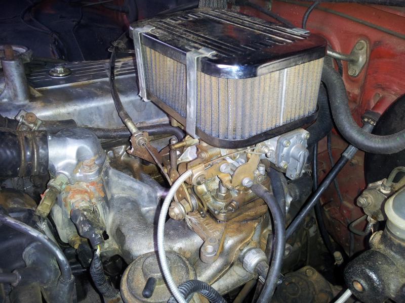

    Here's another kit I found that is very similar to mine, but he has the throttle cable bracket.

    Here's a few pics of where I'm at today. Still confused about this throttle cable reposition, it appears to me that the throttle cable bracket is needed or I have the 'boomerang' hooked up incorrectly (which is totally possible). Using the boomerang alone - I'm not seeing any way the throttle cable will properly feed to the mounting bracket on the carb (with all the holes in it). the cable is way too close to the air filter and comes in at an angle. See pics..
    1.
    2.
    3.
    Any insight is greatly appreciated!
    I took my stock carb apart. Then tack welded the half round Cable connection doohickey to my Weber. This way The throttle actually rolls open

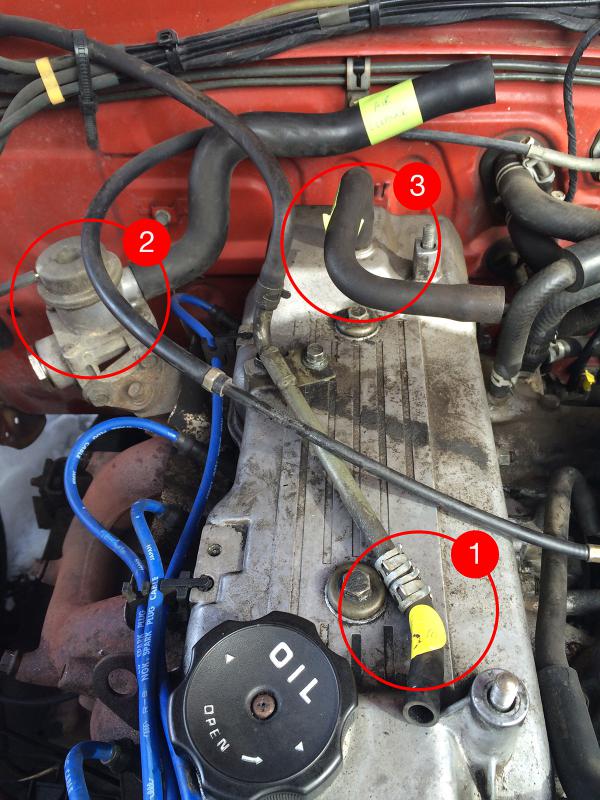

    However, I could use a little help/advice. I've got the new carb in place but I'm a little confused as to what goes where when hooking everything back up - my apologies for being amateur hour! Here's what I'm looking for some help with:
    1 & 2 (circled in red) - Just want to confirm that these can both be removed
    3 (circled in red) - This either needs to run into the plastic inlet on the bottom of the new air filter or put a breather on it, correct?
    Attachment 13275
    The 2.6 is different but you are referring to crankcase ventilation I think. The hose goes from the valve cover to the base of the air filter, yes.

    Hard to tell from the picks, but if it is a nipple on the intake, it gets plugged off. The factory carb was heated by engine coolant, but the Weber is not. It has to be plugged.
