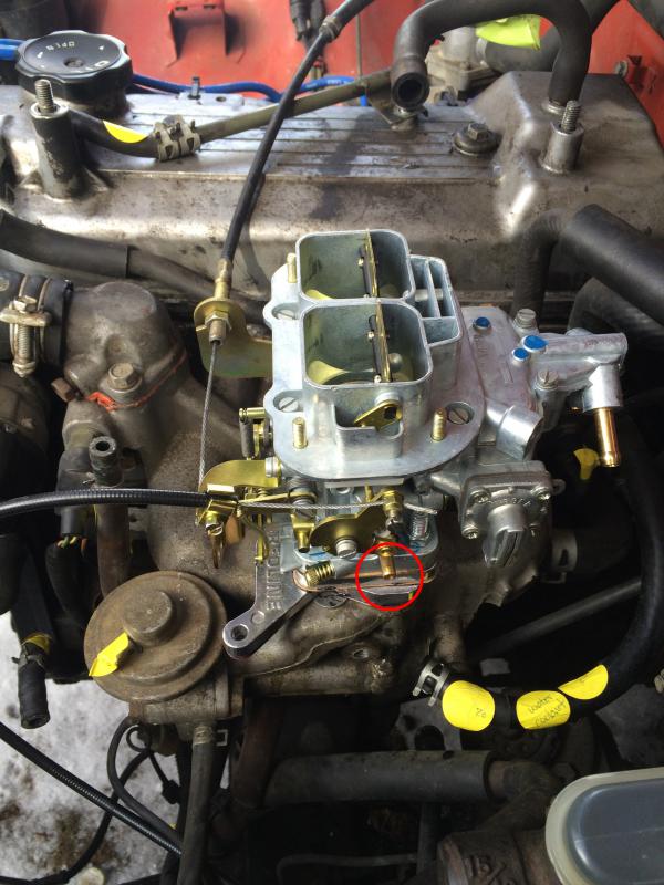

However, I could use a little help/advice. I've got the new carb in place but I'm a little confused as to what goes where when hooking everything back up - my apologies for being amateur hour! Here's what I'm looking for some help with:
1 & 2 (circled in red) - Just want to confirm that these can both be removed
3 (circled in red) - This either needs to run into the plastic inlet on the bottom of the new air filter or put a breather on it, correct?
Attachment 13275
The 2.6 is different but you are referring to crankcase ventilation I think. The hose goes from the valve cover to the base of the air filter, yes.

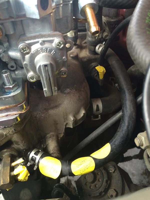

4. This definitely looks like coolant but I'm not sure where it hooks back up to the new carb? Maybe nipple in pic#6?

6. What gets hooked up to this nipple (circled in red)?
Run a rubber vacuum line to the distributor vacuum advance. That's what that port is for.
Hard to tell from the picks, but if it is a nipple on the intake, it gets plugged off. The factory carb was heated by engine coolant, but the Weber is not. It has to be plugged.
