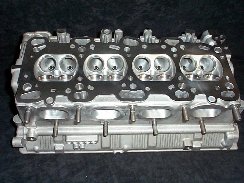

    Cylinder Heads
    Cylinder heads carry a similar manufacturing variation as the blocks. There are obvious variations between single cam (SOHC), dual cam (DOHC), 8 valve, 16 valve, orientation, casting, etc. are all variations of the same 4G6X cylinder head family. This article is aimed at 16v DOHC specific cylinder heads of the 4G63 DSM and Evo variants.
    DSM
    DSM heads have a specific casting that matches the appropriate deck on the DSM block. The intake ports are the LEFT side of the engine while the exhaust ports are on the RIGHT. The bolt pattern for the head bolts are the same as any other 4G6X engine. There are 2 different intake port sizes to chose from (large or small port), and everyone likes to provide an opinion on which one is better.
    Evo
    Evo heads have a specific casting that matches the appropriate deck on the Evo block as well. The casting is NOT the same as the Evo head and is NOT compatible. The reason why will be explained later. The Evo intake ports are on the RIGHT side of the engine while the exhaust ports are on the LEFT. This is opposite of the DSM. The head bolt pattern is also the same for the 4G6X family.
    Hopefully you can see the differences between the two castings. Now we move to the fun stuff where we put all of this together!

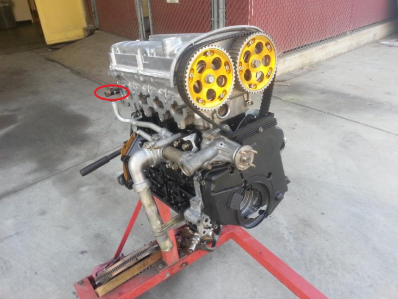

    Cooling system
    What if you don’t want to play Whack a Mole with your firewall? What if you can’t justify slicing up perfectly good sheet metal just to shoehorn an engine in? Why do you have to worry about this to begin with? - because on the back of every FWD head you will find the thermostat housing or coolant port. This is usually located in the center of the engine bay of a FWD car.
    For future reference, those of you who want to use the Hyundai/Kia head for your Evo variant build, the neck is in the same location.
    A solution exists from Mitsubishi. It is a solution they used to mount and does not require you to smash the hell out of your firewall or slice it up. The 97+ Montero Sport 4G64 engine uses a thermostat housing located on the right side of the block. This also has the return port for from the heater lines and back of the head for flow.
    Utilizing the Montero Sport coolant housing does require a couple mods to pass coolant back to the radiator. For starters, you need to add a port to the front of the head. DSM, Evo, Hyundai and Kia have a freeze plug located on the front of the head. You can pop the plug out and attach a pipe or hose adapter which will lead straight to the upper radiator.

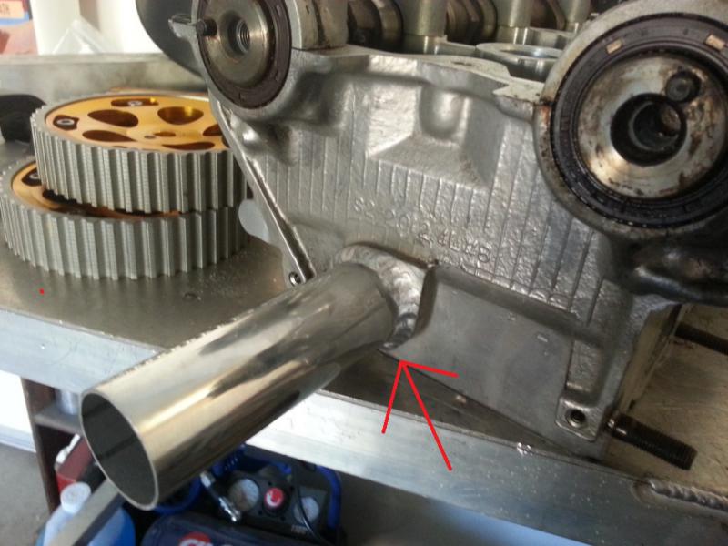

    The back of the head needs a modification as well. The port for the factory thermostat housing needs to be blocked off, but a hose barb/nipple needs to be added to feed the heater and a flow port needs to be added.
    The Evo, Hyundai and Kia heads have a coolant port already built into the right rear of the head. This port gets routed back to the Montero Sport thermostat housing via the water pipe on the assembly. You will need to either add a port to the block off plate to feed the heater, or tee the port off of the right rear port on the head.
    The DSM does NOT have this port built in. The solution is to tap a branch tee (or two separate fittings) into the block off plate. This will feed the heater and return coolant to the water pump.
    These mods will eliminate the need to smash up the firewall. These mods will also delete the need to run a water pipe to the back of the engine.
