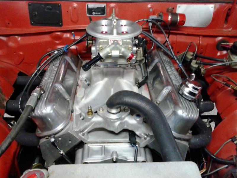

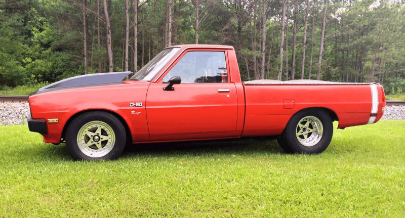

    I have a small block mopar in mine, 1973 with a 727 and 9 in. ford rear.

    ^badass truck! How did that work with the steering gear and linkage?

    Notched the frame 1 in. and moved it over.
