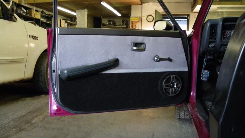

  6. #206
    Got 1 door panel completed today and picked up some speakers that will work for now.I'm missing the screw cover cap for the arm rest if anyone has one please let me know.
    door panel completed other then the arm rest cap.
    Turned out ok.
  7. #207
    What the hell you mean,, OK,, Looks dam good from here. At least there not brown or yellow with black stripes.

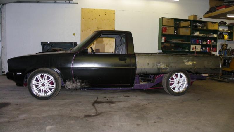

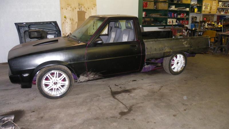

    Got a crap load done the last 2 days so all I have left is box repair,body work,priming and picking up the exhaust tips. Found out I need another 3 gallon air tank or maybe a 5 as the 3 gallon I have keeps needing to refill.
    Interior all done.(drivers seat out drying from cleaning it)
    Body all back together other then the box.

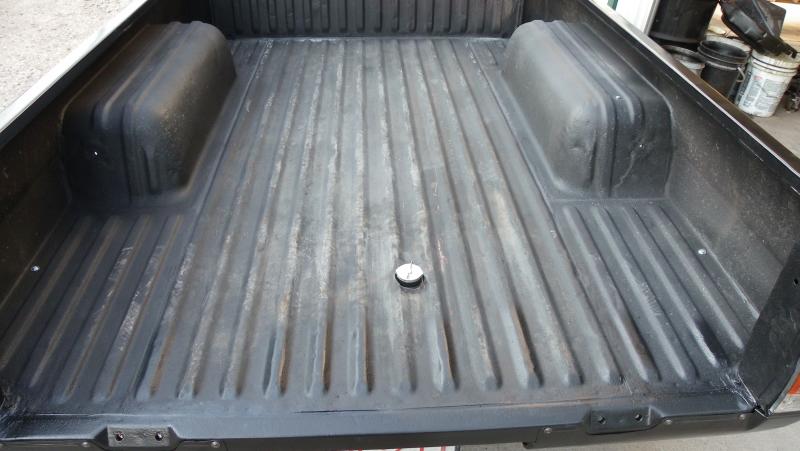

    Box rust repair COMPLETED!! Just have some holes to weld up on the bed rail and some body filler work and it will be ready for E-Coat. If everything goes good I should be driving it at the end of the week.
    Found a small air leak in one of the fittings so have to fix that tomorrow.

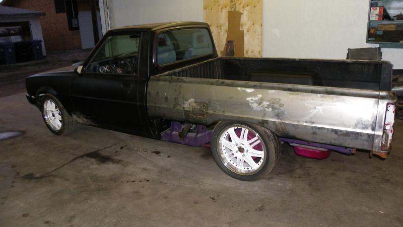

    Dropped the box on tonight to cut the hole for the gas tank filler.Here's a few pic's
    you can see where the exhaust will dump.

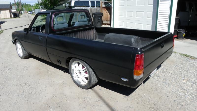

    Finally on the road.Have to finish the front lower box panels and the tail gate but basically the truck is back to being a driver.
    Gas tank filler needs a locking cap yet.

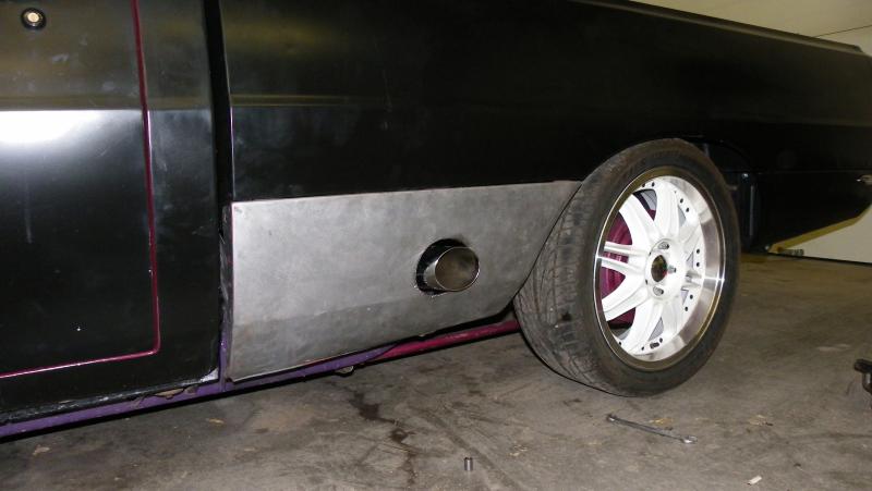

    Started cutting the hole in the lower front box panel's today. Here's a pic of it test fitted.
    Not sure if I'm going to french it in or leave it as is.

    Did you make your own new lower side panel for the bed from scratch? It looks like a new piece. Clever way of routing the exhaust tip anyhow
  19. #219
    Nah just the stock panel all stripped and sanded to do the hole before I do the little body work and E-coat.

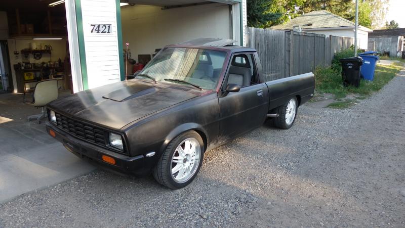

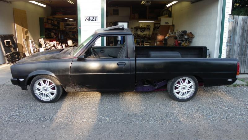

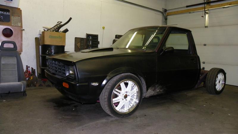

    Here we go..... All back together and running. Now I have to work all the small bugs out of it and get an alignment done.
    Air bags deflated.
