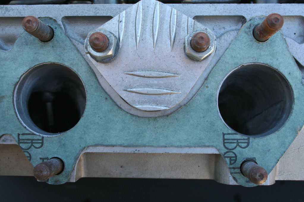

    Seriously these are one of the most basic fabbing jobs you can get into. If you can trace a gasket with a sharpie onto an off cut of alu plate, use a jigsaw, a file and a power drill you can make a half decent block off plate in an hour tops.
    That was made out of scrap checker plate (4G52 head but the same deal in making it)

    that is right - someone that knows about how a weber works - but the plate goes on the head, not the manifold. Take him the fuel pump spacer or gasket and have a plate made to match the outline.
    If it's a first attempt and this stuff is new to you don't give up. You gotta start somewhere (and anyway the first attempt is your prototype telling you where you went wrong so you can make the necessary changes to get it right)

    4G52
    I made my own with a Dremel and a drill
