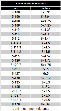

    Bolt Pattern Conversions

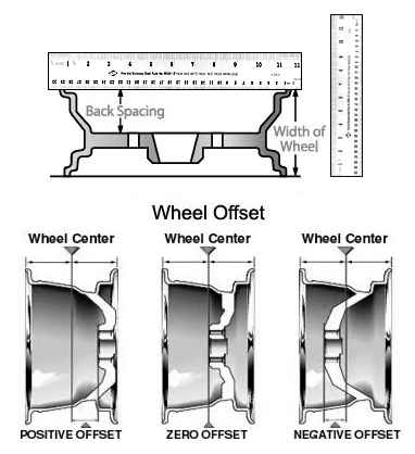

    Offset:
    The distance from the mounting surface of the wheel to the true centerline of the rim. A positive offset means the mounting surface of the wheel is positioned in front of the true centerline of the rim / tire assembly. This in effect brings the tire in to the fender well more. Conversely, a negative offset means the mounting surface of the wheel is behind the true centerline of the rim / tire assembly. This will cause the tire to stick out away from the vehicle.
    H = High Positive or FWD (Front Wheel Drive) typically +45, 40, 35 offsets
    M = Medium Offset or RWD (Rear Wheel Drive) Typically +20 offset
    L = Low Offset or RWD (Rear Wheel Drive) Typically 0 offset

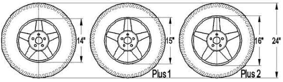

    Wheel Plus Sizing
    Plus sizing your wheel & tire combination was designed to enhance vehicle performance and looks by allowing fitment of larger diameter rims and lower profile tires. The theory is that while making these changes, you keep the overall tire diameter within 3% of the original equipment tires. This is important because larger variances can cause problems with transmission shift points which can decrease fuel mileage. It can also confuse braking system computers which can even lead to brake failure,as well as cause inaccuracies in your speedometer.
    Changing to a wider tire requires reducing the aspect ratio (the second number in the sequence of numbers that describes the tire's size). Since the aspect ratio is a percentage which is used to calculate the height of the tire's sidewall, if follows that if a larger number is used for the width, a smaller number must be substituted if the final result is to remain the same - which is the objective of Plus Sizing.
    Here's the rule of thumb for "plus sizing":
    Plus 0:
    Changing to a wider tire size while using the same diameter wheel.
    Plus 1:
    Increase section width by 10mm
    Decrease aspect ratio by 10 points
    Increase rim diameter by 1 inch
    Plus 2:
    Increase section width by 20mm
    Decrease aspect ratio by 20 points
    Increase rim diameter by 2 inches.
