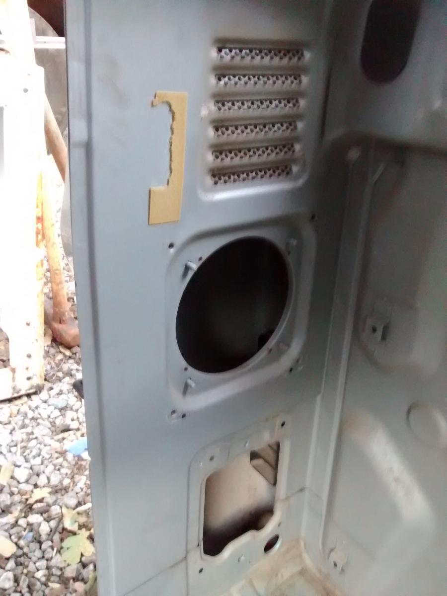

    some second gens had speakers on the panels above the seat belt. this is on an 87 4x4 cab.

    Is mine considered a macro cab? The hole that final fighter is showing is exactly what I'm trying to do. The biggest hole saw bit i could find was 5". I think I'm going to go for it tomorrow.
    Have you removed the seat belt and pillar trim yet? There might already be a cut out in the pillar (more than likely there is - there would probably be a more up spec'd model that ran a 4 channel stereo in it)
    keep in mind that the hole for the speaker would not be 6.5" anyways - the 5" hole with a spacer would work fine.
    Geezer, some trucks came with the hole in the B pillar, so there's really no harm in cutting it open if yours doesn't have the hole, matter of fact there is a perfect indentation for the speaker to be mounted there.
    And you don't need a 6 1/2" hole saw for a 6 1/2" speaker, I think it takes like a 5 or 5 1/4" hole saw since the actual magnet and stuff isn't 6 1/2".

    I agree with you. But there's a service diagram in the factory service manual. What finalfighter posted is legit. I can post the relevant scans of the pages if anyone is curious.
    There's a lot of weird shit on these trucks that I think was done to satisfy Dodge. The optioned out Ram 50s are plenty rare enough, but finding that stuff on a Max is damn near impossible.
