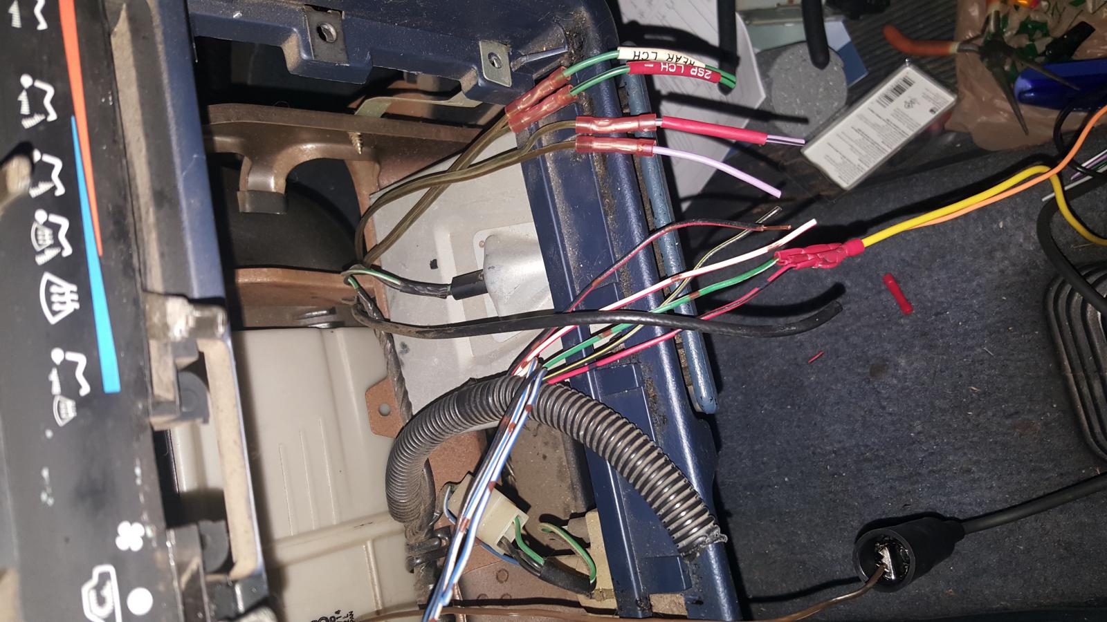

be sure to ground the radio itself, not the grounds of the speaker wires - most HUs are floating speaker outputs. The ground in the radio harness from the old radio is not a true ground - it uses the dimmer knob on the dash to ground the lights.
