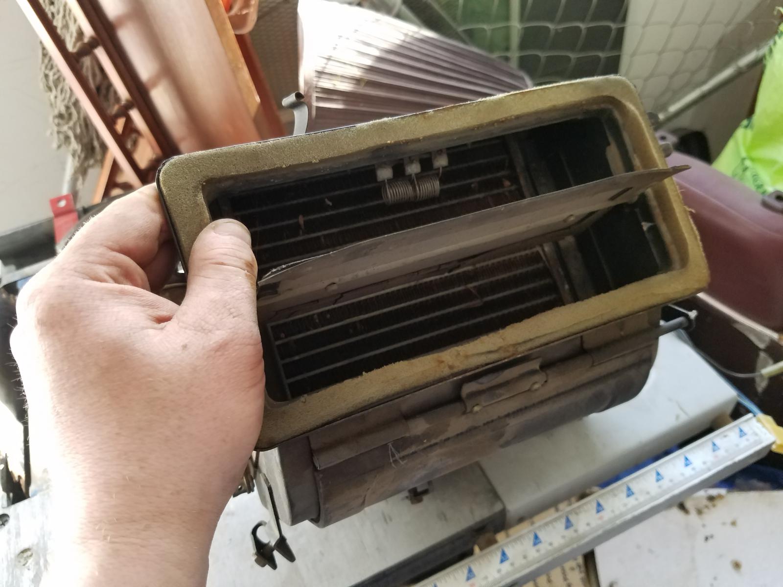

    Well I yanked it today, does this look like the same one? It looks like the core itself is pretty well built in, so I doubt I could replace it with the bmw one I have.. that would be great if it is the same one!
    Kind of an excessive amount of pictures I suppose, but whatever makes it easy to compare.
    The core pipes look different to the one I have. I don't know what advice to offer you on this one as the case appears to be spot welded together. If you got game you can drill the spot welds out, disassemble the case ends and then pop rivet it back together. If the core is toast you haven't lost anything, but this thing would be very simple to recondition if the heater core proves to be in half decent shape.

    Fair enough, no worries. I will get a bunch of fluid running through it and see what comes out. Maybe there is hope yet!
    almost looks like a d-50 / ram 50 1st gen core would work...
    then again, maybe not - it was a thought, thanks for the visual. Maybe a starquest, since it is a car...

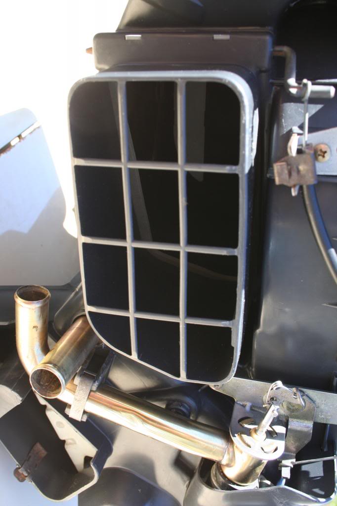

    might be worth checking but this is the top of a 87 and older core
