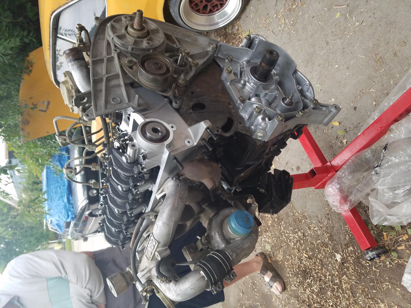

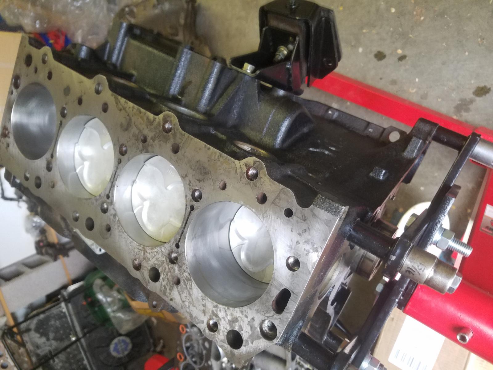

    To start, here is the engine when I started taking pictures. Had it sleeved and boiled. I ended up getting a new assembled head because the one I bought was completely disassembled with pieces missing in a big plastic tote, and one of the rockers was broken in half, and most importantly because I am lazy and found a reasonably priced one.

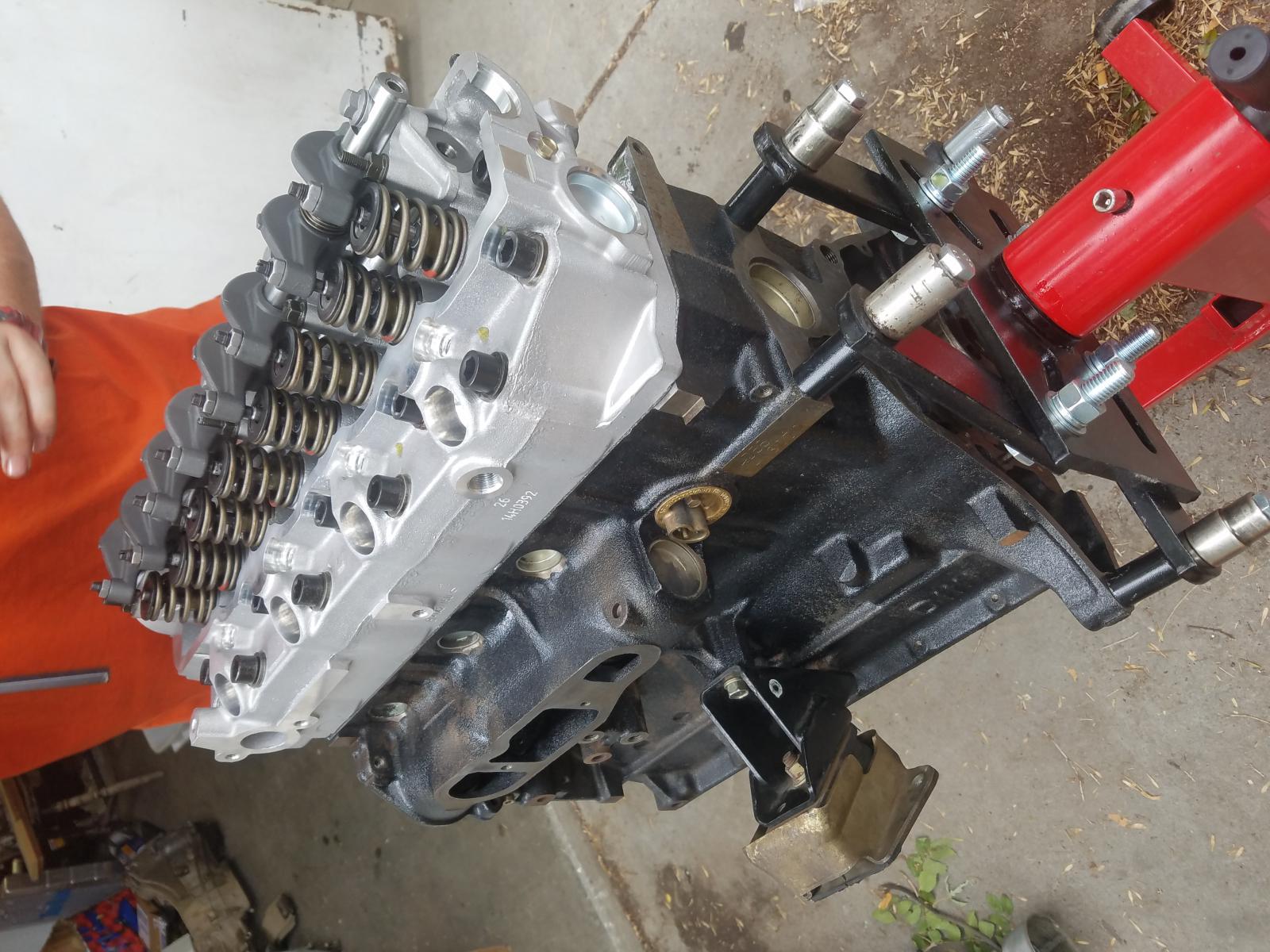

    Some more progress. Starting to look like an engine.
    Of course one step forward, two steps back. Found out there was a giant crack in the exhaust housing, so I managed to find a new turbo for too much money. NOS but has a lot of shaft play.. hopefully it will tighten up when oil gets into it. It tightened up a decent amount with me running oil through it and spinning it with an air nozzle, so I am optimistic.

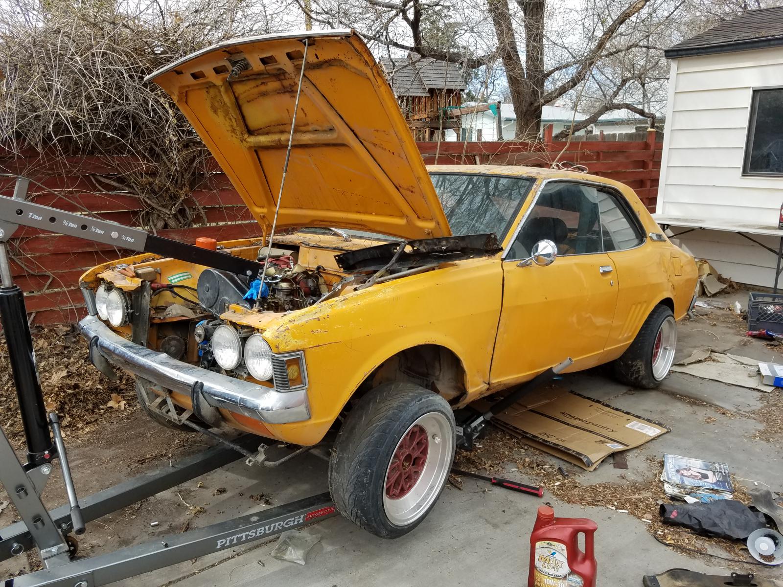

    Just to get an update out there:
    I have the engine bolted in, the turbo is all attached.
    The heater core line is correctly routed (well half of it) just needs a gasket.
    Started installed
    Alternator installed, although I have the colt/4g32 adjuster piece so I may need a slightly smaller belt

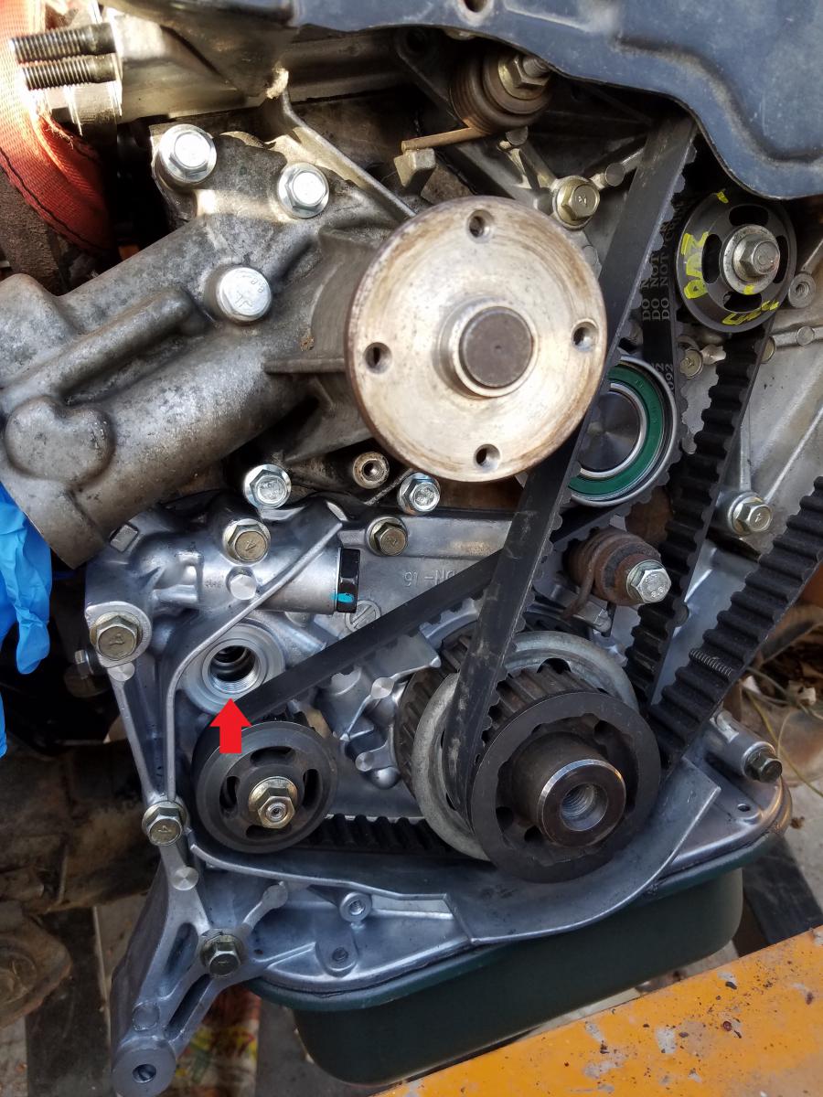

    Looking for the correct plug that goes above the balance shaft (red arrow in pic) I believe it is either 19mm or 20mm
    I have to get the M14 1.5 bolt to attach the pulleys into the crankshaft
    At this point I have decided to remove the clutch slave cylinder entirely and fabricate an adjustable pivot of some kind. I want to use the cable clutch, through the pivot, to actuate the lever that the slave cylinder was interacting with. What a joy.
    Another of my current challenges is that the bellhousing is pretty much touching my metal brake lines. Still brainstorming on ways I can sort out those lines without removing the engine... it was horrific to shoehorn in there, and ideally I don't want a repeat of that endevour. I haven't had a great deal of experience with brake lines, so any input would be appreciated! I will put a picture below to show what I mean.
    After that stuff, I will need to get an oil cooler, which will probably sit externally below the bumper, and a radiator. Toying with the idea of a custom radiator, because paying the price for one might be better than the massive shit show of trying to mount one in the trunk...
    And a fuel cell in the trunk, which should be relatively straightforward.

    No chance you could bend the lower brake lines away from the trans tunnel entrance? I'd be more worried about how close they are to the starter motor housing than the brake lines along the back of the head (but they are damn close). If you undo the brake line retainers and sort of curve them up and over a little, the only thing it will alter will be their appearance. I would test your drivetrain movement with a pry bar - if it rocks back towards the firewall and touches it, that will indicate the engine can move backwards off deceleration. Looks like you really need an extra 1/4" clearance more room.

    Yeah Geezer I was thinking that, just a little worried about bending 45 year old lines. But that was my hopeful option, as it was a real pain to shoehorn in there. I think that is what I will try. Worst that happens is I have to do it the right way, so might as well try bending first and see how it goes.
