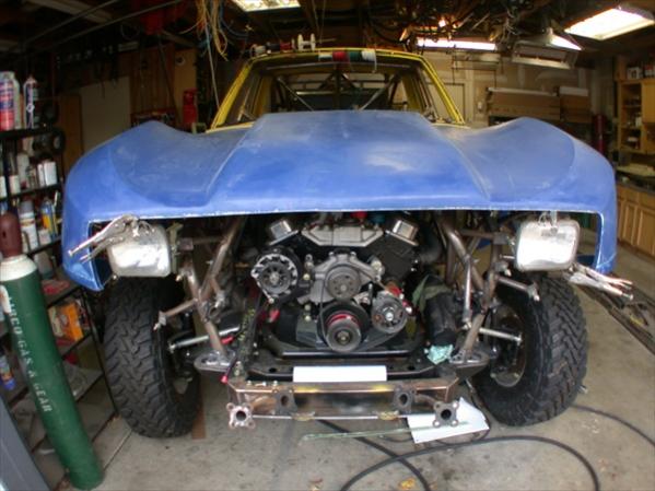

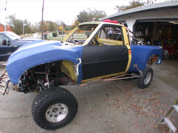

    Rear Bed Sides are cut around the stock wheel well by 2 inches, flared out 5 inches and shortened in the rear by 1 foot. They have plenty of clearance for over sized tires.
    Front hood and fenders. Fenders are now 1/4 the size they were and the hood and flairs widen the front by 14 inches in total. The hood will be a 1 peace, with the 2 quarter fenders.
    These pictures are of the unfinished plugs. I will get the finished pictures up Sunday.

    Here is what the bed sides will look like. This is only the Plug, not the part.
    The actual part will only be a shell of the out side. Nothing on the inside, just a shell totally open with a 1 inch lip added for strength around the wheel opening.
    I will have pictures of the parts soon.

    I noticed the body lines of the original parts were skillfully carried over to work with the look of the new parts. Fantastic work.

    Thank you for the comment. It really means a lot when up against a truck like yours. Mabe we can meat up some day for side by side picts.
    Since she is a D50 with a major over dose of steroids and has been working out in the gym the body has changed. The lines are only in some places and not in others. Like the very rear looses the but crack down the middle but still has the upper radius to show off them sexy hips. While the front end gets Brest implants and a face lift.

    One peace hood weight :26 Lbs.
    Front quarter fenders weight: 2 Lbs each
    Rear bed side weight: 13.5 Lbs each.
    That makes a total of 57 Lbs for all the parts.
    Will add in pictures later on.
    True race parts weight is about 1/2 of what I have. There made for street use. Race parts are known as a splash part. Thats why they just seem to blow up during a race. There designed that way.
