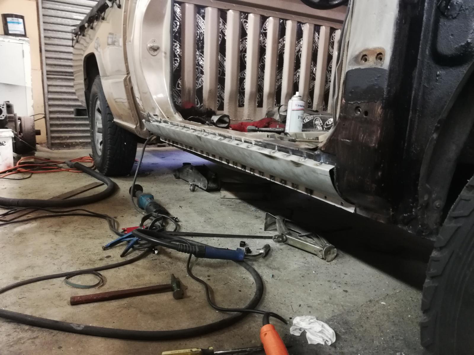

							Part trimmed the sill, filled it full of holes, and burned it into the Ute.
 A little tricky to line it up straight, not real sure where you would measure from expecially when the whole trucks been messed with...
 Anyway. It looked like the inner door frame had been squashed from standing on it, I copied the angle where the seat frame attaches as this seemed unsquashed. Reshaped it all to match and then set the lip height from the outer edge. This mush have been the right thing to do because the lower edge of the sill then matched with the inner sill lip.
 I think I missed the photo, but I painted all inside first as well.
 Another day tickling the rear cab corner into something passable and I can start tidying it up for some paint IMG_20190903_145932.jpg
 Might be the straightest panel on the truck now, so it may stand out haha
