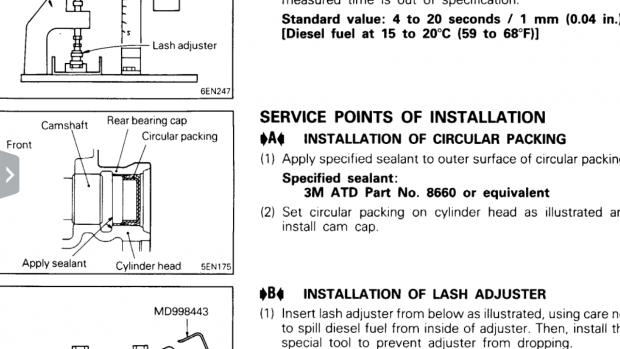

    I have to install a camshaft plug but I don't know the proper direction to place it. The plug is in the shape of a bottle cap, should I place the open end towards the cam? Or the closed end? Hope fully you understand lol I appreciate any advice, thank you!

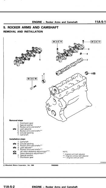

    Ps I looked in the service manual and there is an illustration but its not detailed enough to answer my question.

    Here is the illustration/directions

    So it appears that the cap seal is pressed in with the metal face towards the cam (the inside cavity of the cap)

    I agree, it does appear to have the open end toward the cam. Thank you for your help good sir! I appreciate it! I think I will place it that way if I dont get a definitive response from someone who has done this before.
