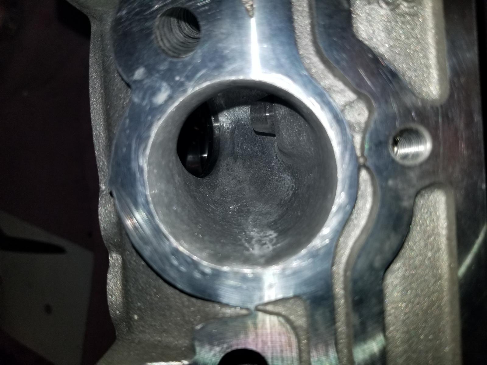

    20180506_211632.jpg20180506_211610.jpg20180506_211319.jpg20180506_211322.jpg This just a few pics of what i got done so far. Im basically rounding down any sharp corners, trying to make the alu around the steel seat meet the runner walls as flush as possible(kinda hard to explain what i mean with that) getting rid of all the rought casting lines and high marks. 80 grit in intake 120 in exhaust tring to focus a some on the short radious spot and tried to keep a spiral effect in the intake as well. went ahead and started polishing the chamber as well. Why not?

    Nice work Get yer finger in there and probe around for high spots and undulations - you'll feel them before you see them. Not easy working the valve bowls is it? I made a tool to lap the walls in the galleries from a broken screwdriver shaft. I cut off the tip, chipped off the remaining bit of the broken handle and then cut a slot into the cut off end. I wedged some folded up sandpaper in there and locked it up in my power drill chuck. I managed to get a very nice uniformed finish out of it.

    Awesome man thanks! Lol na not even remotely easy but it's ok. I'm just hoping all the effort is gonna pay off the way I'm expecting. I think I have an old tire plugging tool somewhere I might try that seems to be the same basic idea

    Don't expect real gains in torque or HP without other mods to back it up, but it should run nice and smooth on and off idle and have good throttle response (you gotta do your intake manifold yet!) You'll probably go back over it one or maybe 2 more times before you deem it 'finished'. I put about 40 hours into my head and all the mods on my intake (including preparing it for repairs as the coolant plenum rotted out from underneath which was a common thing to happen to G63B manifolds) and even now I could rework a few minor places I'm not 100% happy with. OCD much?
