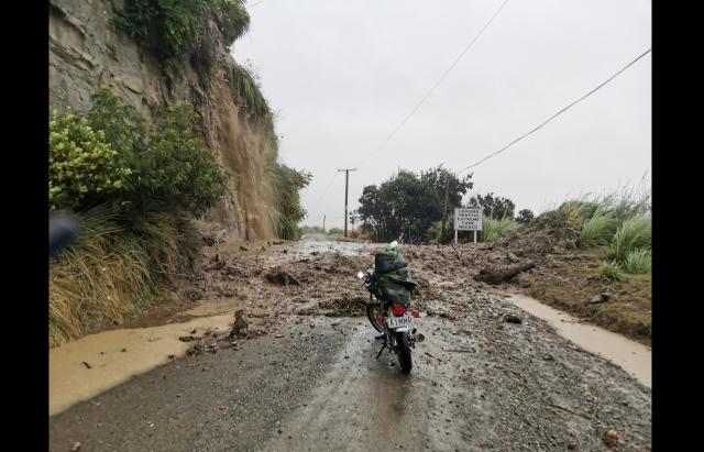

    Through the gorge there is always cold and wet. The local tribe is called Tuhoe which means Children of the mist. It must have been real hard country in the old days. My dad spent alot of time fur trapping up in there, 3 months at a time long before cell phones or plb's, if the helicopter couldn't come it would be a few days hike out

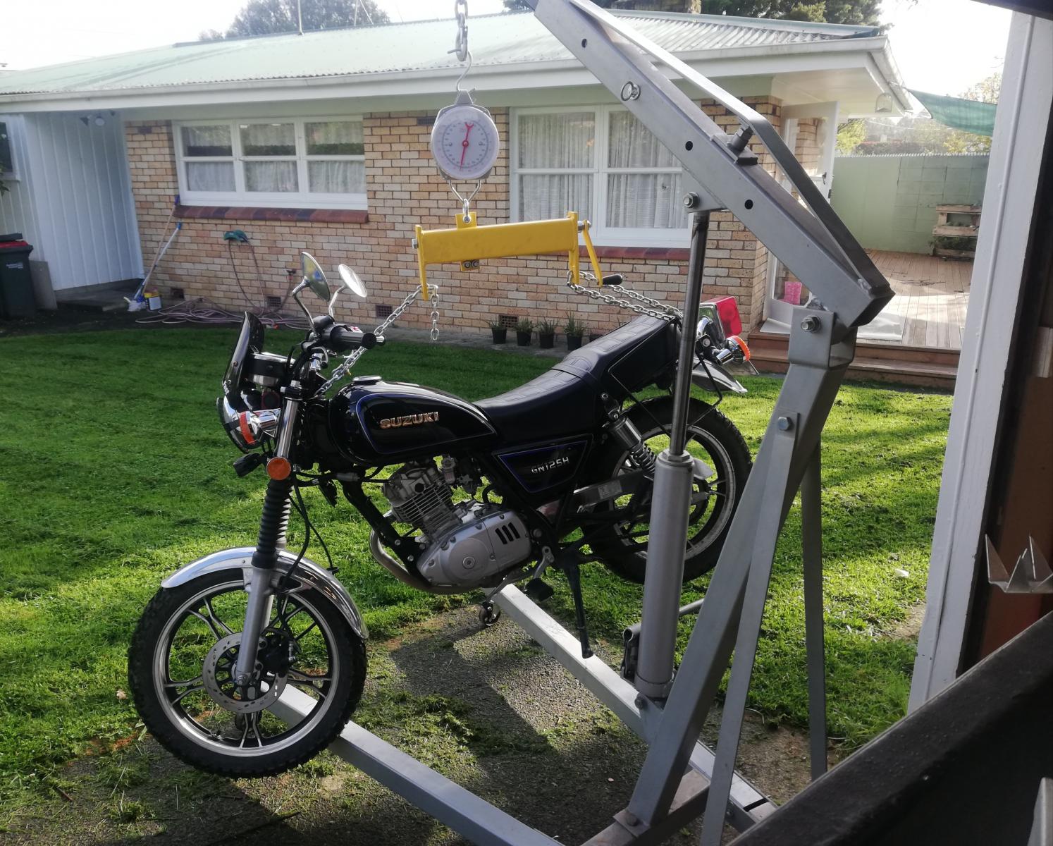

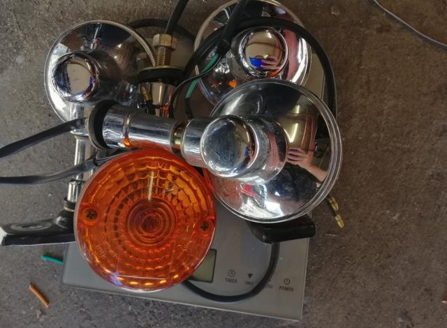

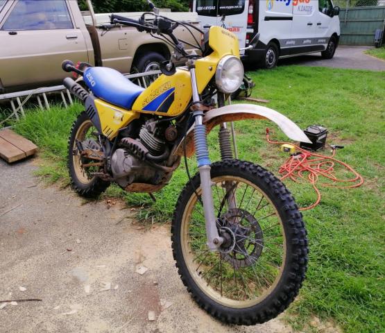

    Pretty windy coming back from the east coast the other day. Had me knocking right back down the gears in headwinds and I said nah that's not cool.
    When I got home I ordered a 150cc big block kit. It only cost $80 nzd so pretty cheap for a barrel, piston, rings and gaskets etc, even came with some viton valve seals. I weighed the bike
    And myself and went and did some Gtech runs. The data graphs weren't very good but showed the ticket 11ho is about right.
    Then when I got home I swapped in the 150 kit and took it for a warm up run.
    Seems to have a bit more in the middle, same top speed as expected but I can probably gear it up a bit now. Pulled the plug after a wot run and it's a nice light brown. Will get home now plugs tomorrow and do some further testing.

    Talk about inexpensive parts! I'm scared to know what that thing weighs, because I'm almost certain I weigh more

    The cops will never pick up on the increase of cc's but it probably doesn't matter. Did it come with a rejet kit and spacer?

    Increase in cc would be picked up at WOF check if they were pedantic.
    New quality rings installed. They looked better than the previous ones. I goofed a little when I checked what jetting an en150 has +same carb #115 main jet. I was sure the GN took a 115 jet as well, but it turns out it's a 110 so must have gone lean on the big hill as well.
    Put it all together yesterday again and put in a #120 (baggie of jets I bought forgot to put the #115 in. Typical)
    Have a wideband welded into the exhaust. Running rich on WOT. So will scrounge up a #115 and she how we go

    Scrounged up a #115 main jet and went for a tootle around the back roads.
    It's on the rich side of a good tune right though the range so maybe a 112.5 if there is such a thing. So I'm thinking it must have only jjjjuuuuussssttt leaned out at WOT. Will keep the jets in my pocket and the wideband in the bike for a while and see how she goes. Pretty warm today so may be a good tune outside of summer

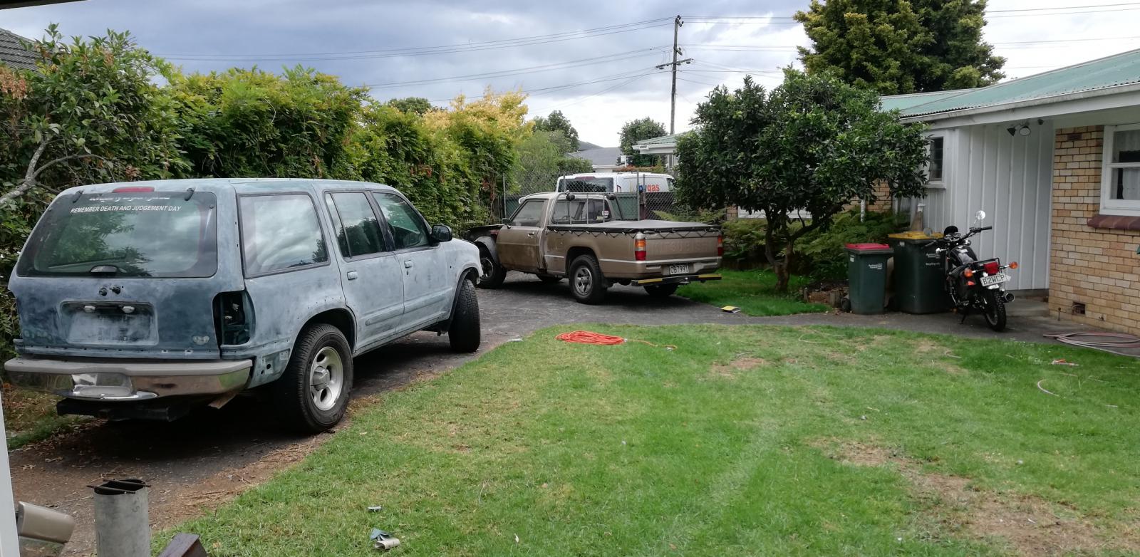

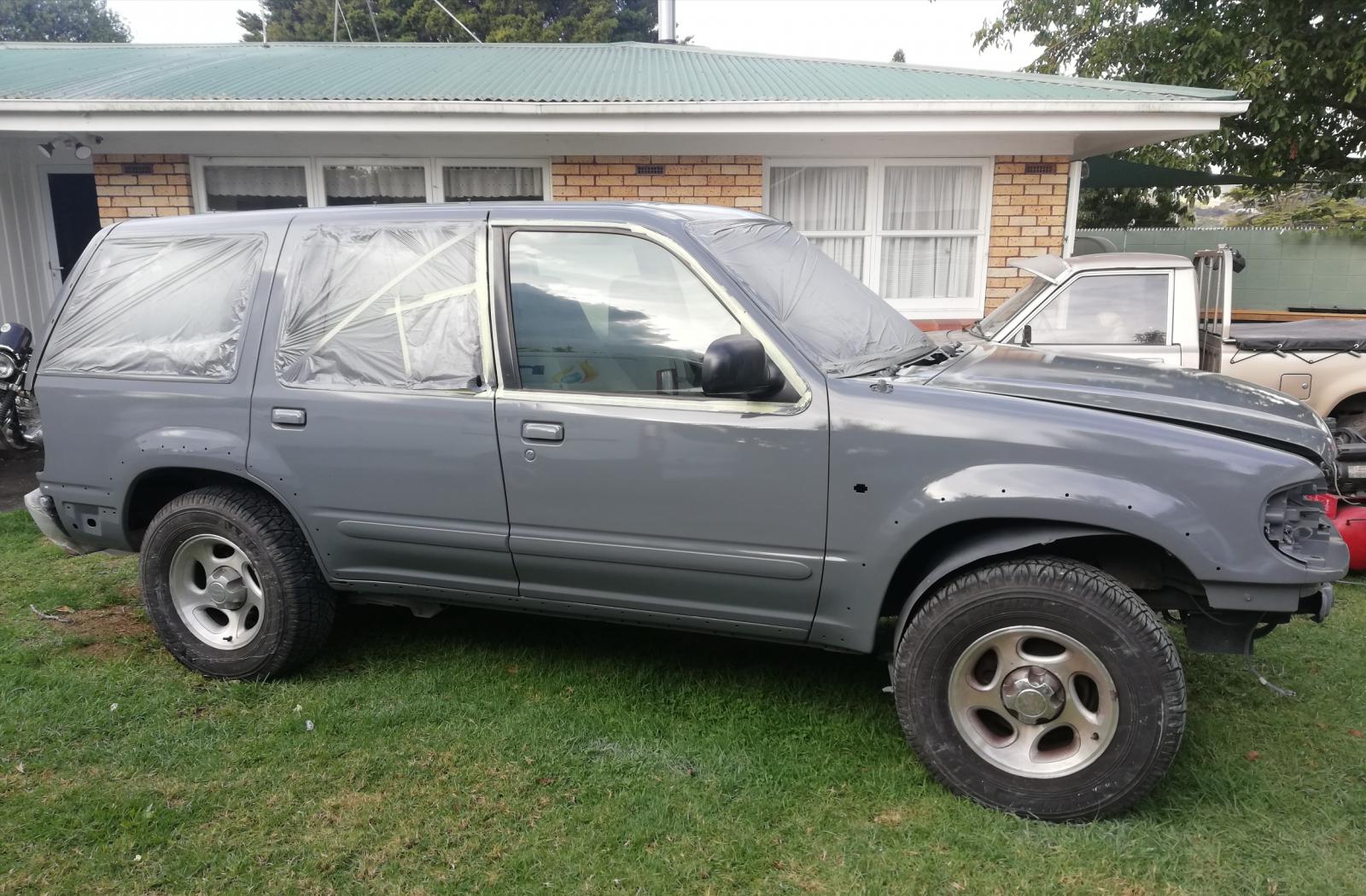

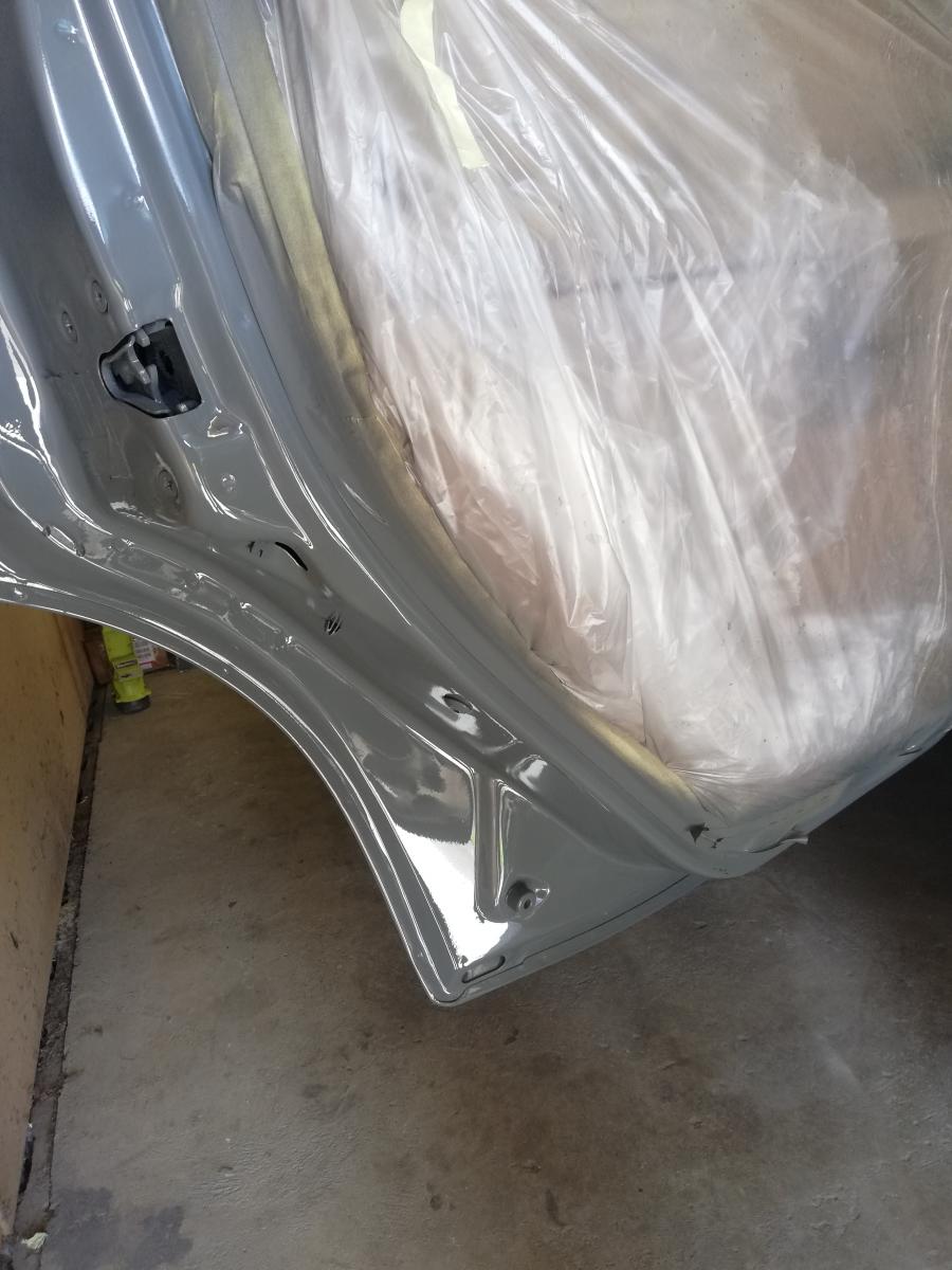

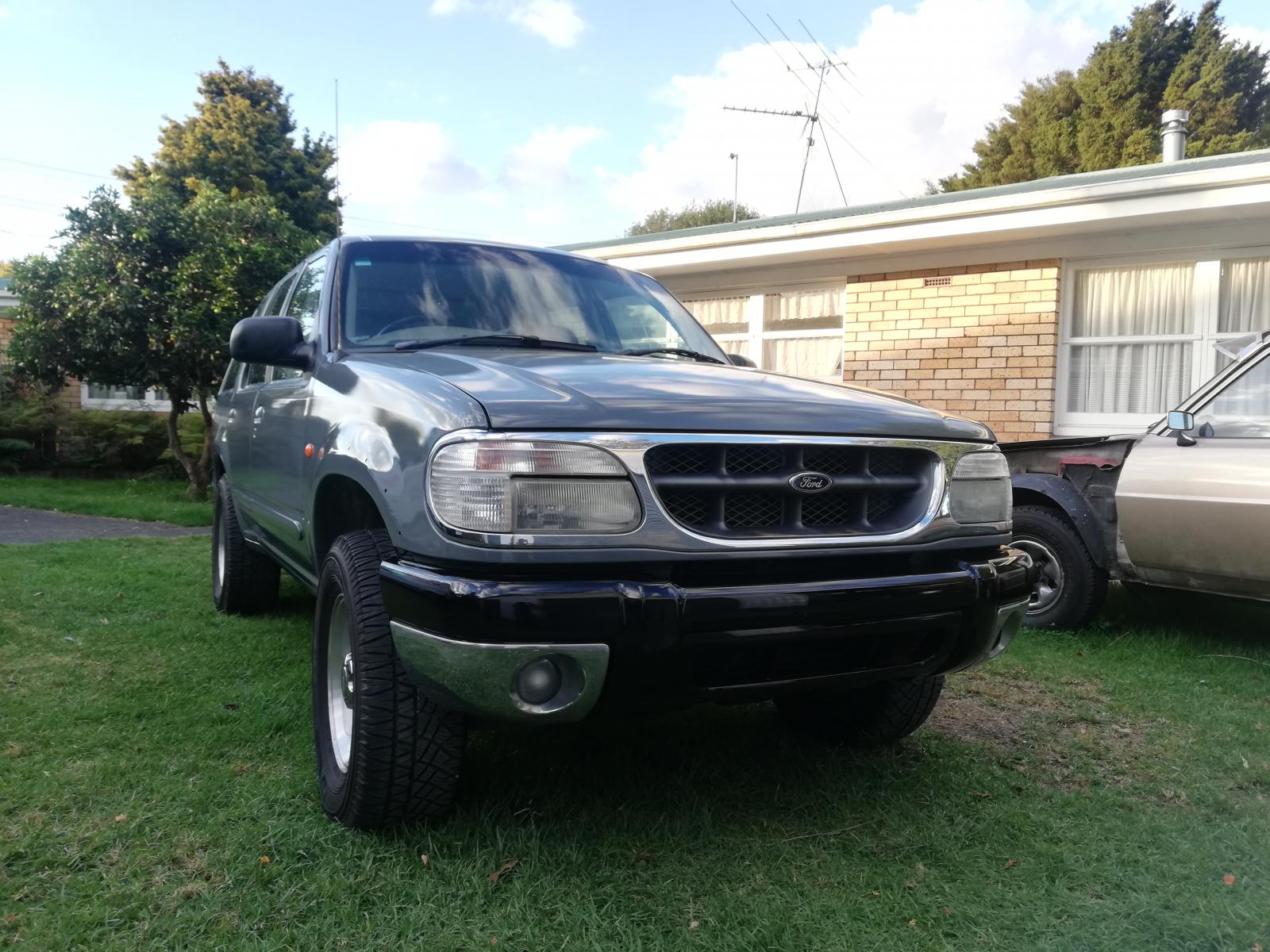

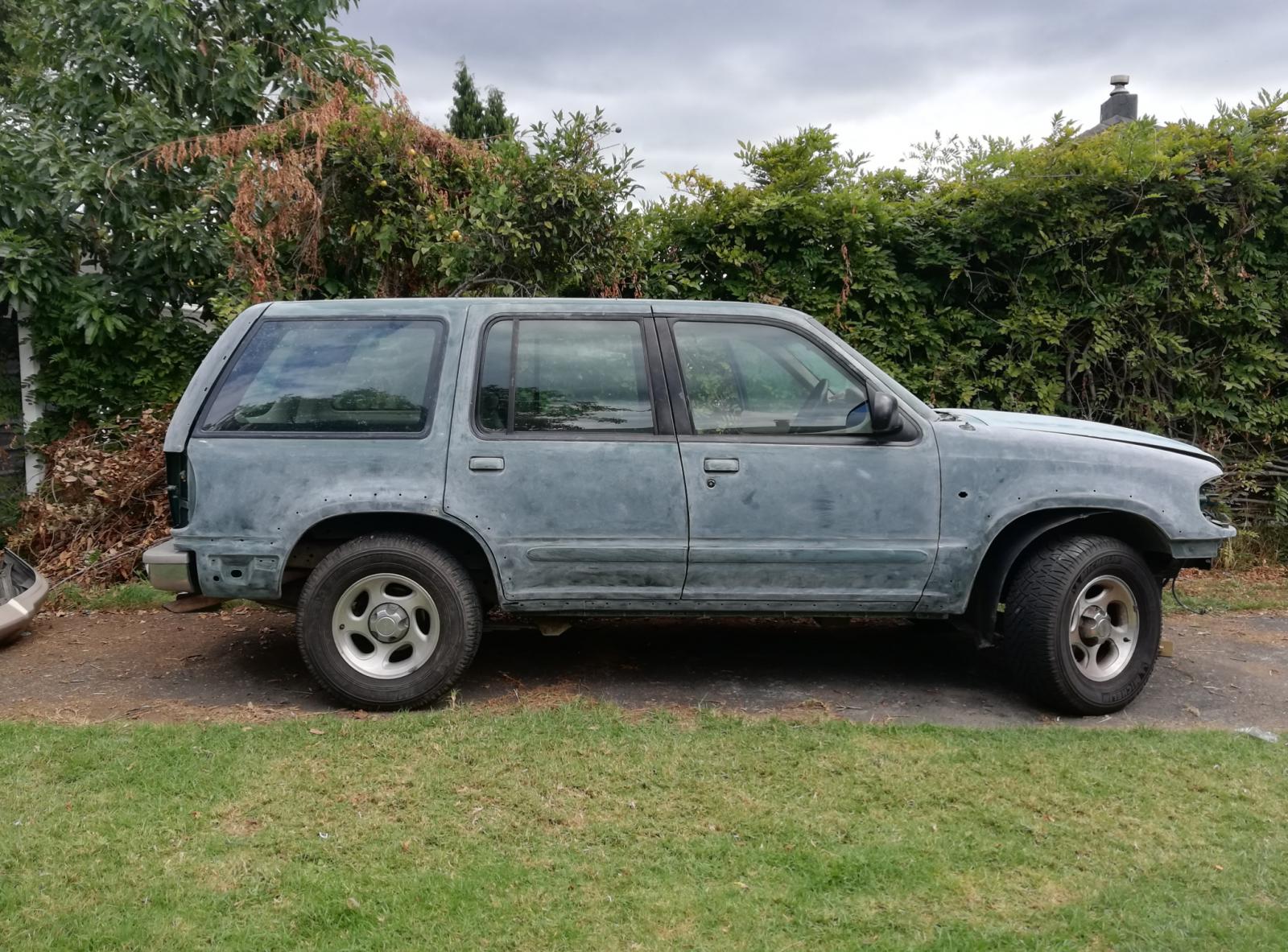

    Been fixing this thing upfor our tenant (so I don't have a p.o.s on my lawn haha)
    2000 ford explorer. Given to him for free.
    No pics before work I think, but it's all there
    Was rusty
    Made it not rusty
    Got a replacement headliner from the wreckers as original was shredded

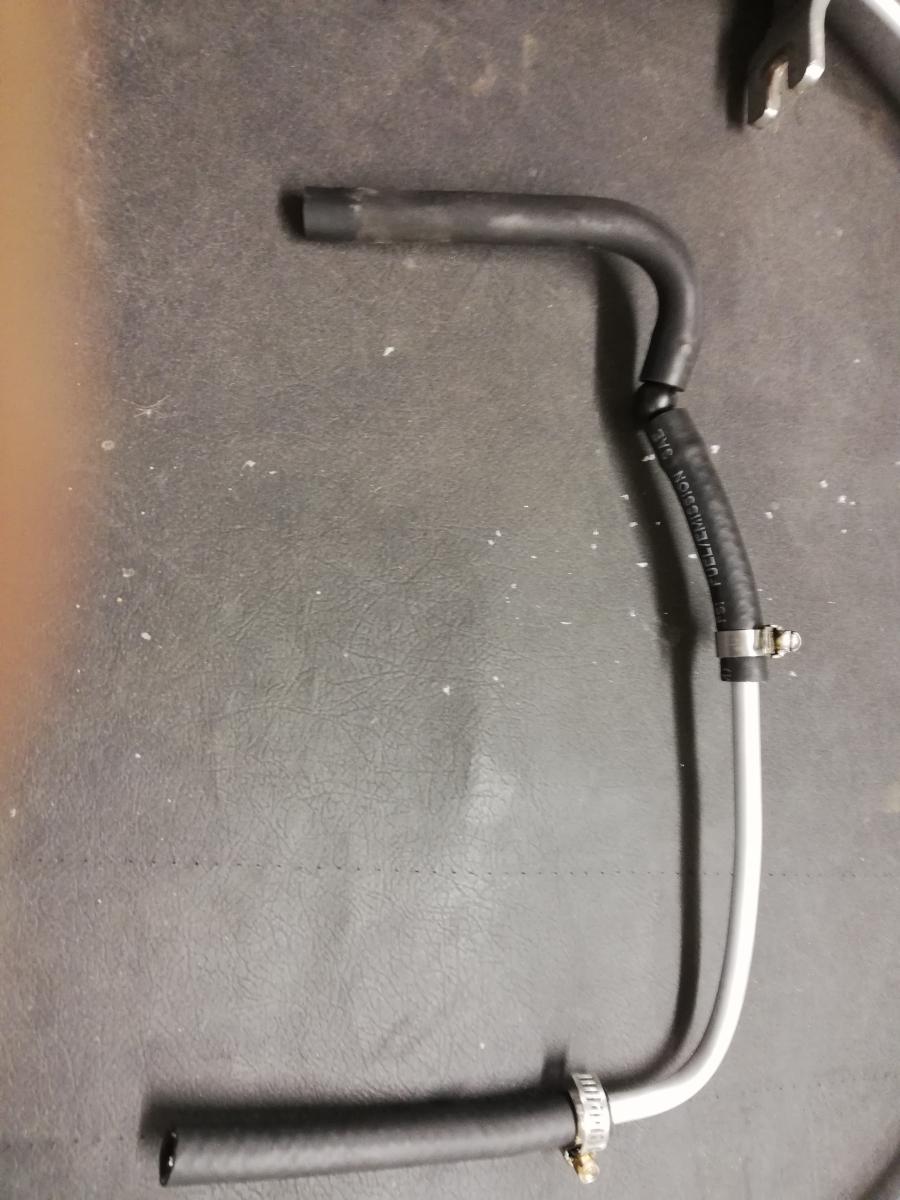

    It ran wierd in the drive there, and it had a engine light on.
    Intake vac line was split bad, so made a new one from bits in the garage
    Runs nice now, just needs a new temp sensor for the gauge.

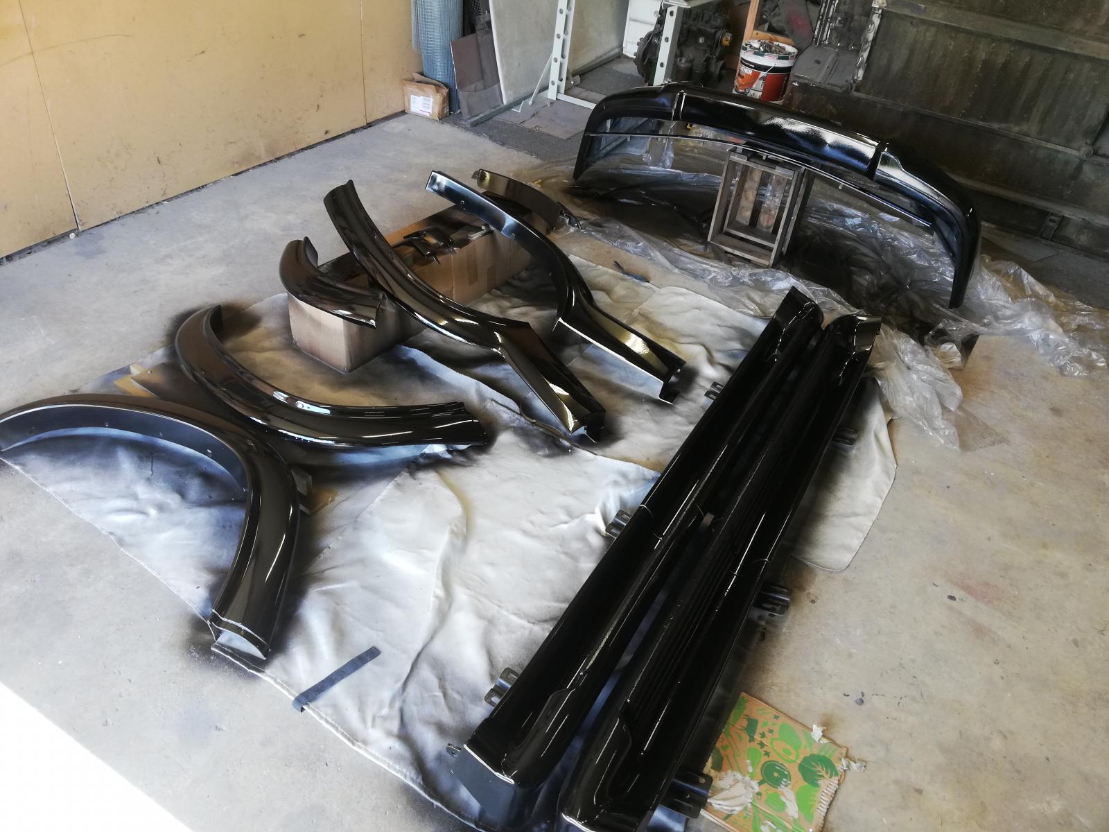

    Stripped it down and scuffed it up
    Lucky I ordered all the stuff needed before we got locked down. My south Auckland chop shop has it on lock
    Did the doors a couple days ago. Quite like this colour. It's Audi nardo grey.
    Base and clear done today. Not too bad. Can work on my clear orange peel, by the time I'd finished I had it down pretty well with the new gun and compressor

    The grey is kinda growing on me. When I first saw it on an Audi I thought, "it's a bit bland..." but it's clean and subtle. I'd consider respraying the beige chalk board in it TBH

    i quite like the subtle pastels. greys, browns, snifter greens. they look nice and clean, i probably wont change the colour of my truck from gold tho

    Nice job dude The cancer in the roof is scary but it's no worse than what is growing around the roof racks on my Hung Dog. Don't know if it's worth getting it patched and painted...

    if you are paying a shop to do it, its probably not going to be cheap. Alright for me with a welder etc and some free time
    same as fixing any old car i guess

    Interesting. The Ranger is a pickup in the states. That is the SUV based off of that platform, that we call the Explorer. In the 60's/70's, the Ranger and Explorer were trim packages for the F series pickups.
    Looks good!

    Woops yes it's an explorer. It autocorrected I think after looking for cheap factory ranger wheels. They all get taken off and 20s fitted

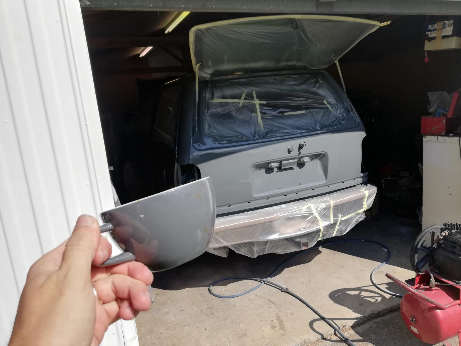

    Can't get any paint as it's non essential. Some durepox primer and some clear came out pretty good
    Came out pretty good considering the what I would call minimal prep. If it was mine I'd have done another coat of primer and another couple days of sanding, but tenant would rather drive it than sand so that's fine, don't want it looking too good, it's just a 2001 ford eh
    Need some more trim clips as I cut them off rather than spend time fiddling to get them out. Cheaper to replace than waste my time
  21. #46
    Pretty good - I wouldn't have a problem with a finish like that
  22. #47
    1,218
    Theres some dust here and there and a couple of runs in the clear where i ran out of room in the garage to swing my arm. Can correct that once the paint has some time to harden up no problem. I notice every little mark though, if it was my truck id have spent the extra time on it.
    does look good if you dont know where to look ahhaa

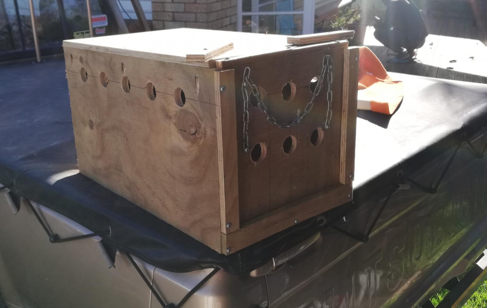

    Made up some transport boxes so I can get them out of here. Haha
