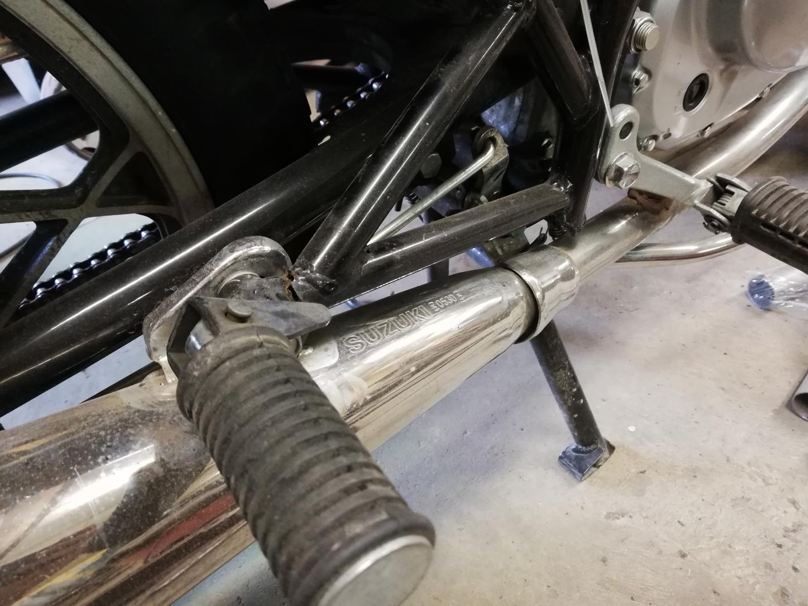

Noticed my pillion peg/muffler has fallen off
Could weld it on in about 5mins but I wanna see what Suzuki wants to do under warranty. It's not even a year old and the welds are falling off? Not good
Bummer, where is the broken part?
The boss that the pillion peg and muffler bolts through has broken away from the small frame triangle
That's not good. I know that they break frame mounts for the engines on MX bikes but that peg and exhaust mount are hardly under any real stress. The fact that the pillion peg rubber has literally zero signs of wear on it would indicate this hasn't failed from abuse.
Yeah. I used to do jumps on my Japanese built gn250 and had no issues with it. This is just trash quality. My wife has sat on it a couple times, she's pretty tiny. I don't even think the muffler would vibrate to fatigue it. It just... Fell off...
Appalling for the cheapest new bike on the NZ market! Haha. Got in touch with the dealer tonight so hopefully hear back next week. warranty still has 2 months on it, but CGA would cover this regardless.
Just curious if they will just weld it back on and ignore that the other welds are potentially like this, of if it means a new bike/frame
Problem with welding bike frames is it makes them even more brittle. It would probably need to be TIG'd. I don't ever remember having a bike frame fail/warranty when I was assembling them for a dealership. It's rare. If it was a bad Chinese knock off I'd expect there to be all kinds of build quality issues, but there are obscure forums out there that help guys debug them and make them into half reliable machines...

^really? Suzuki needs a smack over the knuckles. I know the GN is a dinosaur but this is still a road registered bike (and a new one too) I'd weld the b@stard myself at that rateAnd China does know how to weld. Did Suzuki farm the frame assembly out to the guys that made K-Marts' kids bikes...

I'll see what Suzuki wants to do under warranty
Get them to fix it under warranty MIG 'n accept only an original joint design & weld... Later, you could add your own gusset use MIG![]()
Oxy-Acetylene is still widely used for chromoly tubing frames in aviation and motorsports. I doubt this is chromoly, but The extra heat put into the tubing by torch welding allows it to cool more slowly and anneal the weld. you can also use dead soft filler rods. Lots of weld failures in high vibration environments occur because the weld has 2-3 times the tensile strength of the base metal. This creates a stress riser where the edge of the weld meets the base metal (typically where you see failure)

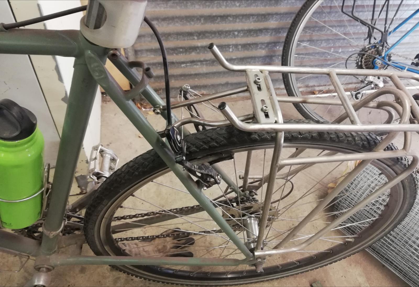

My touring bike is all hand brazed. It's done a lot of hard miles. I did some work on it the last few days
I have some pretty nice stainless steel racks on it, 30 year guarantee outta Germany. But the stays are aluminium and I snapped one of the eyelets, it hot bent around a bit in my travels. I don't like the one size fits all set up, so I made my own
Stainless steel capillary tube and flat stock. Part of making new ones was that I switched my brake set up to V brakes and I now use two sets of brake levers on the bars, so I have to use a ratio corrector at the brake end.
The kink is to clear that
Came out very nice. I used sil flow 55% silver brazing rod
Got a few other small jobs on it, a few repairs on old parts. Replacing stripped out threads in the derailleur, I stripped them out in the Atacama desert and Rand a nut and bolt through it, which means it has to be set in the perfect position otherwise you don't get all the gears, and I stripped that bolt last week haha. New shift levers to some that have a built in tag to adjust the, current ones I have to stop and find a coil every 600km. Fixed my bell mount. It was peened over on a spacer, that got torn out on a plane and re peened and then return out on the flight home.... I remade that with some titanium tube and bolt.
Did some more work to the wife's bike too. Lower granny gear on the crank, have a good sealed bearing bottom bracket to swap out the cartridge style one with and I have some cantilever brake posts to braze on. It was 27" now running 700c tyres and so I'm using some long reach rim brakes from the late 70s on it. They work, but don't look good. And my old canti set up will be much better
My frame is a 79 shogun 500. It was built from factory as a touring bike. It had some ok bits on it, but I sold most of that off and fully rebuilt it. The frame, cranks and seat post are original. I build my own wheels for them. Mine has tens of thousands of kilometres on it now, u have rebuilt it a couple of times to
