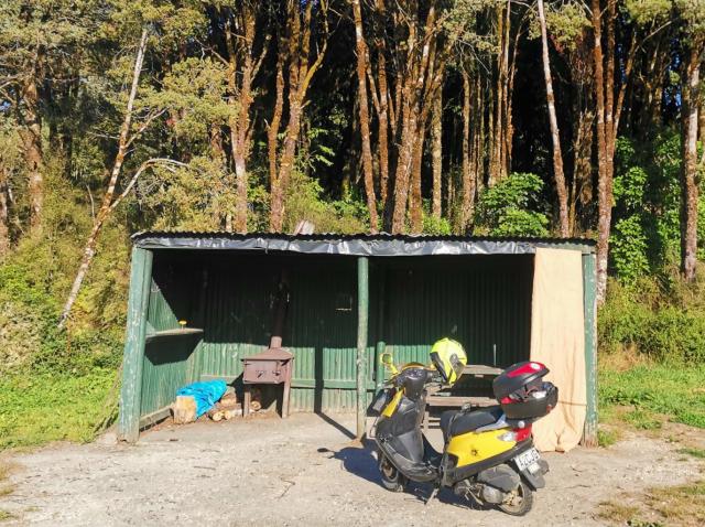

    125cc suzuki twist and go i bought a while ago with no compression and no oil in it. piston, rings and a dingleball hone and i took it on a 10 day trip down to the top of the south island, and all over the 4wd tracks that adventure bikers tell me are so hard. Twist and go just twist and went, totally stock apart from a more knobbly front tyre (nothing would fit on the rear so thats just a road tyre), a 12v usb port, and a front rack for extra fuel
    went really well, amazed, it only has 12cm of ground clearance and it was never an issue
    had a couple of issues
    the fan exploded for some reason. i was only just cruising along when it happend, so must have been damaged, or just old i guess. made some roadisde repairs and continued on with a vibrating bike.
    eventually the seal on that side started leaking, probably the bearings are fine. But i bought another parts bike incase it makes bad sounds now. the baffles in the exhaust all came loose, and both the petcock and the press in float needle valve started leaking, so i swapped the carb and got a new petcock
    now to sell - one lady owner, never thrashed

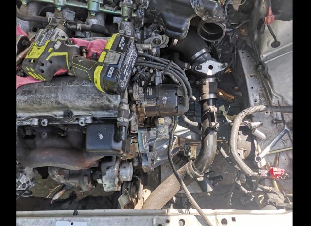

    Here's an Sr20de +t in my wingroad, all factory parts so its all bolt in, you just have to do some deep diving
    Needs a little more time spent on it, engine to come out and get new gaskets, and a few little bits. Weather has generally been terrible for months so haven't had a chance to do much

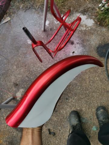

    Who painted the trike bike ~ it's pretty now !!
  14. #189
    1,218
    Nope, not audi either.
    I painted it. Candy apple red over silver flake and the white is snowflake pearl. The lettering is gold leaf too
