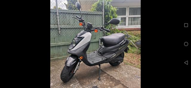

    Little red zip scooter out the door
    paid $100 for it
    new front tyre
    patched the rear
    new headlight bulb
    new brake bulb
    oil change
    clean air filter
    polish
    reblack plastics
    Tidy profit
    sold to 2 ladies who want to be scooter buddies. I thought the one riding it home was the one that could ride. She pretty much right away whisky throttled it into the fence, stopping just short. Is now wobbling down the road in the dark. Terrifying tbh
    at least the car will be following and its light traffic
