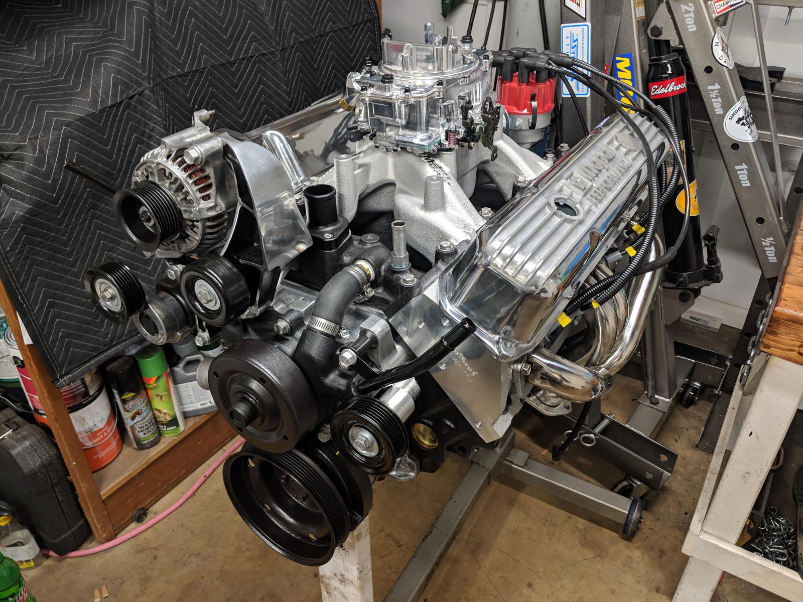

    A little about the engine, It's a 5.9 magnum out of a '98 truck. It has a balanced bottom end, flat top standard bore pistons. Fairly large street/strip cam from Hughes, aluminum heads running 10.7 to 1 compression. On paper it should produce 450hp/450torque. If anyone wants more specs I can provide more details.
    Trans is built 904 with 3500 stall.
    As I mentioned before, I decided to keep the Magnum components on the front of the engine, mainly because of the shorter water pump. Originally I wanted to do a LA conversion, but this set up gives me that extra room and saved a few dollars as I bought a complete engine.
    I did modified the serpintine belt configuration as I deleted the A/C and power steering from the donor. I couldn't find any delete kits online so here is what I came up with.
    First thing I did and for those who know the magnums was to cut the huge accessory bracket in half and get rid of the a/c mount. I used a sawzall and leveled it off with some heavy grit sandpaper. After running down to finer grits the final polishing of the aluminum was done with a headlight restoration kit.
    I had to add an additional idler pulley to get sufficient surface area on the water pump pulley. The mount comes from 03 to 07 Ford f-350, but needs to be machined down 10mm. I picked mine up off eBay (Continental Elite 500008).
    I also had to down size the stock idler and used an ACDelco 38006 to make room for the belt circling back. By mistake I ordered 6 rib idler pullies and just went ahead and used them. The OEM belt is 7 rib. The belt that worked for me was a Bando 6PK1765

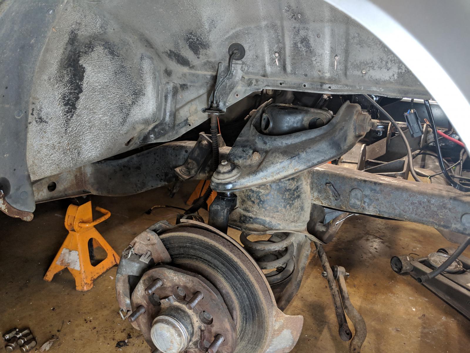

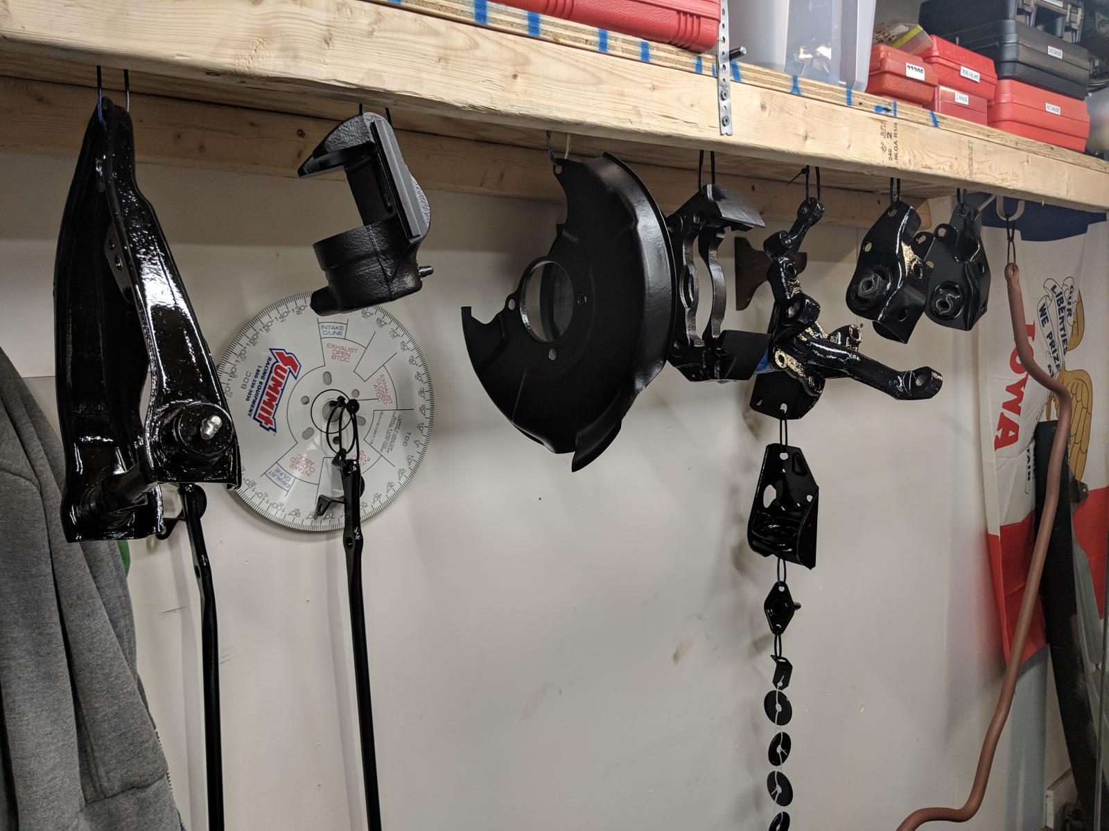

    Not much to update on the build. I pulled the engine to finish up welding the motor mounts and radiator support. I then decided to start rebuilding the front suspension so when I drop the engine back in I can get a feel for ride height. Im just about ready to reassemble the left side. Something I was taught back when I sixteen on doing drum brakes always do one side at a time so you can use the other for reference. This is how I've taken the approach here. I have the service manual and my 84 mighty max also, but it's much simpler to just glance at the other side of the truck if I'm questioning fitment.
    All bushing, joints and tie rods are being replaced with Moog components, always had good luck with them. I wanted to stay with rubber bushings up front to keep decent ride quality, the rear will be energy suspension in hopes of controlling wheel hop amongst other things.
    I am replacing the stock coil springs with Moog's heavy duty 2278s they have one more additional coil and the coil diameter is around 1/16 larger. Spring height and diameter look to be the exact same. My stock coils have had a 1/2 coil removed but, here's a picture for comparison, they arrived black and I added some blue paint.
    I will be changing thing up down the road with drop spindles and gen 2 brakes. Does anyone know if the upper control arms from gen 1 and 2 are interchangeable? I like the idea of having rubber bushing in the upper control arm. So, as things are now this is what it looks like.
    AFAIK the geometry of the Gen 2 control arms are identical to Gen 1's as you can swap steering hubs and brake assemblies without screwing anything up. The UCA pivot shafts may be different in design but that's about it (there are different part numbers and some members have run into a situation where they've bought them and they didn't fit)
