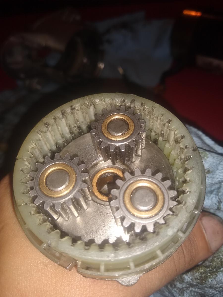

    Starter gear drive went out yesterday.
    Yay.
  2. #252
    Oh sh*t. Looks like the nylon split from age. First time I've seen one do that. Well, there's another thing that you won't need to mess with for a long time once you've replaced it

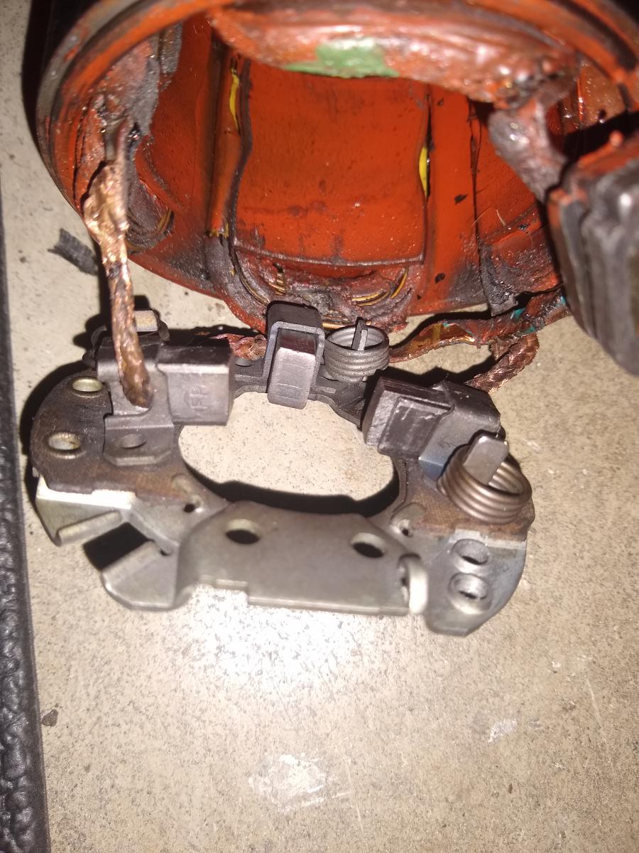

    Found the issue...
    Reman starter was junk right out of the box, one of the brushes were cracked and split in half.
    I'm going to grab a starter or two or three from the junkyard, along with a couple distributors.
    Gotta love when things just keep breaking...

    With the amount I found wrong with that starter, I'm never getting an ACDelco reman again.
    Both mounting holes had helicoils in them, the solenoid had issues, and the insulation for the windings was falling apart and flaking off. But the motor and the gear drive both look damn bear perfect, so I'll keep that and the other parts from the old starter...
    I'm planning on putting together as many good, working starters as I can from the two I have and whatever I can get from the junkyard, and hopefully I'll have two working starters by the end of this. One in the truck, and another in the tool box in case I have issues later on.

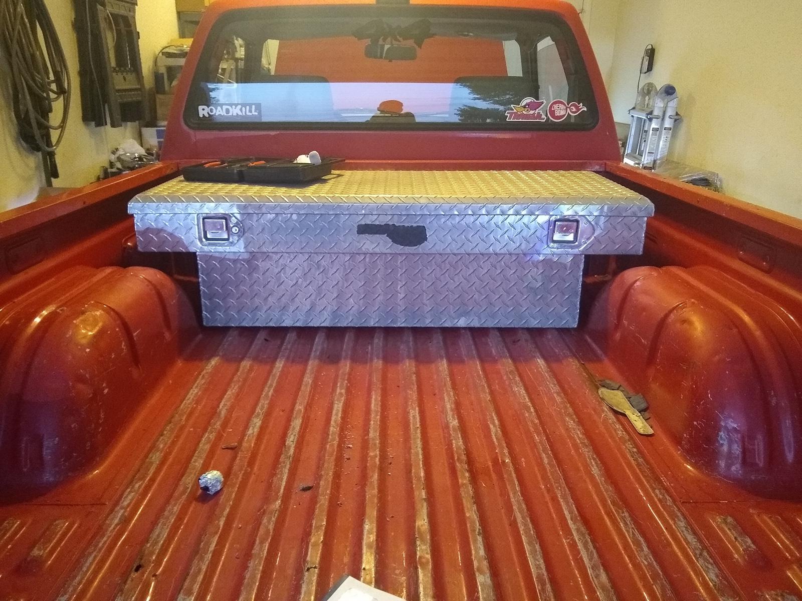

    A small update on the truck, I got the bed box from my coworker finally, it was payment for helping him get his truck onto post and doing a little work on his truck.
    I bolted it directly to the bed, because I'm not going to be building a roll bar or brackets for it any time soon. I did realize that with it sitting under the sides of the bed it's less visibly obvious, so there's less chance of someone trying to break into it or steal it.
